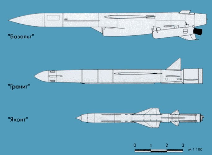

It is still possible to house 3 Oniks in a Granit launcher , so I wonder if it would be possible to do the same with Slava class missile launchers.
Not a Slava, but they're supposed to be doing it to Petr Veliky in his refit. I would imagine it's possible for the box-launchers on the Slavas but we might not see the three for one swap.
Orel was repaired and got some minor modernization. It was never modernized to 949AM standard involving the weapons system swap.
Which would explain that, same as Tver got a refit but not to 949AM. I think that reduces 949AM to just Irkutsk and Chelyabinsk, then.
That’s weird. Why wouldn’t it get an upgrade for the latest weapons? Granit seems unnecessarily large in this day and age; I can’t imagine retaining any tubes for that purpose when there’s already a half dozen Oscars that don’t have an upgrade.
Mainly because while it's large, it's still one of the deadliest anti-ship missiles in the world, far beyond anything anyone else have.
Slava-class cruiser did not have P-700 Granits; they initially carry P-500 Bazalt, and now P-1000 Vulkan. Those missiles, while similar in capabilities to Granit, are not compatible.
(P-500 Bazalt was developed as successor of P-35 Progress cruise missile, for the same launchers. P-700 Granit was developed initially as submarine-launched weapon. Since P-700 Granit was more advanced than P-500 Bazalt, it was also adopted for the large surface combatants)
