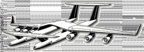

The M-90 resembles another proposed Russian leavy lifter, the M-1000 Gerakl (Hercules) designed by Gleb Lozino-Lozinskiy at NPO Molniya in 1995-96. The Gerakl was also twin-fuselage aircraft, but with six extra-powerful turbofans (400 kN each). It was similar to An-225 Mriya in dimensions, but could carry 1.5x larger payload - up to 450 tons. For example, it could be a passenger module for 1200 seats, or some bulky cargo with maximum dimensions 60 x 11 x 9.4 m. Also the Gerakl could be used for launching some space systems such as MAKS-OS.
Wingspan - 90.4 m
Length - 73.4 m
Height - 17.5 m
Crew - 4
Maximum takeoff weight - 900 000 kg
Maximum payload - 450 000 kg
Maximum fuel capacity - 358 tons
Cruise speed - 840 km/h
Flight range: 8300 to 11 400 km (with maximum fuel), 2300 to 3100 km (with maximum payload), 18 000 km (ferry range)
Takeoff run - 2350 m
Landing run - 1000 m
Source: http://www.testpilot.ru/russia/molniya/1000/geracl.htm

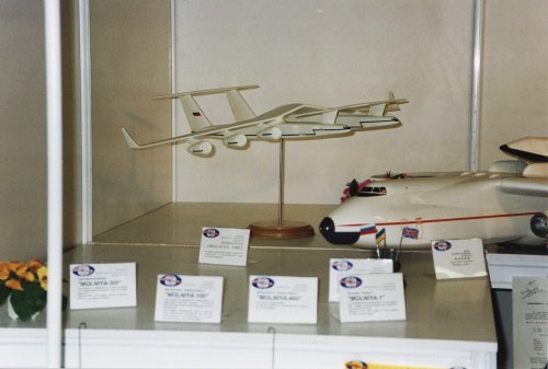

A leaflet I got at the "le Bourget " 2003

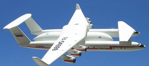

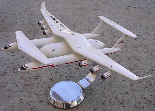

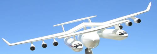

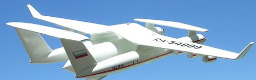

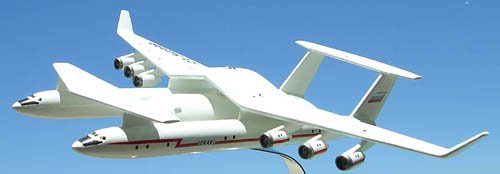

Model of Molniya-1000 Heracles from USSR-Russian Aviation & Space Collectibles (Alex Panchenko).
Description:
Gerakl (Heracles) project of Molniya for giant triplane freighter, hanging payload or pod under arched centreline between twin slim fuselages carrying lifting foreplane and tail.Designer of aircraft Lozino-Lozinskiy mentioned that On same engines we could carry 1.5 x payload of An-225. Original aircraft dimensions-Span 295 ft (90.4 m), length over 240 ft (73.4 m). This custom made resin model has wing span 15 inches.
http://www.ussr-airspace.com/index.php?main_page=product_info&cPath=28_39_38_108&products_id=1654

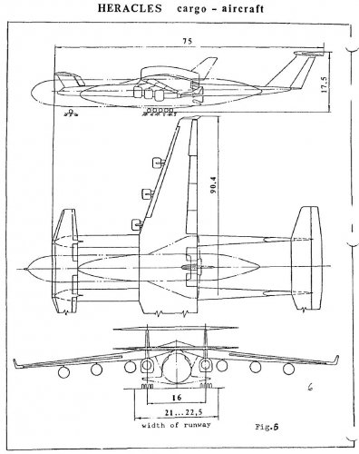

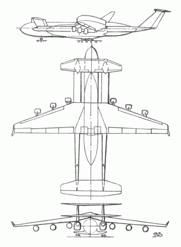

A few more pics of the "Heracles", actually called Gerakl in Russian:

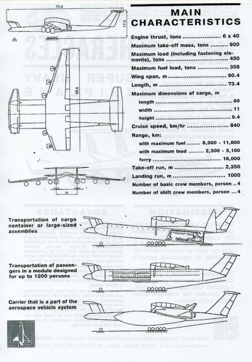

I have been reviewing some of my old folders of company brochures. I came across this two-page paper handout for the Molniya Heracles from a 1990s Farnborough Show which I hope is of some interest.
