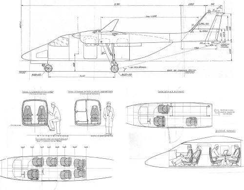

On the first picture the versions of [kompononovok] and side view the version of aircraft with the retractable chassis

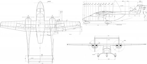

On the second picture common form. Chassis - [resornogo] type

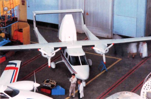

the third picture - mock-up T -420 in to shop. Picture not alas, but that there is i.e..
