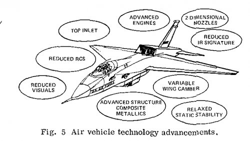

several pics of Northrop 1978 strike aircraft (refered also as VATOL and Air-To-Surface Advanced Tactical Fighter Aircraft) with dorsal inlets (may be that one El was talking about)

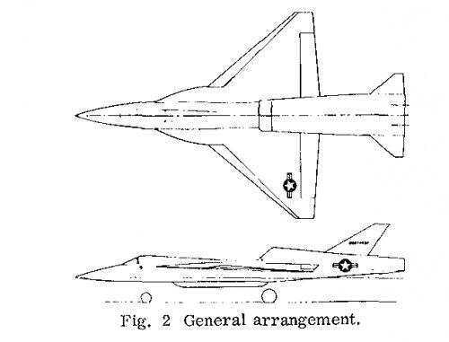

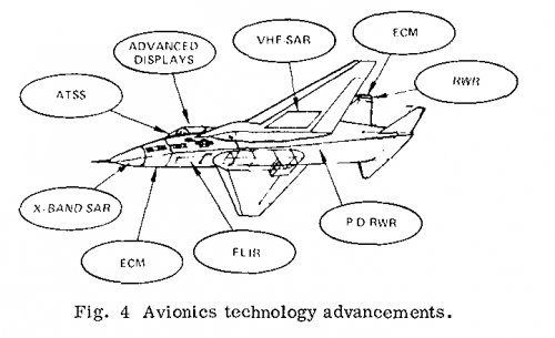

Northrop 1978 'Advanced Tactical Fighter Candidate Aircraft'
Again, remember that term ATF in 1978 meant a little bit different that it was in '81 or '85.

Indeed - early studies focussed on air-to-ground, like the study just posted.

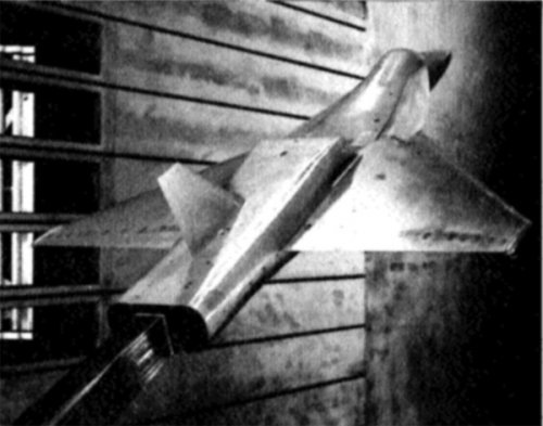

Saab did a lot of work on a dorsal inlet configuration in the Saab JAS-39 Gripen program, but it was felt to be too risky.
A dorsal inlet works well if you locate it in roughly the same vicinity as the cockpit of a manned aircraft.
If anyone doesn't care to believe me, I would refer them to the design of nearly every current UCAV demonstrator.
Northrop did a lot of studying on dorsal inlets, including tunnel time, and did find a way to make aft-plaeced dorsal inlets quite efficient even at high angles of attack. I remember seeing the papers in the AIAA Journal of Aeronautics back in the late 70s/early 80s; then all references disappeared. It does make you wonder.
The Saab design had good high AOA performance too. The main objections were difficulty of placing a second seat without disrupting airflow into the inlet, and possible problems with combined high AOA and yaw.

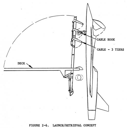

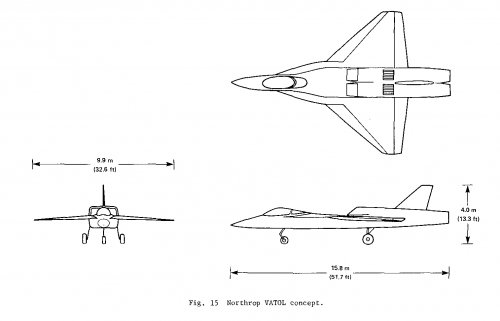

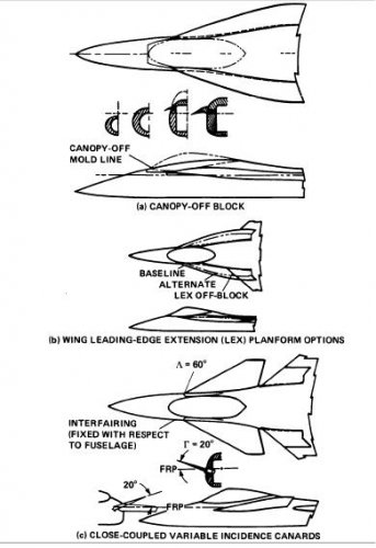

Inlet and Airframe Compatibility for a V/STOL Fighter/Attack Aircraft with Top-Mounted Inlets
D. A. Durston and D. B. Smeltzer

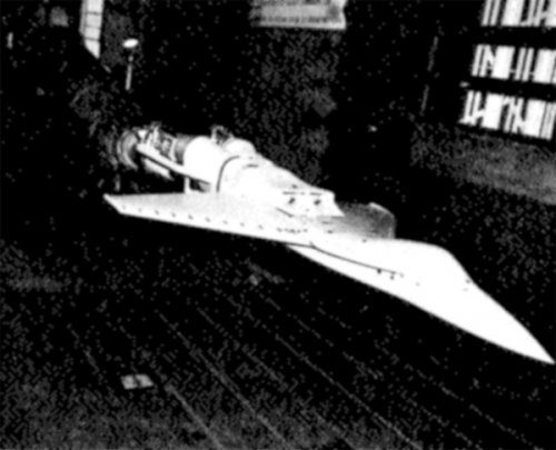

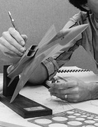

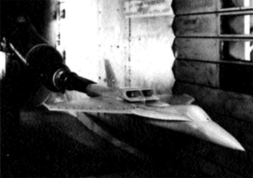

BillRo posted elsewhere the model in the attached picture below as being POSSIBLY an "N-344".
However it seems to me like the exact same proposal. What do others think?
If it's the case, then the design is the N-338-12, as clearly stated on the tail fin in the above artwork (see detail attached).
I suspect "N-338" applied to the whole VATOL project.
The picture of the model is the ATS, which isn't the same as the VATOL. It's similar because it was developed in the about the same time frame and I think the ATS design may have actually pre-dated the VATOL design.

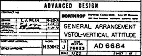

The reason I said "possibly N344" is because on the original 8X10 I can almost read the placard on the model stand. Actually N344-14 and the -14 is readable but it could be N 338-14, a minor variation. Pic is from 1982.
As a point of interest I was responsible for the book listing the N3XX project #s for a few years. The numbers were issued for unique designs. If a project (say VATOL) needed more than one unique configuration they would receive different numbers. As they evolved and developed they would get a new -# for significant changes as long as they were basically the same design. For instance a two-place version would be a different -# or two tails vs one would warrant a new -#. Wish I had made a copy for history - it went back a few years.

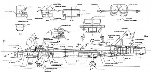

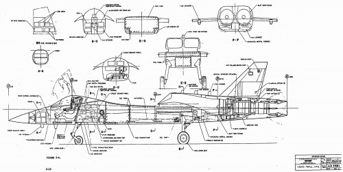

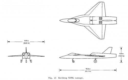

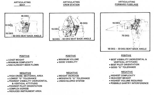

The drawing in
ppears to show the VATOL design to be N336-12.
They are two different designs as Sundog notes. ATS was an Air Force program focused on Air-To-Surface roles, while the VATOL was designed to a Navy requirement for vertical takeoff. Clearly they share many features which is why they are one topic, but they aren't identical.

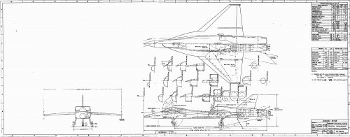

Inboard profile from same PDF appears to depict N336-7
Interestingly the PDF includes references to model tests of an earlier advanced fighter configuration:
7. Kantos, E. G., "Data Report of a 2.7 percent Scale Advanced Fighter Configuration Transonic Wind Tunnel Test", NAL-171 (NOR 77-037), February 1977.
8. Dawson, R. A. , "Data Report of a 2.7 percent Scale Advanced Fighter Configuration Transonic Wind Tunnel Test, Second Entry", NAL-180 (NOR 77-52), April 1977.
9. Franco, B. G. and Kontos, E. G., "Data Report of a 2.7 percent Scale Advanced Fighter Configuration Subsonic Wind Tunnel Test, First Entry", NAL-192 (NOR 77-108), July 1977.
10. Franco, B. G., "Data Report of a 10 percent N340 Fighter Configuration, Subsonic Wind Tunnel Test, First Entry", NAL-204 (NOR 77-141), December 1977.
If BillRo could scan the relevant original photo it will probably be possible to see if its N340.

A slightly different version of the ATS picture shown in this topic's second post:
