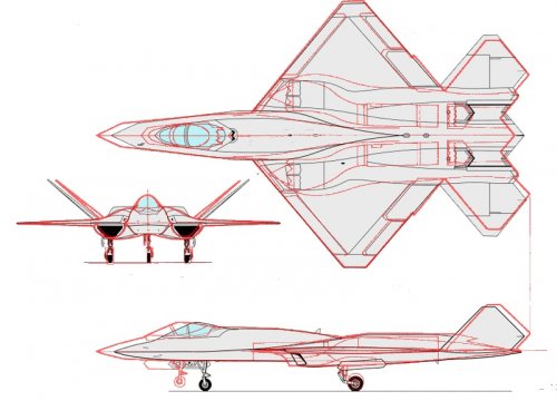

lantinian said:
So in short: IMHO you have created an aircraft with a very limited maneuvering flight envelope
Thanks Lantinian for the pointers, and mean that. I won't go on too much about my fantasy plane here as it detracts from the serious (if paradoxical) discussion of the real fictional plane, but, from my limited knowledge, I'll try and explain my reasoning:-
1. It was a quick drawing only as an exercise in illustration style and entertainment, as neither F-22 or YF-23 are not my favourite planes (first excuse).
2. The weapons bay is supposed to be wide and flat (its a fair comment) like the F-22s but bigger, and I probably would have moved further back to the C of G if I'd spent more time, but its still further back than on the real YF-23.
3. Like-wise I would have made the expansion of area under the intakes more gradual in depth to help area rule (see my previous retraction Reply #22) and as the intakes are hollow they wouldn't contribute so much and need not be too heavy.
4. Saying canards cause turbulence or reduce control can be applied to any canard plane (MIG 1.44?).
5. As for control power distance from the C of G: (see answer #2 and) remember I added heavy thrust vectoring nozzles at the back. And the moving canards are pushed along in front of the centre of rotation (which is probably a lot further back than you think) so probably still have (and for many other reasons) more power that equivalent trailing tail surfaces.
6. The intakes are on the top side as a bit of a laugh at the expense of some of the entries in the 'Re: Northrop pre-ATF and ATF studies" thread (Sorry guys), which as I already said (see my previous retraction Reply #22) I think is a bad idea.
7. Your reasons why canards are no good: trim drag is down to C of G verses C of lift (isn't it C of lift that moves backwards not C of G that moves forward ;D) and can be altered by weight distribution at the point of design. And cobra's are for airshows. All of which is addressed in the 'Cunards' thread.
8. Your friend's design is quite reasonable but is really not much of a change, as the wing position, tail and volume are unaltered. I do worry that the canards would impede the pilots view and perhaps fowl the air intakes. They are too far inboard to serve as close coupled slats for the wing though they might act as LEXs. They would however add weight and not add as much lift as my canard/widened body combination (IMHO).
Thanks again Lantinian; this is the sort of discussion I love and I look forward to your reply.
Cheers as ever, Woody

Just to wrap up some thing up nefore internet service provider crashes again :D. Sorry guys if some of this posts stays of the topic.
the Canards stall before the wing?
http://en.wikipedia.org/wiki/Stall_(flight)Check at the end just before Spoilers. My reasoning is that because canard stal before the wing you never want your wing to stall unless you have a tail control as well. Hence the SU-47 design with canards and tails. ::)
The CG moves forward?
My Mistake :-[. Its the Center of Lift that moves forward in supersonic flight. Basically the CG and the CL for a canard design should be swapped. My CG estimation was based on the main landing wheel position and book says CL it approximately 1/3 down the wing chord.
However if we do indeed decide on the CG based on the top view, Woody would be right: the CG will be farther back, behind the wheel and the aircraft will fell on its tail! :eek:
If we correct the wheel position we still have the CL in front of the CG. In supersonic flight the canards will need to generate negative lift to keep the nose down. You have loss of lift in cruise flight and bonus lift in maneuvering. Unstable canards designs are not a good choice for long range fighters IMHO as a result of that.
Something else for Woody.
http://www.desktopaero.com/appliedaero/configuration/canardprocon.html
If you note on of the disadvantages of canards is that the center of grafity of the fuel end up behind the CG of the Aircraft. Your design does not seam to do so :-\. I am still thinking on the implications of that ???
I still think having side by site weapons bays in the same line as the canards is a too big and increase in area ;). I would stick with the tandem weapons bay arrangement if I was you ;). its more aerodynamic.
Second, in the middle of the weapons bay you have a drop in the area :( as the canards are gone and the forward fuselage starts to blend with the wing.
Its the way you do it that doesn't feel right. All other canards planes have the canards set higher that the wing. IMHO to promote vortices on top of the wing. The MiG 1.44 has 2 vertical tails and has dogtooth edge on the canards to direct the vortex inward of the tails. Your canard design, IMHO will disrupt the wing lift and the vertical tails. :mad:
If I would want to improve on the F-23 design I would not stray away from the concept (Northrop Formula) but rather go deeper into it: Example: Pelican tail, Aeroplastic wing, FB-23 type of exhausts (like the first post by Matej) with possibility of TVC sideways and up only. e.t.c ::)
Regards

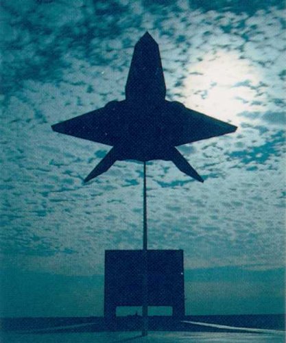

This might amuse. It is a scan from a product card I picked up at this week's Navy League show in DC. The name on the card is Lockheed Martin, but the design is clearly influenced by the YF-23.
The Low Cost Aerial Target was actually designed by a small California company called AeroMech, which was recently acquired by another company called xcelaero. It is a target drone - catapult-launched, jet-propelled and parachute-recovered. Not dimensions are given, but the photos show it is small enough to be carried by two people.
The LCAT is in use as a low radar-signature target. The idea of the design is to minimise the drone's natural radar cross-section as much as possible so that the radar signature can then be augmented artificially to mimic that of any target aircraft. The product card shows it being used as a target for an F-22-launched AMRAAM.
Clearly someone felt the YF-23's configuration was indeed the stealthiest solution...

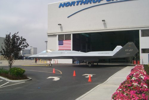

As Western Museum of Flight said, Northrop will not return PAV-2 to the WMOF...
elmayerle
CLEARANCE: Top Secret
Jan 8, 2006
1,307
75
So is Northrop-Grumman keeping it, doing with it what they will (which is not encouraging given their track record), or is it going to another museum?
flateric
CLEARANCE: Above Top Secret
Apr 2, 2006
8,922
564
Dunno, Evan, in your position I'd better ask you than you me:)...'restoration' said to be completed as far as on late summer 2005 - here some pics posted by ximeno at F-16.net
http://www.f-16.net/index.php?name=PNphpBB2&file=viewtopic&t=3010&postdays=0&postorder=asc&highlight=yf23&start=75

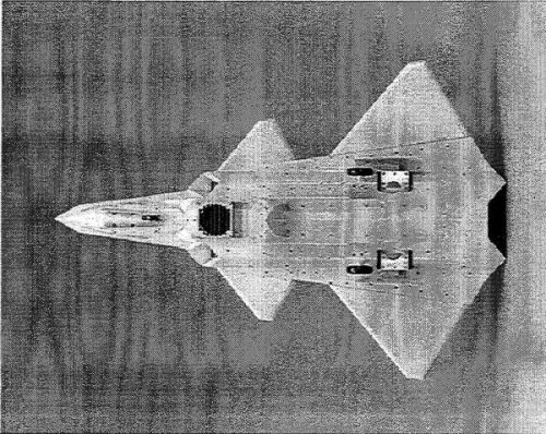

This is highly detailed full-scale YF-23 RCS mockup, weighting 5 tonns and having all external panel lines and details. Was built by Northrop's so-called '705 Test Crew' (mock-up shop) and exstensively tested at Tejon Canyon RCS Test Range. On a photo you can see shelter that was rolled over the mockup on a rails during Soviet spy sattelite flyover the range.
Photo (c) Northrop Media Services via Ian Maddock

flateric said:
Citation from famed Ed Rasimus
"Weapon bays on the original mockup held both Sidewinders and AMRAAMs with no problem--4 and 4 IIRC."
Interseting, I never thought that -23 mockup was ever built...
It was built, in fact. Photo (c) Allen Rockwell (he worked for Northrop) - later author of several large powered YF-23 models (as a hobby).

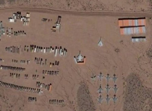

YF-23 fill-scale RCS model at White Sands missile range
http://maps.google.com/maps?ie=UTF8&oe=UTF-8&hl=en&q=33%C2%B031%2716.64%22N+106%C2%B011%2742.20%22W&z=18&ll=33.541654,-106.21074&spn=0.002057,0.005322&t=k&om=1

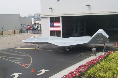

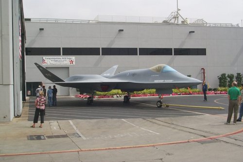

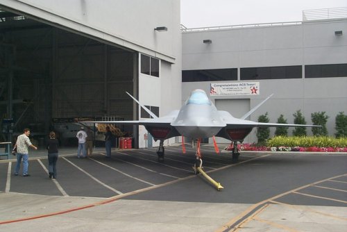

Current state of YF-23 PAV-2 - parked outdoors inside NG Hawthorne facility after 2-year 're-surfacing' restoration.
Photos are from SoCal_CJ originally posted at www.f-16.net
