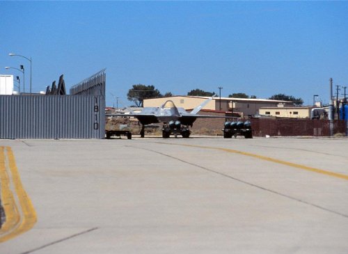

It's not restored. It looks like it's put back together and just sitting there. Definitely looks like it's been sitting out for a while. I took a few photos of it in May - I'll post those up when I pull those out of my external drive.
