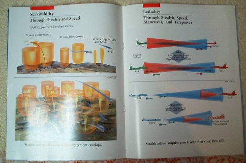

CammNut said:
This might amuse. It is a scan from a product card I picked up at this week's Navy League show in DC. The name on the card is Lockheed Martin, but the design is clearly influenced by the YF-23.
The Low Cost Aerial Target was actually designed by a small California company called AeroMech, which was recently acquired by another company called xcelaero. It is a target drone - catapult-launched, jet-propelled and parachute-recovered. Not dimensions are given, but the photos show it is small enough to be carried by two people.
The LCAT is in use as a low radar-signature target. The idea of the design is to minimise the drone's natural radar cross-section as much as possible so that the radar signature can then be augmented artificially to mimic that of any target aircraft. The product card shows it being used as a target for an F-22-launched AMRAAM.
Clearly someone felt the YF-23's configuration was indeed the stealthiest solution...

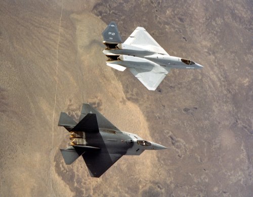

The external shape of the yf-23 might be stealthier than yf-22 (I think the word "more balanced in term of stealth" would be more appropriate, since the yf-23's stealth is pretty balanced from all aspects, unlike yf-22, which does not represent the same level of attention for stealth from the rear aspect in comparison to frontal aspect). However, in real combat aircraft design, external shape is but one factor among others in term of stealth.

^second that since the spike points are "cleaner in distribution" hence, a stealthier platform from the side and rear aspect. although having less 2 tails is one major factor IMHO

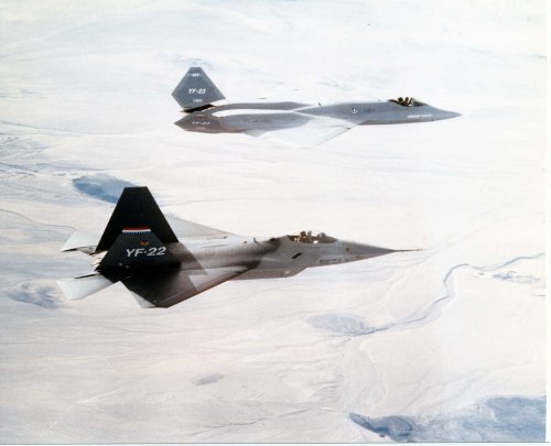

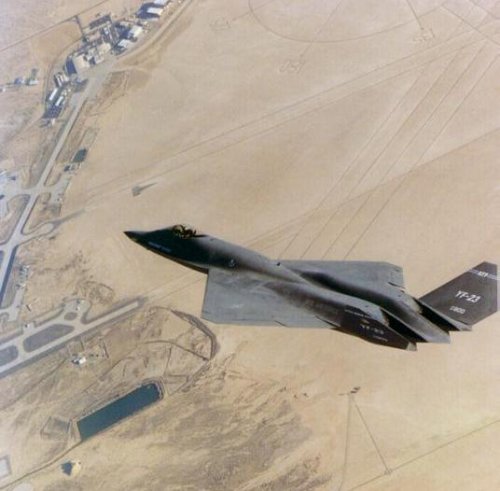

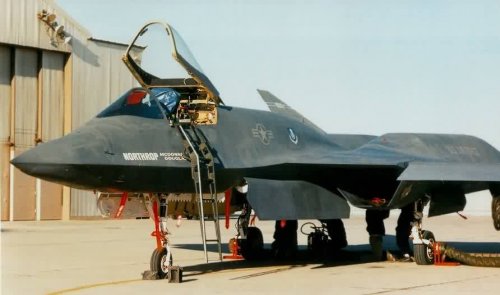

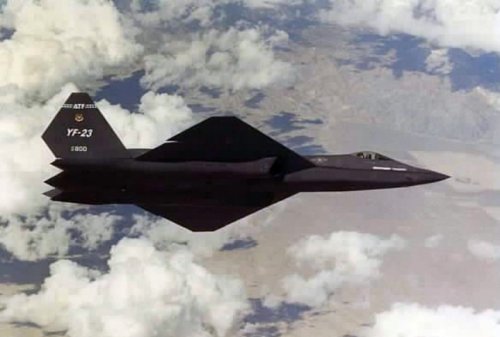

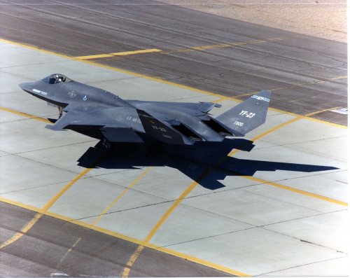

I was wondering if someone had sufficient drawings to create a CG model of the F-23 (latest version we know that is the blue prints that orion posted)?
I have difficulties imaging the upper part of the fuselage.
