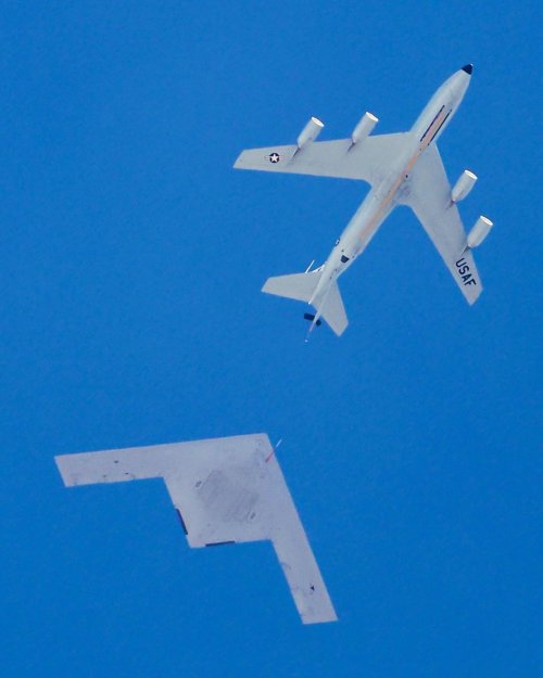

The B-21 has fairly high bypass ratio engines. The side bays are close to the estimated engine location so they will most likely be fairly shallow. The weapon bay doors will be angled the same as the leading and trailing edges so the effective bay length will be much shorter.
I expect the shallow side bays to be AMRAAM depth to allow a dozen SDB while the main bay can have a rotary launcher with 6-8 large weapons.
Yes, outboard to inboard: MLG door, engine bay door, possible small weapons bay door(s)?, main weapons bay doors.
You can clearly see the panels you are talking about, between the bomb bay doors and the engine access doors, are asymmetric. The left and right panels are different. So, not likely weapons bays. They're most likely access panels to engine accessories, housing some sort of sensors or avionics/test systems that require easy access.

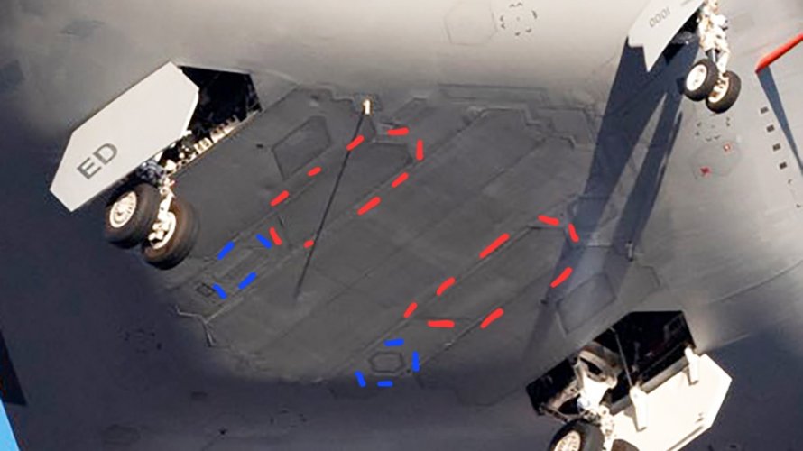

Spot on. We have two AMRAAM sized weapon bays near the front and we have mini-missile and decoy dispensers in the aft.
Red dashed line show the bays are the same on both sides. Long enough to fit approximately 2-3 AMRAAM or 6-8 Small diameter bomb.
Blue dashed line look similar to the F-35 decoy dispensers.
Who is “we”?
I doubt the B-21 uses any chaff or flares, the B-2 is not equipped with them, doesn't need them.
This thread has been discussing this when the first flight of T-1 happened… The red dashed lines are panel seams with screw holes, which can be seen in the contrast-enhanced images, which makes them practically impossible to be missile bays…
These have been identified as most likely avionics maintenance panels.

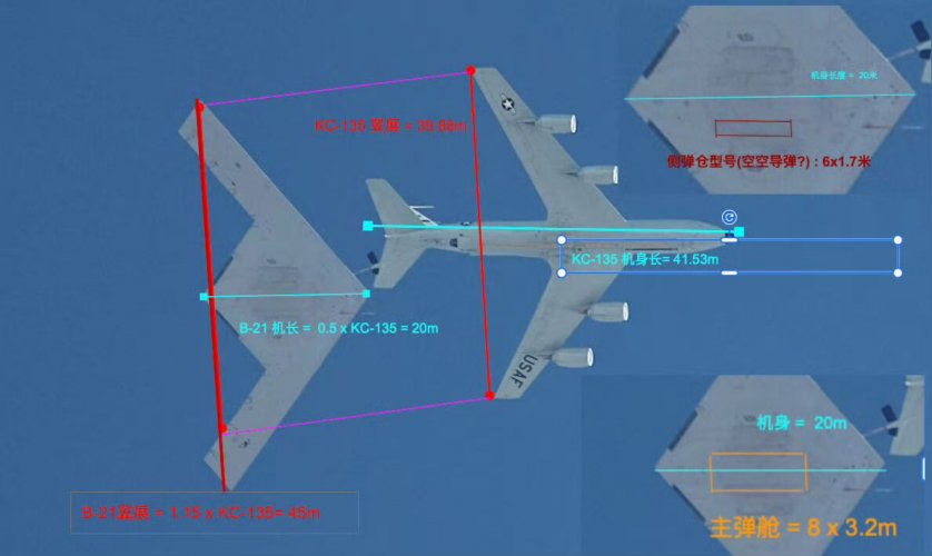

It looks like a translation of the measurements in the above image for @insidersource could help
1. Top right hand corner in red denotes the "long panel/ AAM bay" measurements: 1.7m wide x 6m long. 米 = m
2. In your own zoomed in shot, it's clear that even you yourself thinks the same area marked out by @trajan 's picture is bifurcated. Or else you would have drawn the red lines around the entire long panel. Rounding up, 6m translates to about 20 ft (19.685ft). half that and you're still more than 2 ft short.
3. Some extremely seedy math to estimate perspective problems since the B-21 is going to be closer to the viewer than the KC135 is: The KC-135's measurements are more well known, so I assume the guy used KC-135 measurements to estimate the B-21's own measurement. Most aerial refueling happens between 15,000 - 30,000 ft. If we assume the KC-135's probe is 48 ft long fully extended and drops down 30 degrees from the horizon, 48sin(30) = 24 ft height difference. We assume crudely that the B-21 is 24ft closer to the view point (simplistically) than the KC-135. 15000ft / 14976ft is roughly a 0.16% difference in dimension size. Even at the lowest bound, perspective alone cannot make up for the remaining 2 ft in length - that is unless my math is off and I need to go back to middle school (which I might need to)
So unless that slant in the panel is enough to make up for 2 ft (I highly doubt it can), or you are willing to argue that the front section of the panel is 2 ft longer than the aft section, or missiles are tucked diagonally into the panel, then I'm not sure how that's going to fit AMRAAMs - as much as I would like it to.

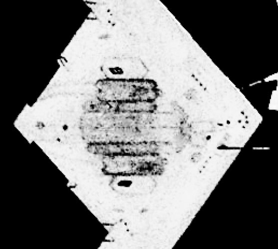

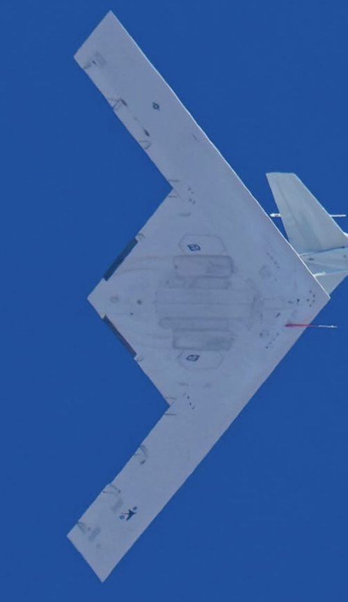

The aerial refueling photo in higher contrast to see the bifurcation line of that particular panel. You can clearly see that panel is roughly bisected by the slanted panel seam:
