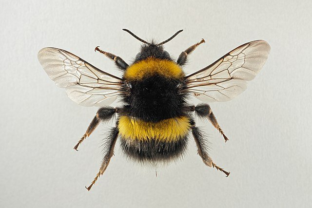

The bumblebee can't fly but he doesn't know it.

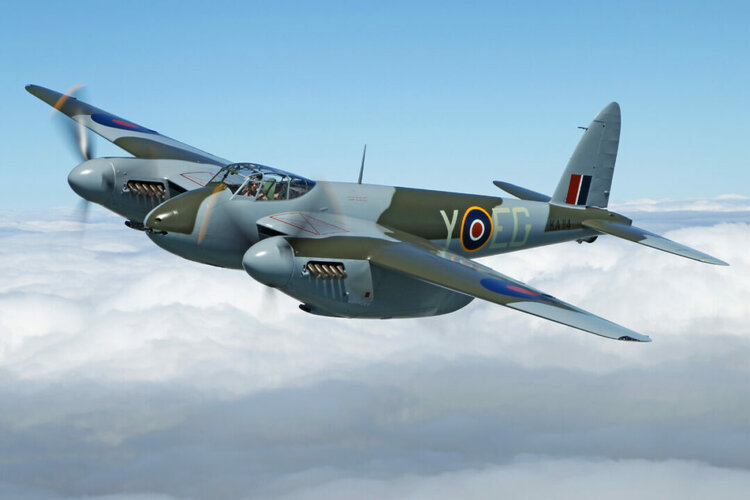

It's not possible to build a bomber faster than fighters, but a guy who didn't know it built the D.H. Mosquito

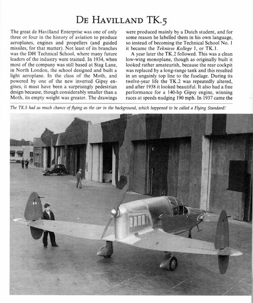

Concerning the De Havilland TK.5 canard that couldn't fly: I think they didn't try enough experimentation to get it off the ground. Just having the landing gear in the wrong place or at the right heights is enough to make a tricycle gear airplane impossible to take off. The other issue that might have made them risk adverse was that the test pilot could be hurt if something went wrong.
Unconventional aircraft configurations are not inherently dangerous or guaranteed to fail. The problems encountered with unconventional configurations is that the solutions to their issues may also be unconventional and require learning new ways to tame them. To reduce the consequences of unconventional aircraft handling, take the pilot out of the airplane and test and refine with models.
It's possible to get almost anything to fly as a model. If the model crashes, no one dies, and you fix the model or build a new one and keep testing. Once the bugs are worked out through getting the model to fly reliably and as much risk as is feasible has been refined out of the configuration, then put the test pilot back in the airplane.
