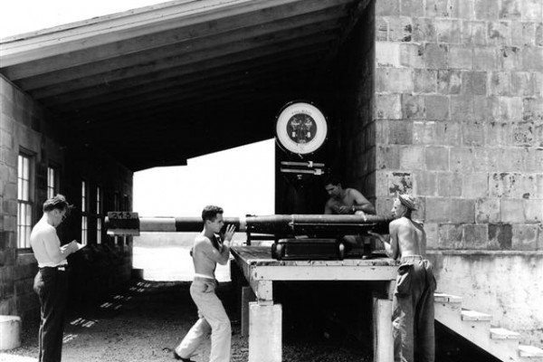

In ramjets, the USN under Project Bumblebee had Johns Hopkins designs being fired to Mach 1.5 to 1.75 at ranges up to 10 NM and 30,000 feet by May 1945 as the basis for a SAM.
A Cobra test ramjet missile.
