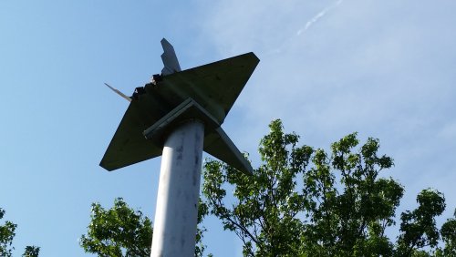

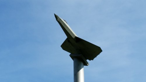

Its definitely a model of the Northrop / McDonnell NATF without canards. There were various iterations of the NATF design. Good find!
Its in the St Louis suburb of Bellefontaine Neighbors - who lives near and owns a camera?????
