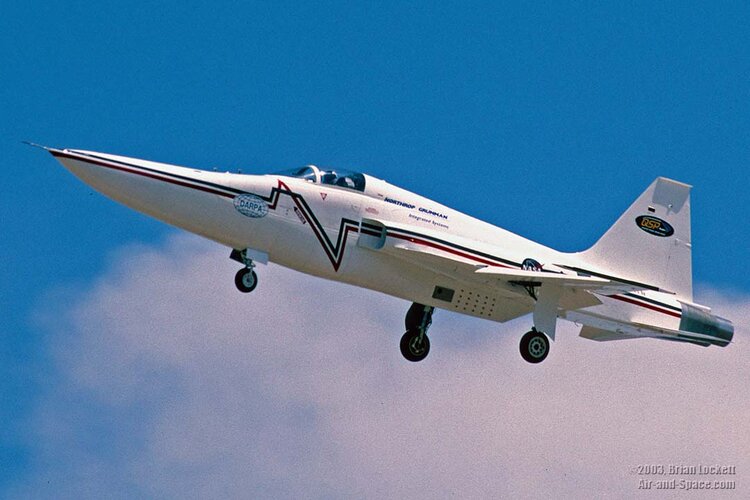

The purpose of that design was to take a known quantity, the sonic boom from an F-5, and show that careful shaping could be used to reduce the strength of the shock. The test was a success and proved that. The X-59 is a test to see how low we can get the boom down to and to test what the threshold may be between unacceptable to people on the ground versus what wouldn't bother them.
One of the unfortunate correlaries with the shaping for boom reduction is that it is very different from the transonic area rule shaping.The purpose of that design was to take a known quantity, the sonic boom from an F-5, and show that careful shaping could be used to reduce the strength of the shock. The test was a success and proved that. The X-59 is a test to see how low we can get the boom down to and to test what the threshold may be between unacceptable to people on the ground versus what wouldn't bother them.

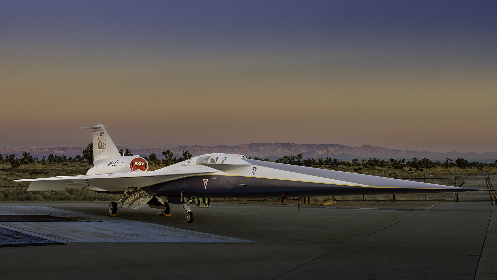

With the exception of the super extended nose, the X-59 generally resembles several different Supersonic transports or business jets. The real question is: "where do we need to put engines on full sized transports?" (as opposed to Business Jet sized craft)I see what you're saying, but the X-59 looks like a dead-end in terms of configuration for quiet SSTs. It is impractical to scale it to an airliner with any economic payload.
So even if it does demonstrate sonic 'thump' instead of boom, a new raft of research will be needed to find practical designs that can implement that capability economically. So... what's the X-59 really contributing?
For Business Jets, IIRC the typical load is 5-8 people, but they do need enough cabin diameter to stand up straight. Good thing we get to use area ruling to our advantage, use a fairly large diameter passenger compartment ahead of the wing, use the wasp waisted part as fuel tanks.If it proves relable supersonic transport over inhabited lands, anyone would be ready to see the profitable future that lies beyond the nose tip.
Regarding the projected length of a derived commercial aircraft, in the domain of businesse jets, remember that these have considerably grown in size to accommodate comfortably passengers on long haul travel. If then flight time is reduced by three, a lot of the amenities like internal volume or cabin length would go on the shopping board first as being irrelevant. It's way more comfortable to spend your time in a 5 star hotel than in an aluminum tubular airframe. No VIP suite are built in a soda can!
In a way it is a record breaker: quietest ever sonic boom.It looks more like a record breaker one off airframe than a scaleable prototype, but hey, perhaps the X-3 Stiletto was onto something after all...
That's not the point of the X-59. It is not meant to be a configuration to demonstrate a new SST. It is designed to be able to vary it's boom strength to test a range of boom strength's to determine the limits of what is acceptable. Go through this site and look up the N3 SST designs the primes have made for NASA. They incorporate low boom design tech and Lockheed even presented a low boom SST design alongside the X-59 design. The problem is, while they now know how to design for low boom, they don't know what the boom spec. is required to be to make their designs acceptable. NASA needs to answer that question before they can finalize their low boom SST designs and the X-59 will provide the data for that answer.I see what you're saying, but the X-59 looks like a dead-end in terms of configuration for quiet SSTs. It is impractical to scale it to an airliner with any economic payload.

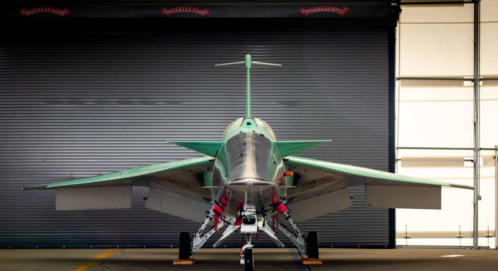

With cameras under the nose, you don’t need a droop snoot.Sadly no droop snoot![]()
Reasons for delays were explained quite clearly in prior posts in this thread like COVID and aeroelasticity issues - and last ones because X-59A is far from definition of 'classical' airframe (just to mention its CFRP nose with almost 40% of fuselage lenght hanging on 7 bolts).This program taste like some DIY project since a while (remember that Pic with the dozen supervisors watching a lone operator using a wrench?). See the impressive delay assembling something that remains a classical airframe when it comes to manufacturing. Then the u unofficial rollout just to plunge it back in hangar for 6 (?) extra months.
