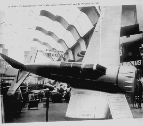

From ICARE "Les Rois du Parasol Morane Saulnier 1918 - 1968":

Hi Jan
An happy new year !
I send you
2) 430 with original fin
1) 430 modified with new fin
3) 430 photos as "1"
Our friend Jemiba give you 430 as at Le Bourget 1936
fin as "2"
4) details

Hi Jan
an error !!
In 1936 the "Salon de l'aeronautique" was not at Le Bourget
but at "Le Grand Palais" in Paris.
Sorry
Bye

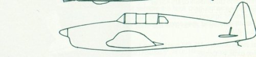

Hai
Concerning pre war Morane-Saulnier Trainers.
I found the enclosed drawing concerning a project 431.
Who can tell me more about this project and maybe a better complete drawing?
Jemiba
CLEARANCE: Above Top Secret
Mar 11, 2006
8,133
696
This side view comes from "Morane Saulnier-Ses Avions, Ses, Projets" by Henri Lacaze and is the only drawing of this
project there. The description says "... several variants <of the MS 430> were proposed, e.g. with inline-engines (probably
Renault 12R, maybe Salmson 12V ? Régnier ? Béarn ?),..."
Judging the drawing, it's just the 430 with an elongated aft fuselage to balance the longer engine.
