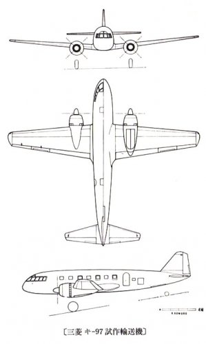

Can someone post a 3 view of the Ki-67 to compare with the Ki-97? I'm curious if the wings and tail are really borrowed from the '67.
Hi Blackkite you can see the ancestry between the the Ki-67 hiryu and the Ki-97,especially the wings and the engine nacelles are in my opinion the same.
but nevertheless its a very nice aircraft,if it had the Chance to fly
Blackkite
Here is a 3 view of the Ki-97 cargo plane derived from Hiryu.
Enjoy!

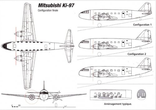

from Le FANA 425,the Mitsubishi Ki-97 cargo transport
aircraft,and its early drawing.

Yes, Giuseppe "Joe" Picarella's work with this book is outstanding. For those unaware, he is Flight International's Senior Technical Artist. If ever you need to contact them re a drawing or cutaway, he will often answer you directly and very promptly. :)
