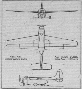

the Miles M.61 was single engined light transport and freighter
aircraft,it had a high wing and rear door,the Miles M.62 was
all metal twin engined version.
http://www.flightglobal.com/PDFArchive/View/1945/1945%20-%200712.html

Hesham, many thanks for your untiringly research, this again is a very interesting project ,
especially as the M.62 is mentioned in R.Paynes "Stuck on the drawing board", too. But the
flight article shows, that this project probably was drawn already in 1943/44 and not after
the war. Additional information on the M.62 : 2 Wright Cylone GR-2600 or Bristol Hercules
engines, span 110 ft, lenght 69 ft, front and rear loading.

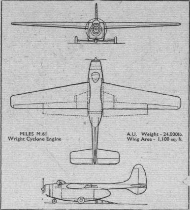

The recently published third Air Britain book on Miles Aircraft has a little bit more information on the Miles M.61 and M.62 high wing "Economical Freighter" transport type with a thin tail boom dating from April 1944.
Miles M.61
Wooden construction with a metal boom. Wright Cyclone chosen because of their availability and previous experience of installation on the Monitor and Martinet designs.
Not ordered by the Air Ministry and remained a project.
Engine: 1 x Wright Cyclone GR2600 A5B or 1 x Bristol Hercules XI
Wing Span: 94 ft 0 in
Length: 28 ft 6 in
Wing Area: 1,100 sq ft (inclusive stub wing)
Empty Weight: 11,290 lb
Crew & Equipment Weight: 1,170 lb
Fuel & Oil: 2,800 lb
Cargo Weight: 8,740 lb
All Up Weight: 24,000 lb
Wing Loading: 21.8 lb /sq ft
Power Loading: 15.0 lb / hp
Cruising Speed: 164 mph (50% power at 8,000 ft)
Range: 1,000 miles
Take-off Run: 1,350 ft
Freight Compartment Floor Length: 19 ft 0 in
Freight Compartment Floor Width: 6 ft 6 in
Freight Compartment Floor Width: 5 ft 6 in

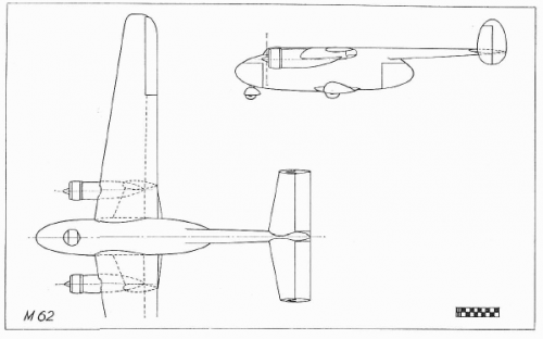

Miles M.62
All metal construction with a high wing and 'H' tail on the end of a thin boom. Four Bristol Mercury engines were considered as an alternative.
Front and rear doors to allow loading and unloading to be achieved simultaneously. This larger design could carry a Bren gun carrier or Bofors gun.
Engine: 2 x Wright Cyclone GR2600 A5B or 2 x Bristol Hercules XI
Wing Span: 110 ft 0 in
Length: 28 ft 6 in
Wing Area: 1,500 sq ft
Empty Weight: 20,960 lb
Crew & Equipment Weight: 1,620 lb
Fuel & Oil: 5,5400 lb
Cargo Weight: 17,000 lb
All Up Weight: 45,120 lb
Wing Loading: 30.0 lb /sq ft
Power Loading: 14.1 lb / hp
Cruising Speed: 170 mph
Miles Aircraft - The Wartime Years Production, Research & Development During World War II by Peter Amos (Air Britain ISBN: 9780851304304)

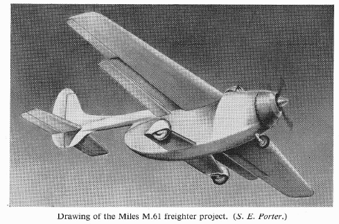

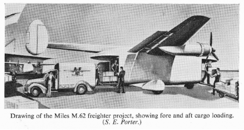

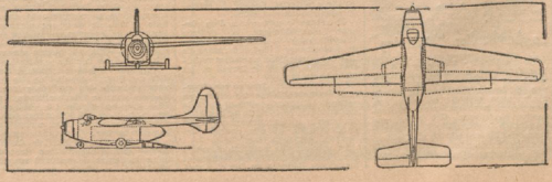

Thank you my dears Cy-27 and Toura,
and here we go.
