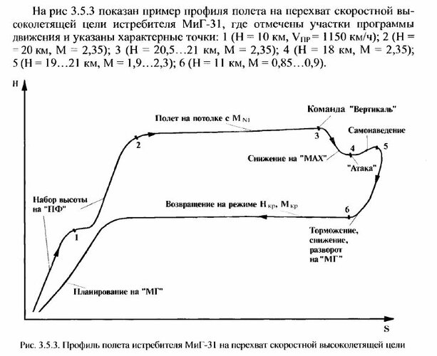

The flight profile of the MiG-31 to intercept a high-speed high-flying target. The speed does not exceed M = 2.35. This is probably due to ensuring the flight range

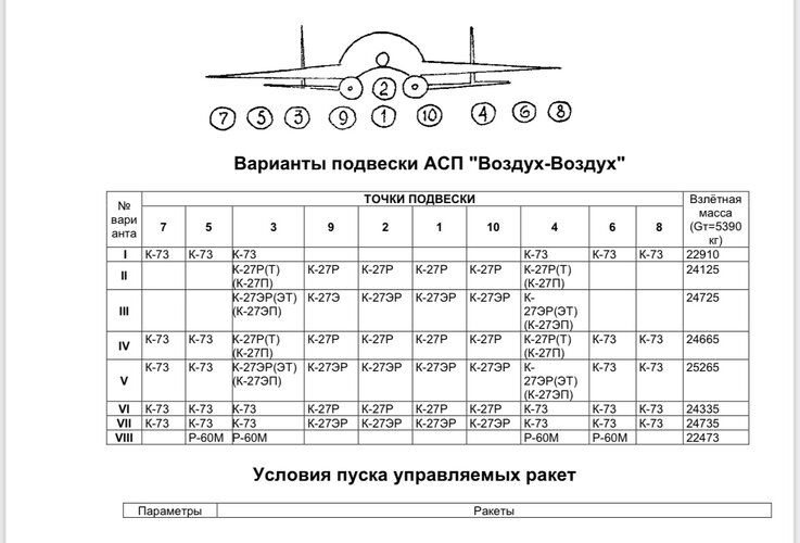

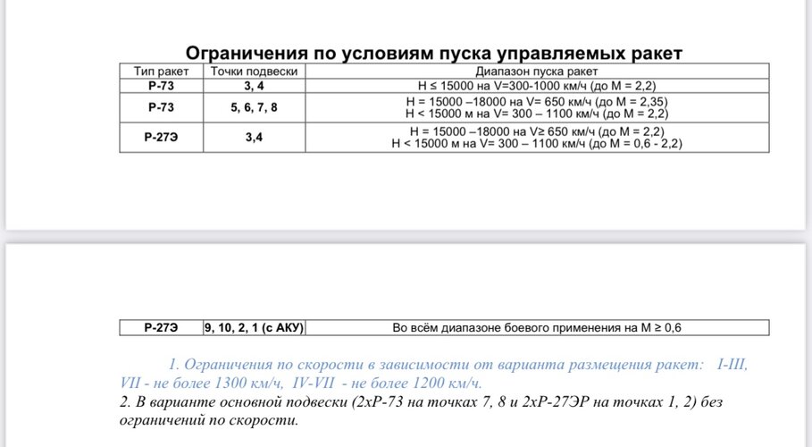

Su-27: 2 R-73 at points 7, 8 and two R-27ER at points 1,2 - without speed limits
Thank you, that is the Russian manual?.
To be honest, the data is so surprising to me. With just 6 R-73 on the wing, Su-27 is limited to 1300 km/h aka Mach 1.2 ???. That is insanely slow. Even an F-16 have no issue reaching Mach 2 with 6 AIM-120, it can even reach Mach 1.6 with 370 gallons tank. How come the speed restriction of Su-27 is so horrible?
This is IAS (Indicated Air Speed), the true speed TAS (True Air Speed) is much higher. IMHO

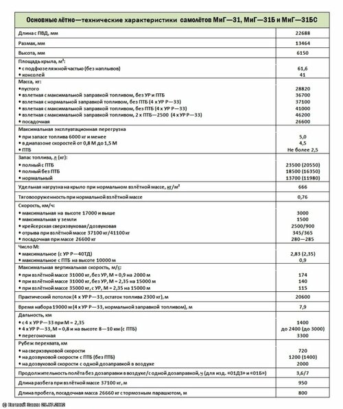

The MiG-31 has a maximum true speed no higher than that of the MiG-25, but the maximum instrument speed is already 1500 km / h, for the MiG-25 it was only 1150 km/h
I'm not sure. But the thrust-to-weight ratio of modern fighters is such that it does not limit their maximum speed. I looked at the manual for the Su-27SK and found no other speed limits. Therefore, there is nothing to prove yet.
