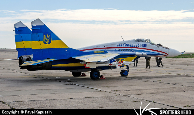

The surviving MiG-29s of the "Ukrainian Falcon" are dwindling, it seems that one of them has been shot down. Contrary to what this article says they had been taken out of storage as early as 2014.
It seems that the colored Ukrainian MiG-29 are not the old "Falcons" :

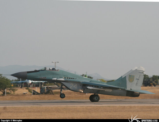

What I find extraordinary is that the Ukrainian Air Force withdrew its last MiG-29s (9-12) in the early 2010s, almost 10 years ago !
Ukrainian MiG-29 (9-12) (24 white, 2960518763) at Belbek - Sevastopol (5 September 2007).jpeg

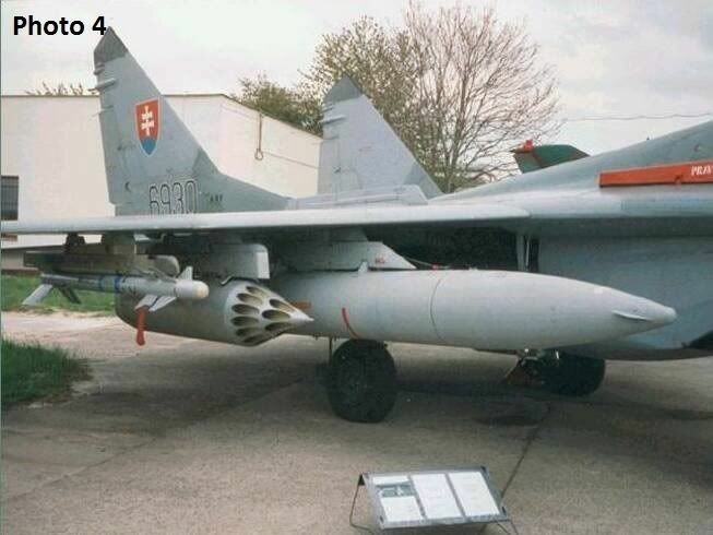

I just remembered that a Slovakian MiG-29A, "6930" had been wired to carry French Magics missiles. Unfortunately, it was lost in a crash in the early 2000s.
Many MiGs have been modified for Magics : Iraqi and Indian MiG-21s, a Czech MiG-23.....
Maybe the Ukrainian "Fulcrums" fleet could also be wired with French IR missiles ? This would allow to compensate a possible lack of R-73.
Maybe even IR MICAs ?

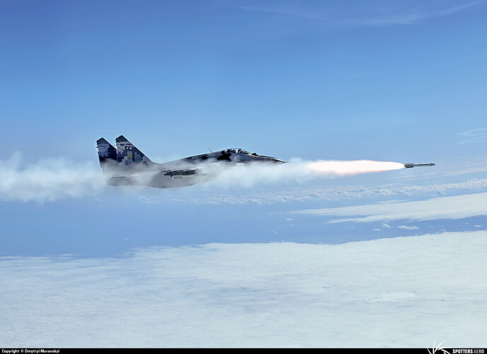

  • Ukrainian MiG-29 (9-13) (72 white) firing R-73 over his land (10 Novembre 2017).jpeg

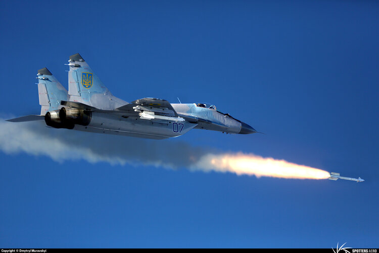

  • Ukrainian MiG-29 (9-13) (07 blue, 2960728502) firing R-73 over his land (25 Septembre 2012).jpeg

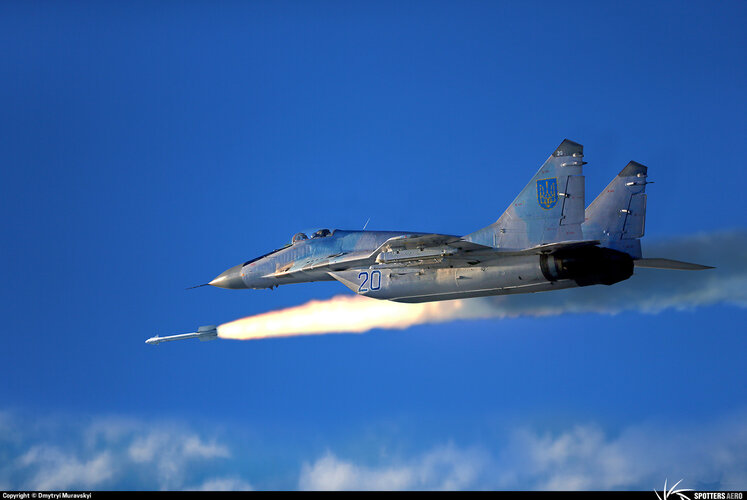

  • Ukrainian MiG-29 (9-13) (20  blue, 2960728165) firing R-73 over his land (25 septembre 2012).jpeg

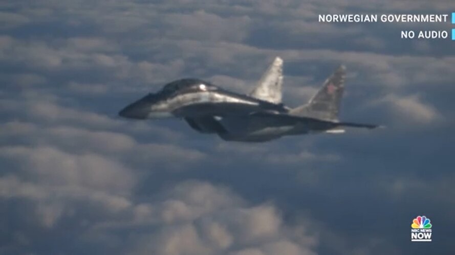

Yes, 70-something with navy. Just not in the conflict zone. Probably precisely to avoid unnecessary FoF complications.
A couple weeks ago, Norway:

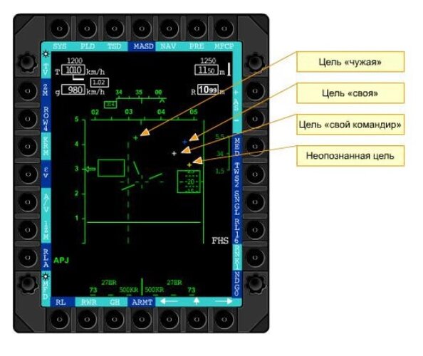

The SMP/UBP are upgrades for the FAP MiG-29S (9-13SE) & MiG-29UB fleet. In August 2008 a contract of US$106 million was signed with RAC MiG for this custom SM upgrade of an initial batch of eight MiG-29, with a provision for upgrading all of Peru's MiG-29s. The single-seat version is designated SMP, whereas the twin-seat version is designated UBP.
It features an improved ECM suite, avionics, sensors, pilot interface, and a MIL-STD-1553 databus. The interfaces include improved IRST capabilities for enhanced passive detection and tracking as well as better off-boresight launch capabilities, one MFCD and HOTAS. The N019M1 radar, a heavily modified and upgraded digital version of the N019 radar, replaces the standard N010 Zhuk-M of the MiG-29SMT. The upgrade also includes a structural life-extension program (SLEP), overhauled and upgraded engines, and the addition of an in-flight refuelling probe.
