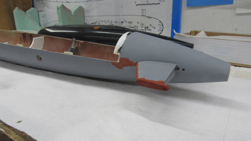

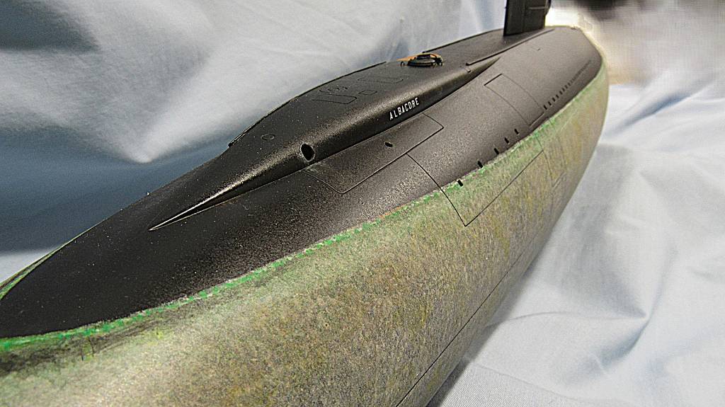

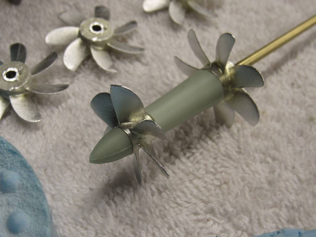

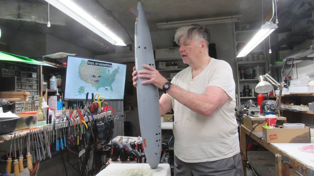

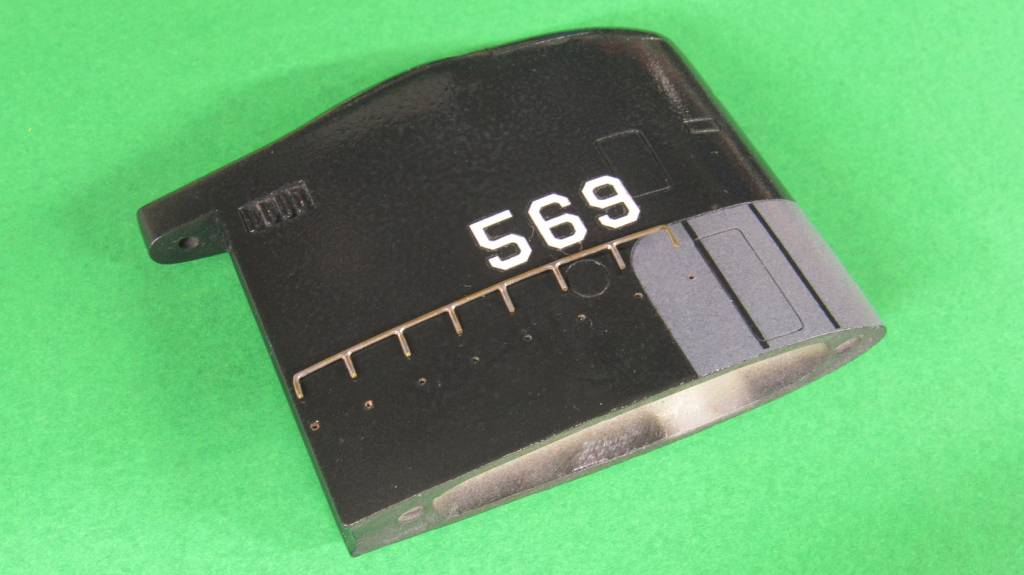

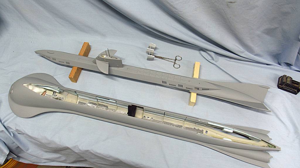

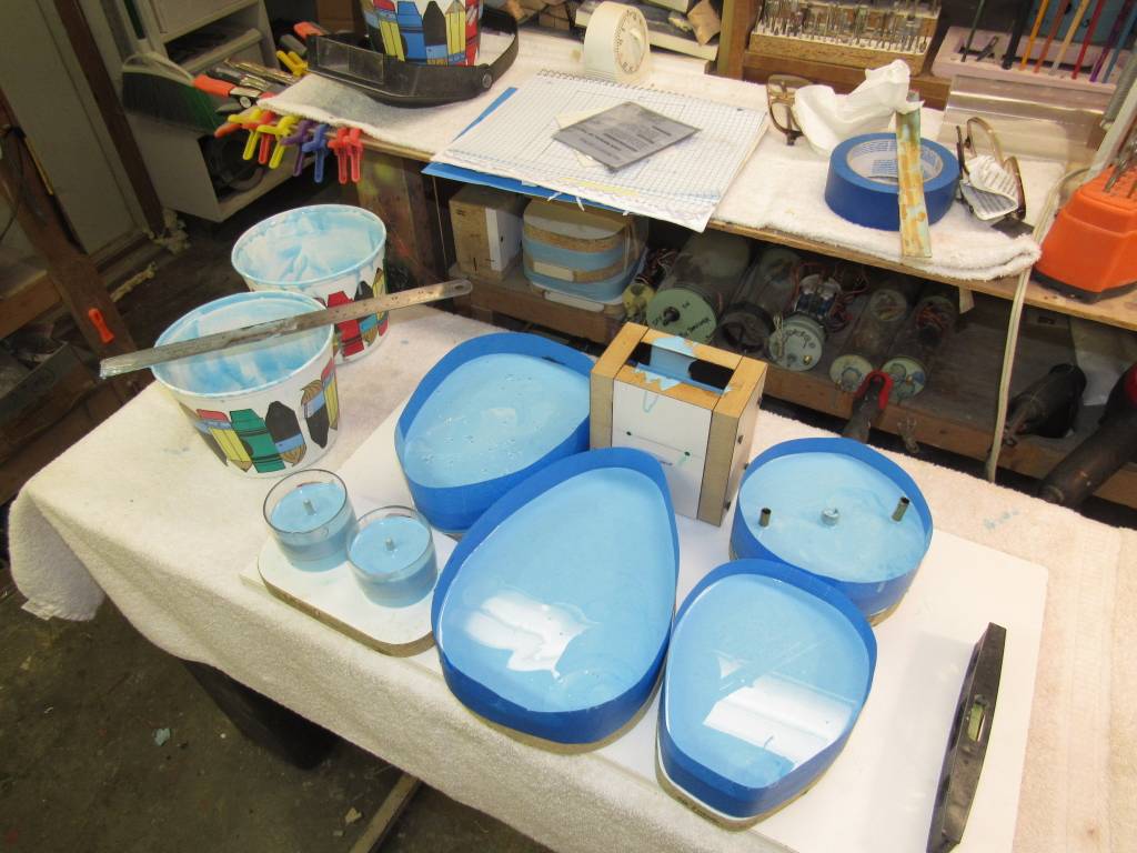

No, Scott. Not this time. A 1/48 ALBACORE. I was sent this very nice resin printed master. My job is to produce a glove-mother mold and produce GRP parts. The sail and tail-cone will be hollow cast resin. The control surfaces will be solid cast resin, and the propellers cast from white-metal. The lead-man on this project, Howard, had the actual boat 3D surveyed, that's how accurate this master is. Crazy! Work won't start till after the Cabin Fever event, this January.Another Barbel-class?
How are you gonna build this one? X planes and counter-rotating props?No, Scott. Not this time. A 1/48 ALBACORE. I was sent this very nice resin printed master. My job is to produce a glove-mother mold and produce GRP parts. The sail and tail-cone will be hollow cast resin. The control surfaces will be solid cast resin, and the propellers cast from white-metal. The lead-man on this project, Howard, had the actual boat 3D surveyed, that's how accurate this master is. Crazy! Work won't start till after the Cabin Fever event, this January.

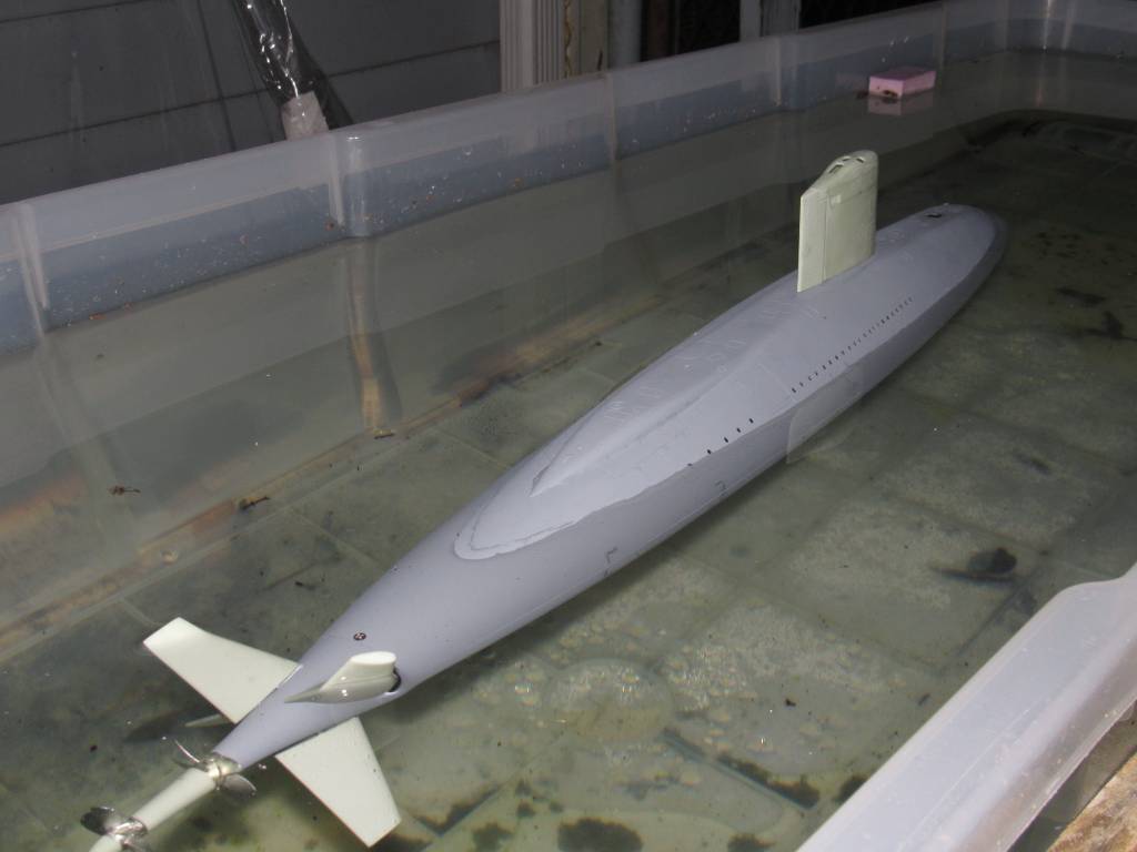

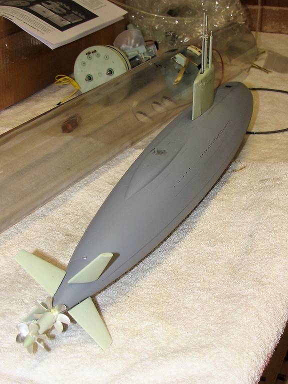

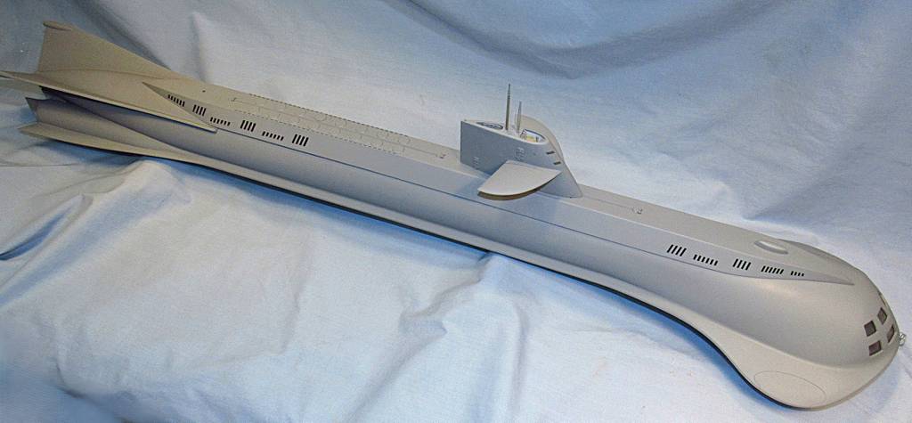

The job is just to produce tooling and one test-shot (prototype kit) for the customer. But I've been given permission to make a number of copies for myself and partners-in-crime. I'll assemble mine as the phase-4 configuration; pretty much in the same fashion as this 1/96 ALBACLORE (the gray one) I put together a number of years ago. And a 1/60th one way back when dinosaurs ruled the Earth.How are you gonna build this one? X planes and counter-rotating props?

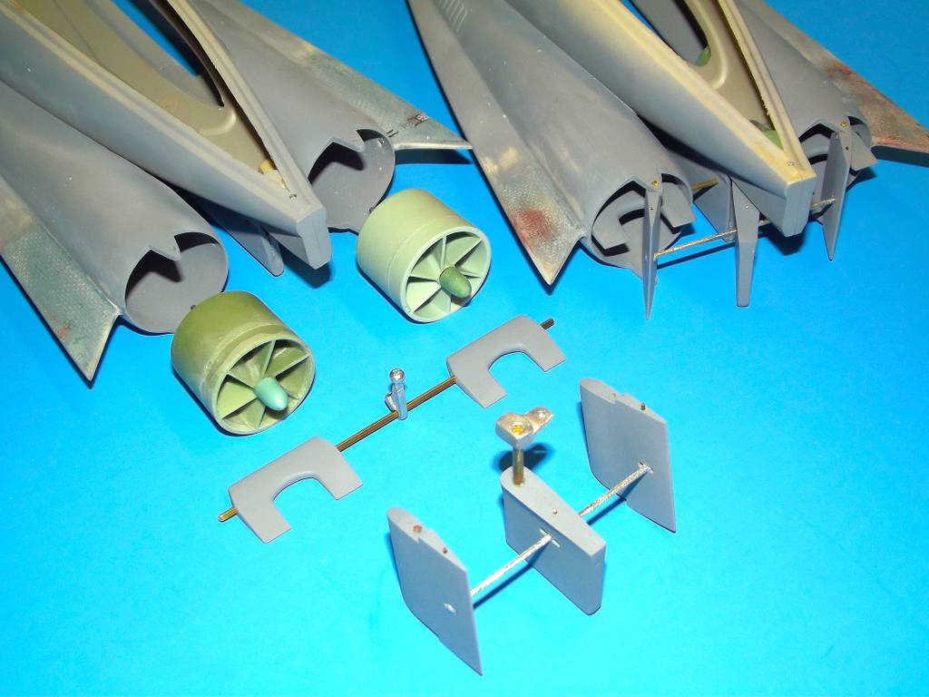

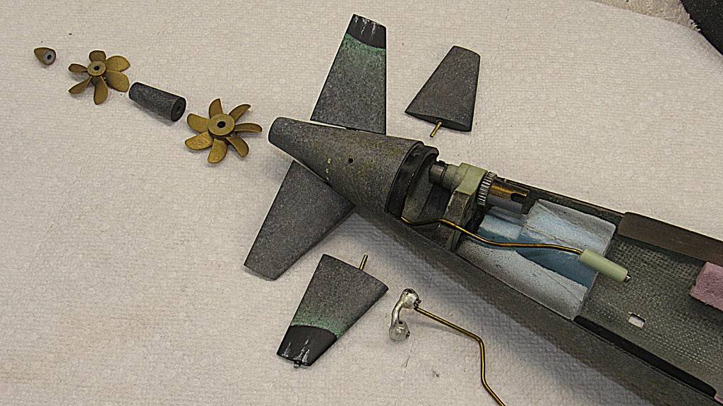

Oars, paddle-wheels, bottom-poles, screws, pump-jets, shark-fins, sails, oscillating hydrofoils, caterpillar drives... they're all 'propulsors'.Gotta admit, the "X-planes and counter-props" setup is my favorite look for a sub before propulsors.
I mean the pumpjet "lampshade" on the aft end of 774s, 21s, and the British boats.Oars, paddle-wheels, bottom-poles, screws, pump-jets, shark-fins, sails, oscillating hydrofoils, caterpillar drives... they're all 'propulsors'.

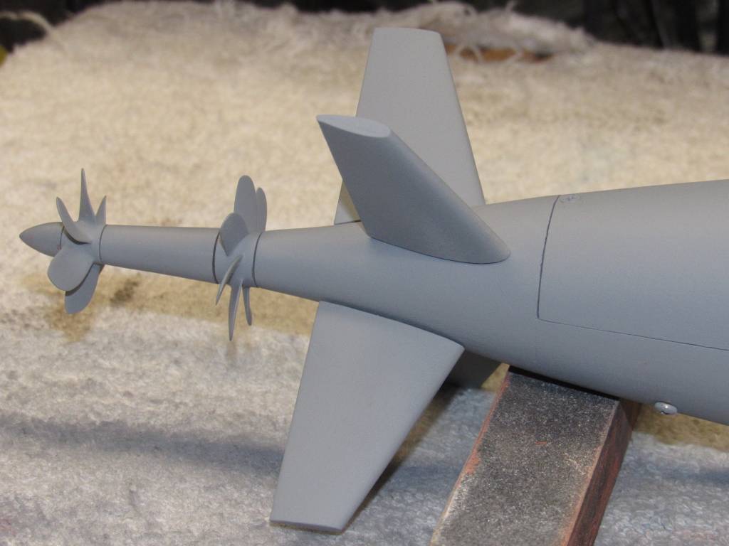

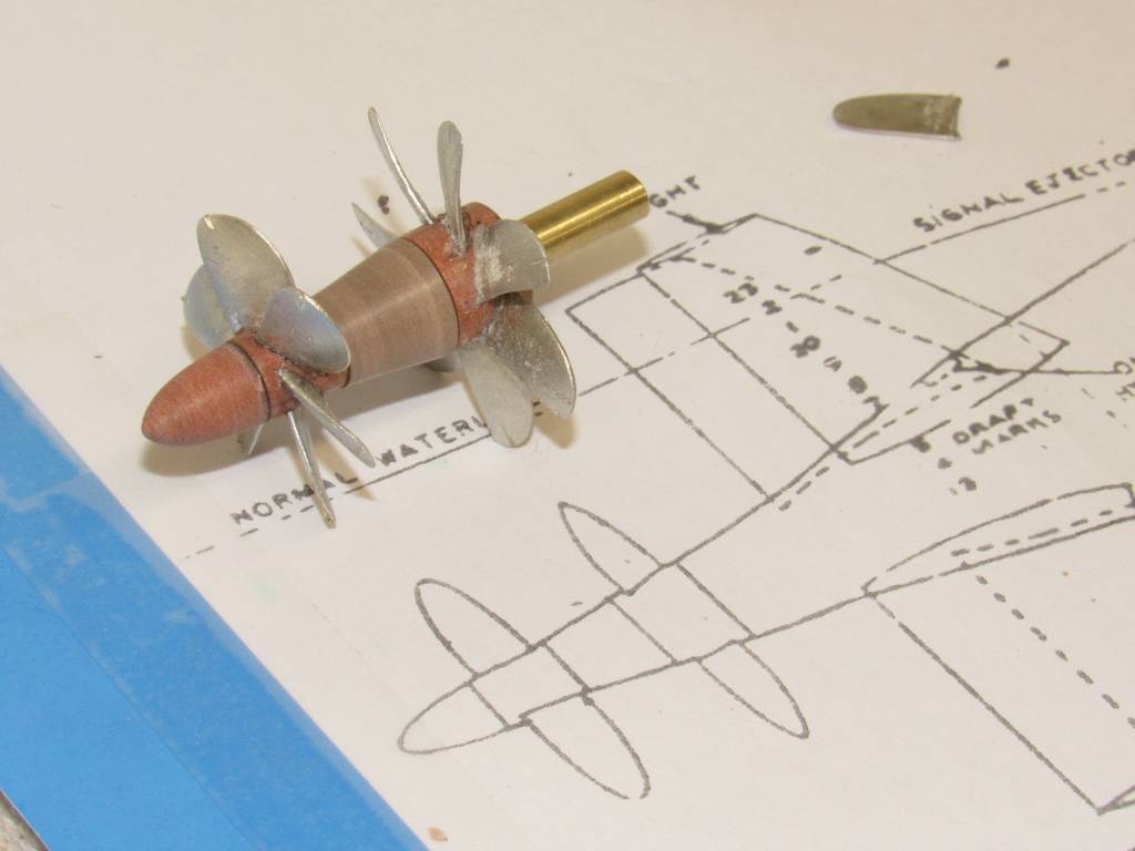

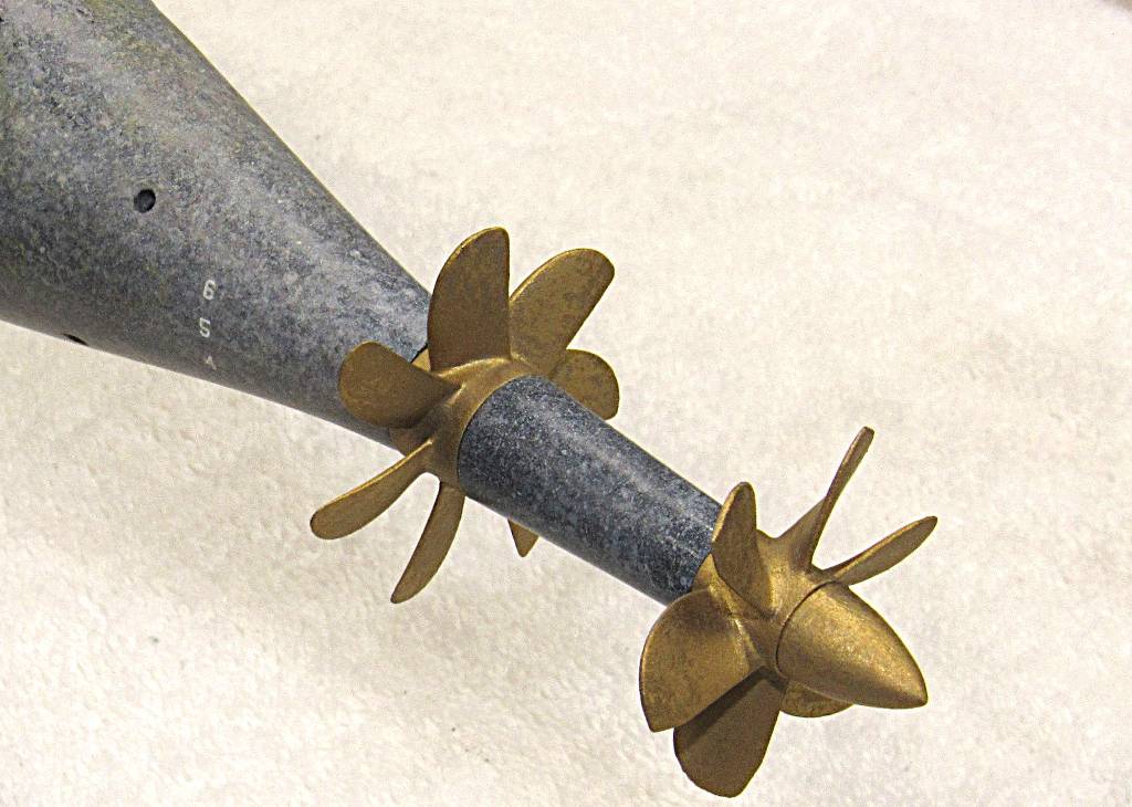

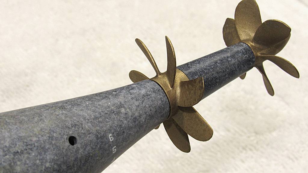

Most players are going to PJ's. Problem with them is their increased size (the duct) pushes the center of pressure so far aft of the c.g. that the boat is hard to maneuver in yaw; the boat, like a badminton cock, is overly dynamically stable.I mean the pumpjet "lampshade" on the aft end of 774s, 21s, and the British boats.

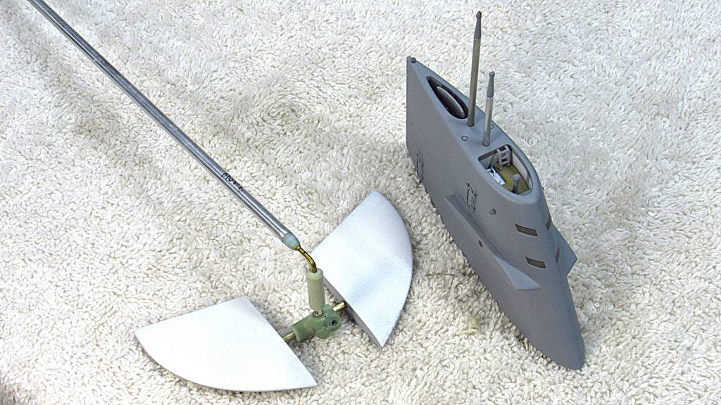

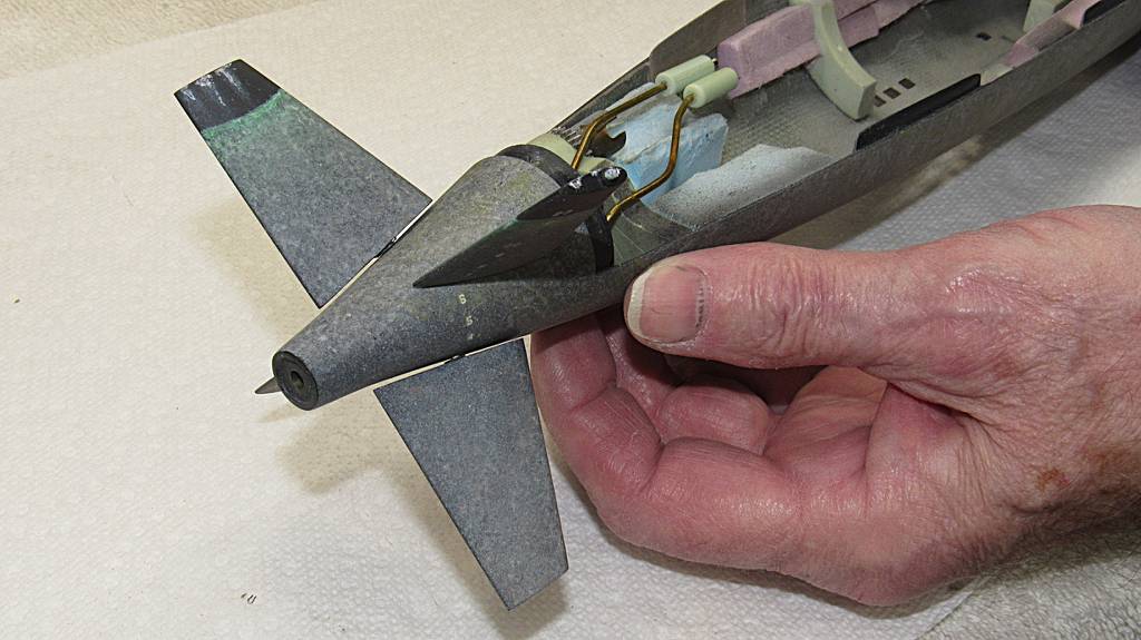

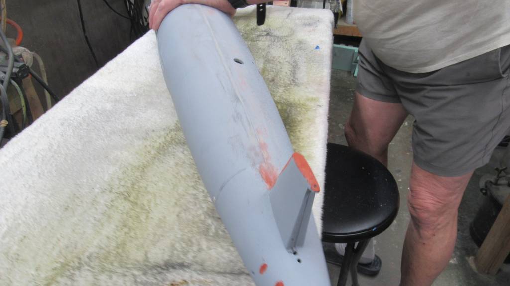

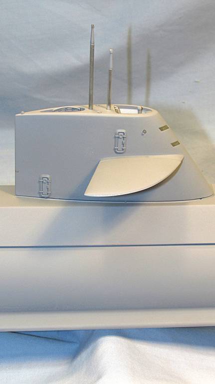

Yes it did. The dorsal 'rudder' on this 1/60th ALBACORE was practical, and as you can see there is very little heeling in tight u/w turns. Also a great 'break' and was part of the 'emergency stern plane jam recovery protocol' on the real boat.I'm blown away by the rudder on the sail. Did that work very well?
