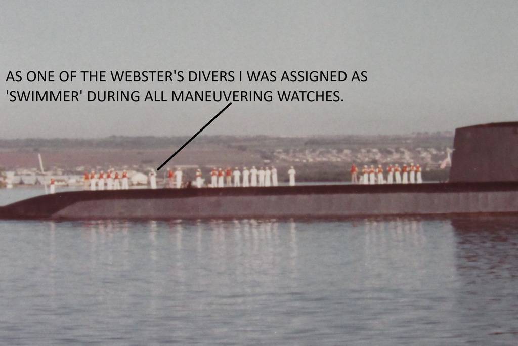

I got stuck as a linehandler... Something about being 6' and 220, wearing a 48 jumper top...
Lines weren't bad. But shore power was a killer. 450VDC power cables are about 150lbs/yard!

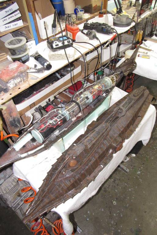

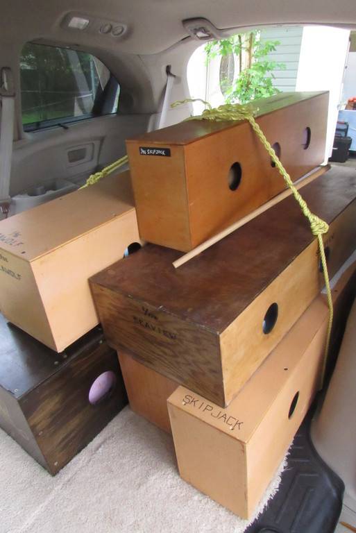

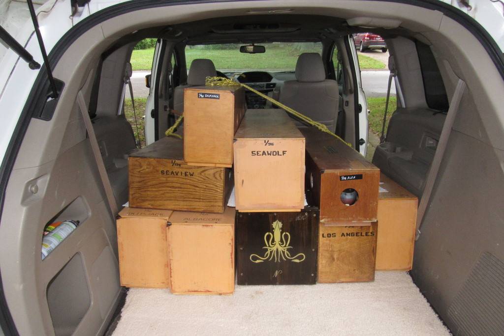

Just got back from the Georgia SubFest four-day all-submarine regatta.
Unpacked, and all boats post-missioned. Next event, about a month from now, is the NC, Rocky Mount, City Lake 'Fleet-Run'. An interesting event: just 1/96 scale ships and submarines. Should have at least four boats up and running for it.

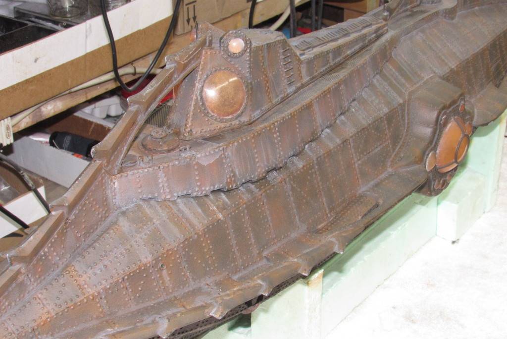

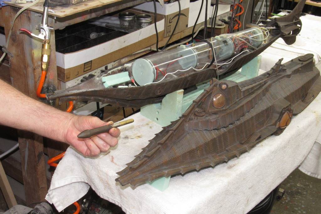

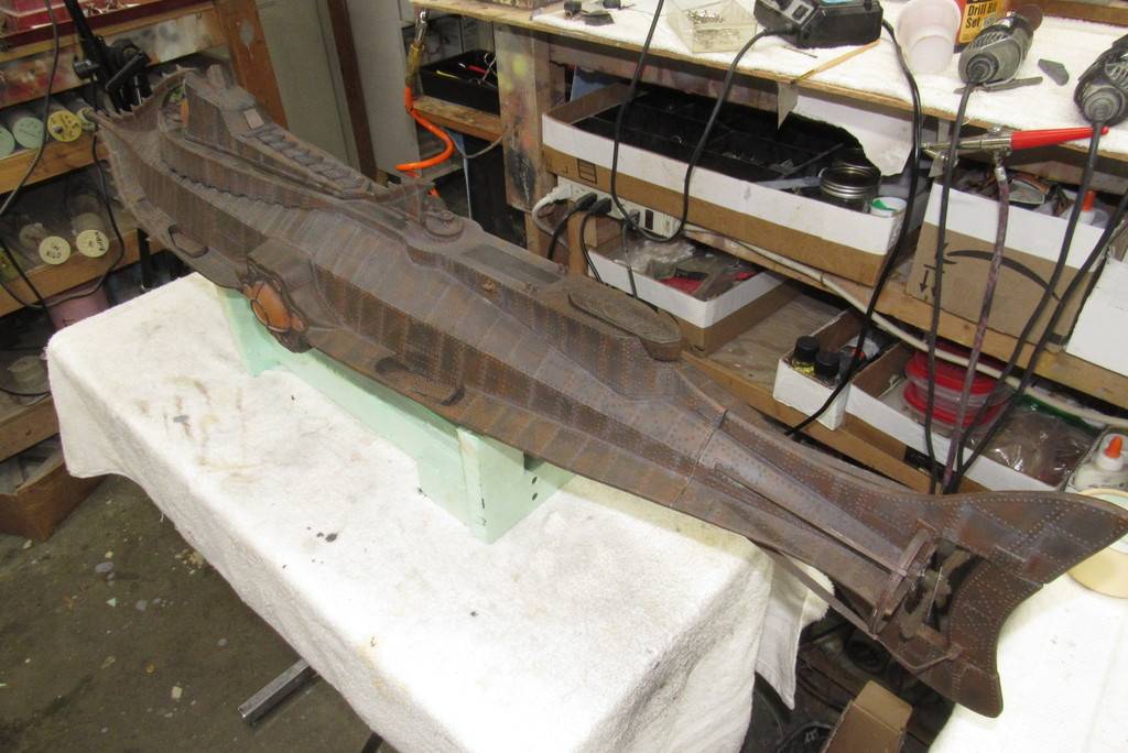

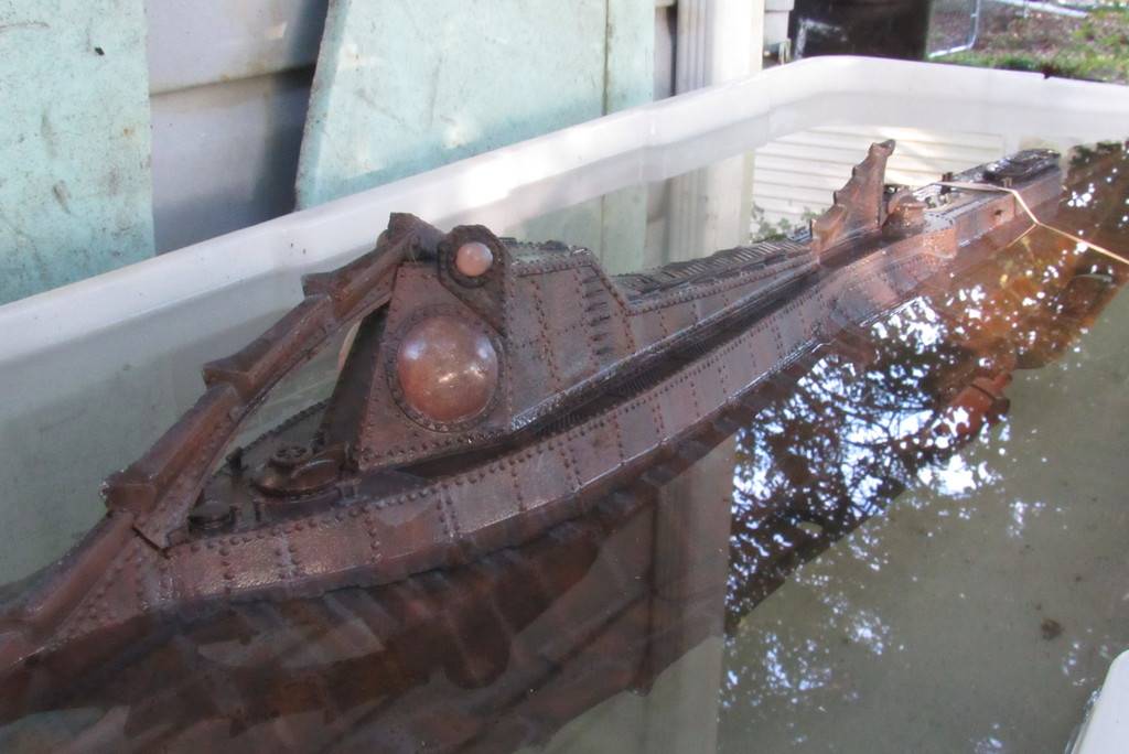

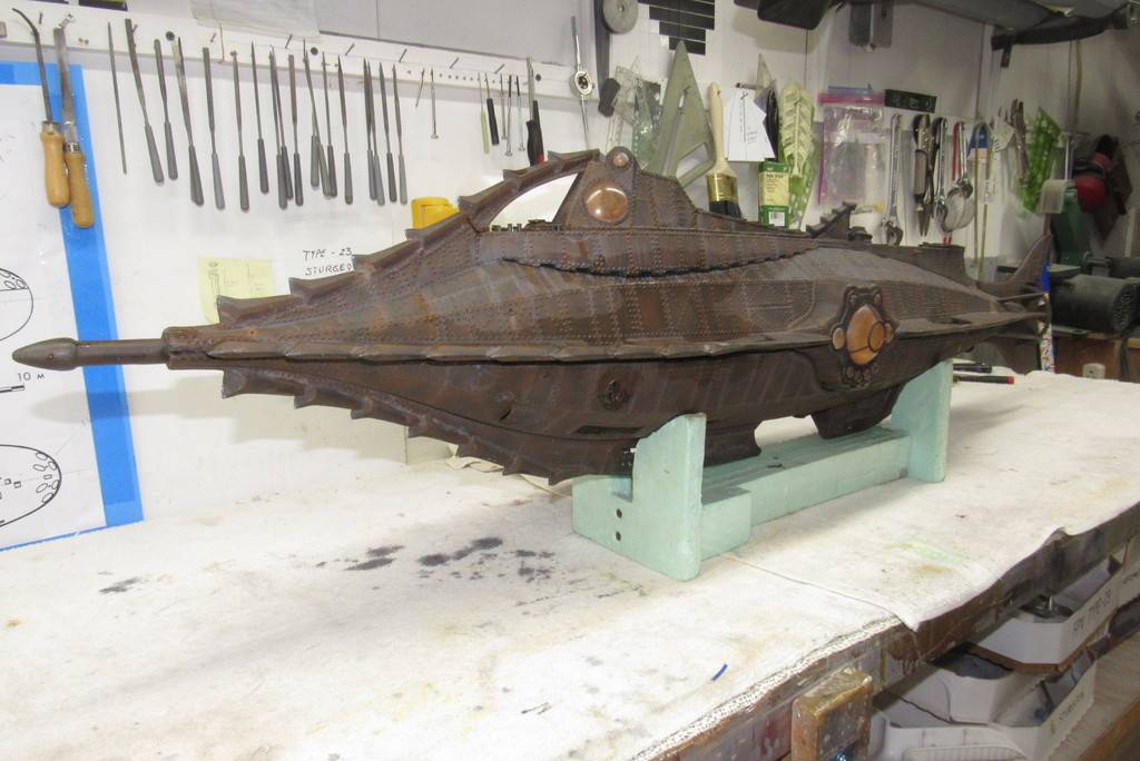

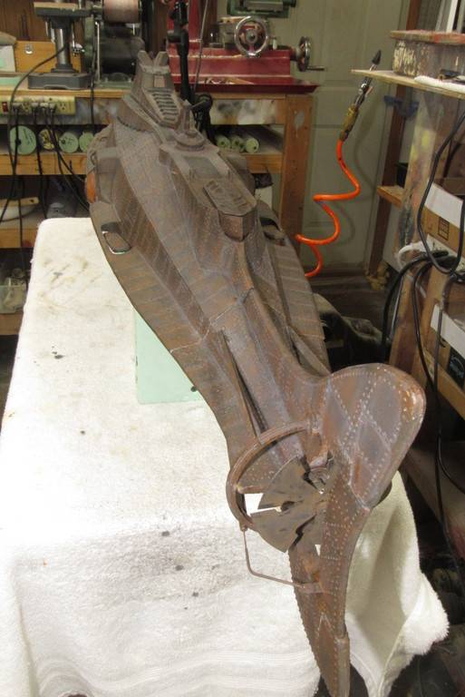

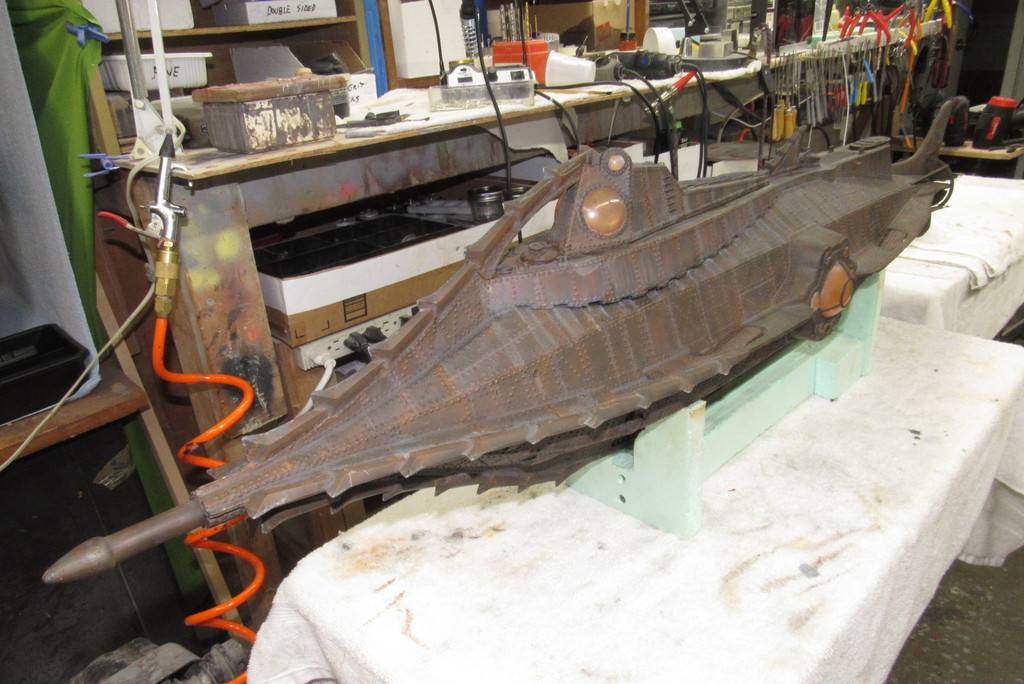

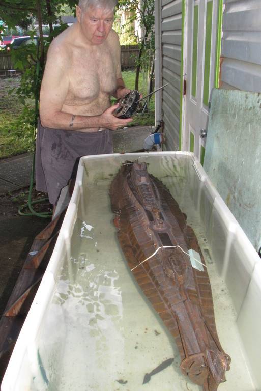

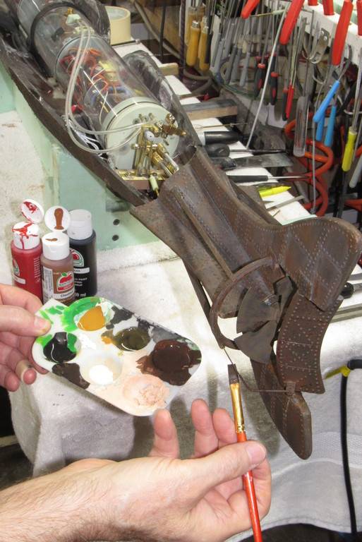

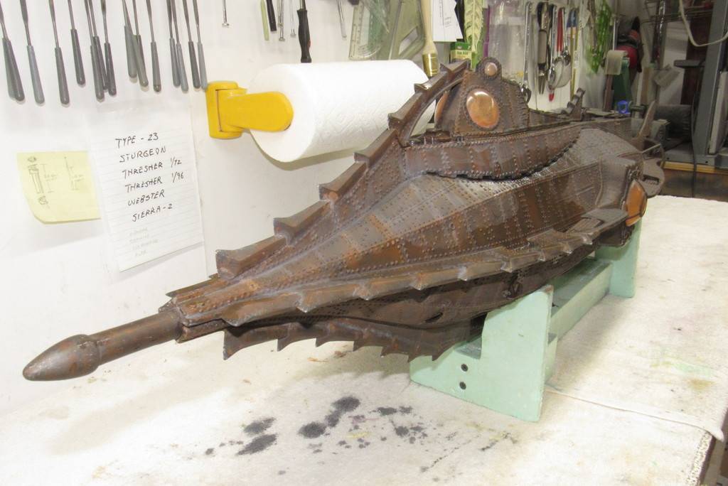

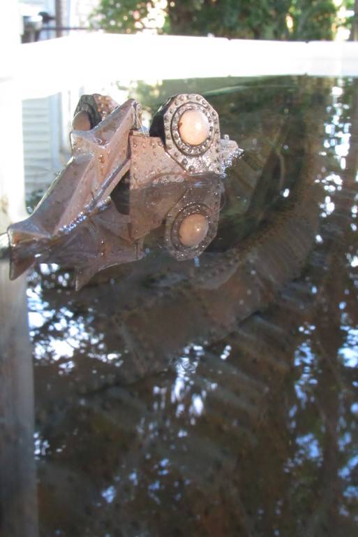

This Disney NAUTILUS was assembled by Dave 'Jake' Jacobs from a Ray Mason kit. We had little time to check it out for the event but were amazed and pleased to see it performing beautifully both on the surface and submerged!

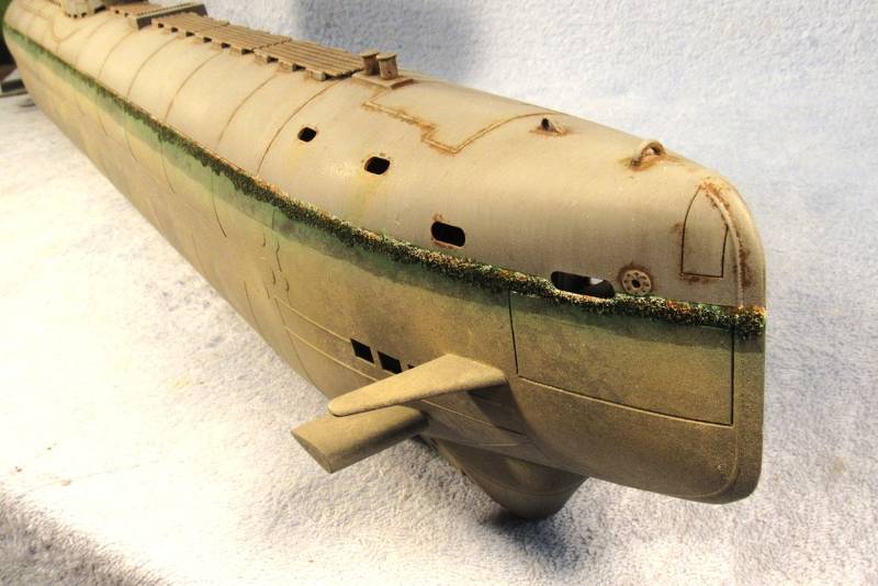

What's that side door for?
(Problem of being a 2000s submariner, never got to see the cool stuff from when we were still figuring out the optimum arrangements...)
All these cool pictures making me want to jump in and build a Barbel class even faster...
Torpedo ejection pump inlet doors (we called 'em 'barn doors') One for each side of the nest. Needed to balance the ejection pump piston on the inlet side as it discharged the water slug from the ejection side. The barn door is an artifact of the earlier hydraulic ejection type torpedo tubes. Barn doors, shutter doors, and Main Sea Water inlets were renowned husbandry diver eaters.

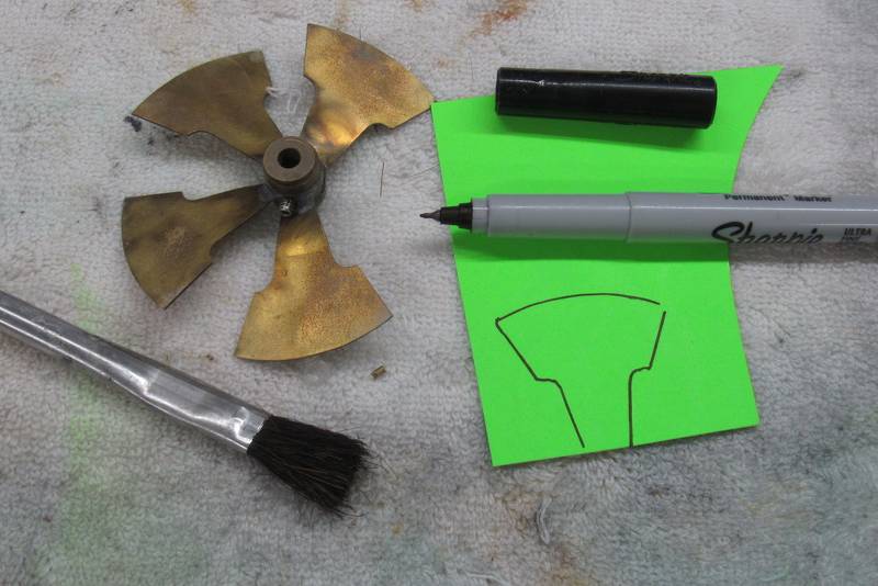

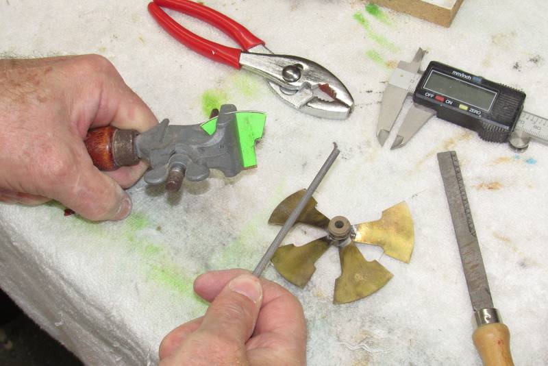

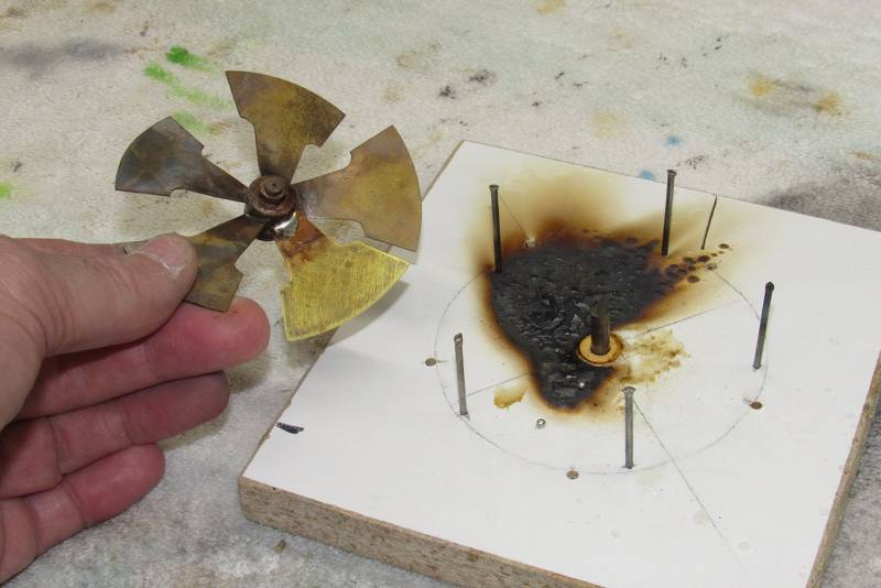

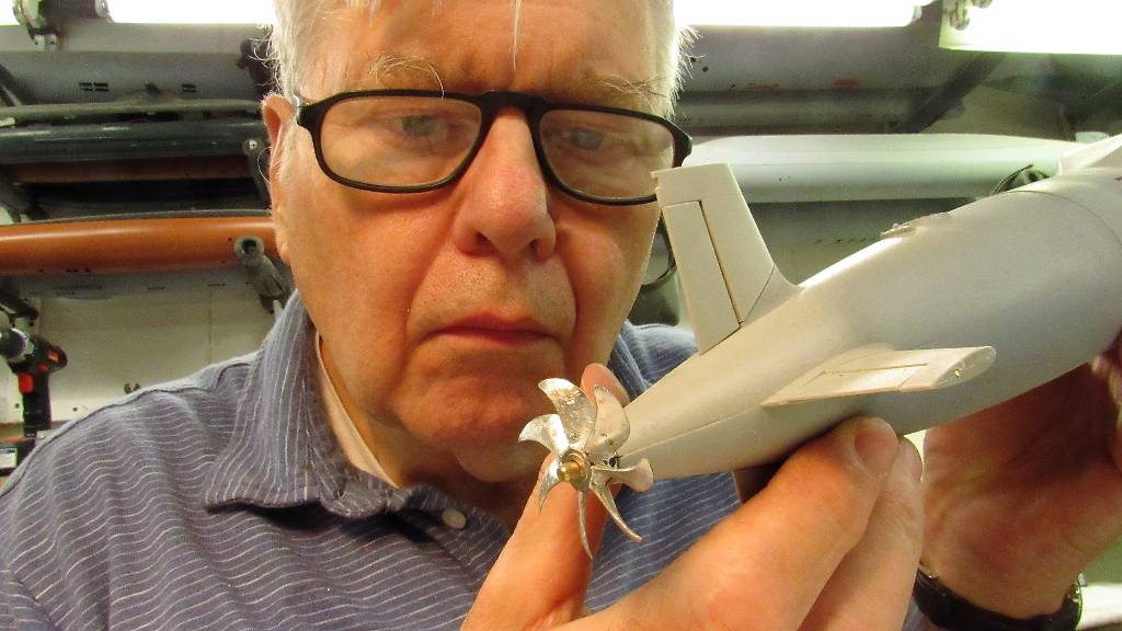

Ouch, lost a blade on the Nautilus screw?

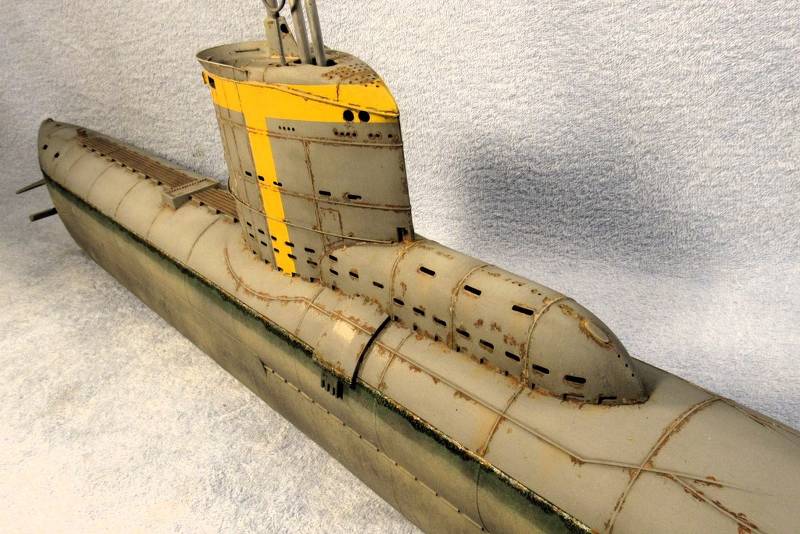

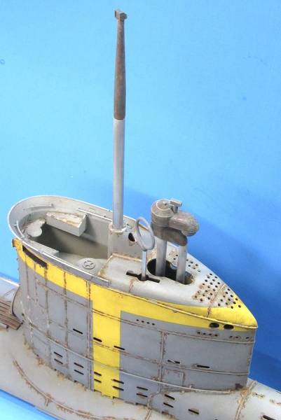

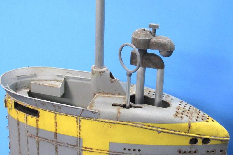

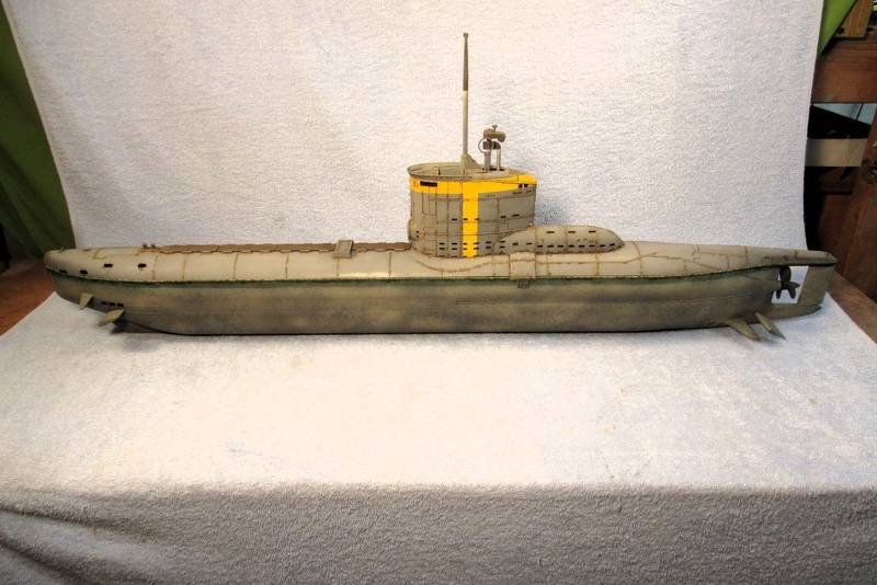

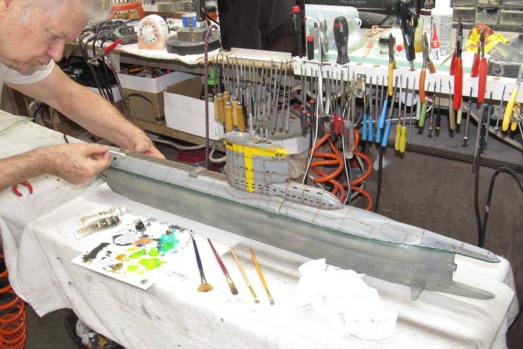

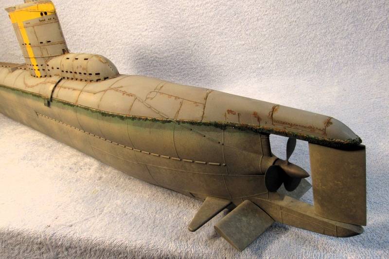

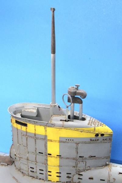

And every time I see that U-boat, I think of the poor Bosun who is about to have a heart attack from all the rust on it...
