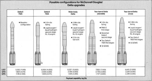

wat for a design B)
twin first stage !
nice find hesham
Very interesting. The Delta 7930 appears to be the forefather of Delta III, if you flatten the first-stage LOX tank to the same diameter as the upper stage.

Good catch. I must not have been looking close enough. Biggest difference between the wide-body sketch and the final D-III is the enlargement of everything from the LOX tank forward to 4m diameter.
Any info on the genesis of Delta IV? There's a natural progression from the Delta III upper stage to the Delta IV upper stage. The move to a hydrogen first stage was motivated by a desire to use the same fuels on both stages, but I don't know any more than that.
