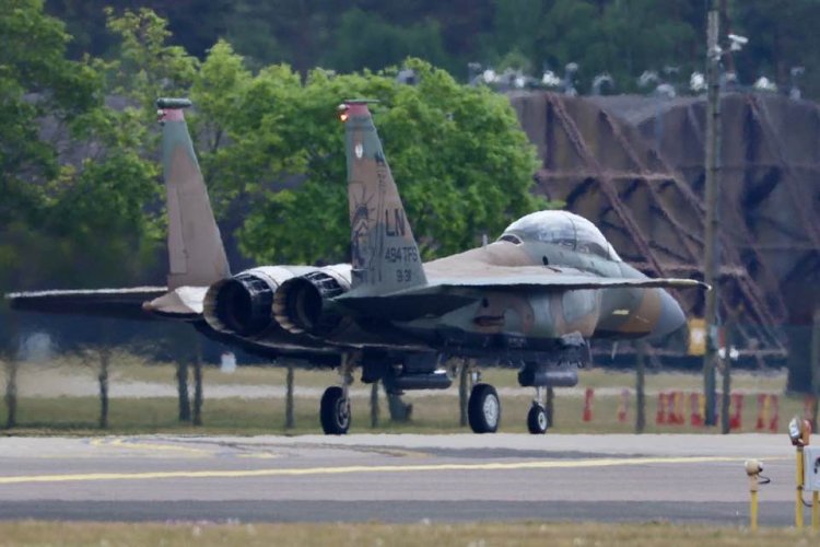

The USAF notionally has 119 -220 aircraft and 99 -229 aircraft although that was down to 96 after the friendly fire incident and I'm not sure which fleet the most recent shootdown was from. The USAF actually has, as combat capable aircraft it can draw from, only 133 F-15E aircraft, the CCTAI number, and 105 PMAI. You can see the respective breakdown here,
The most recent loss was an F-15E from the 494th FS (red markings), so a -229 jet.
