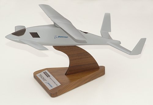

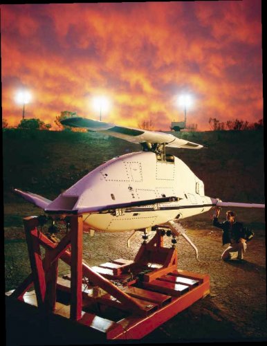

BTW, as we got beautiful pics from CammNut, probably I also can add something to pictorial history of so short-lived Dragonfly (X-50 pics are quite a few so far)

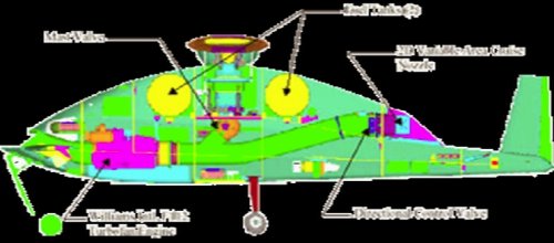

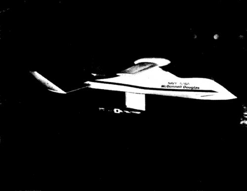

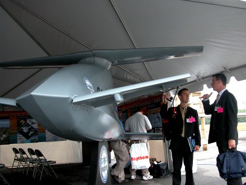

Some more - actually, with McDonnell Douglas roots - CRW concepts, plus Boeing's factory model of evolved X-50 from Chad Slattery collection.

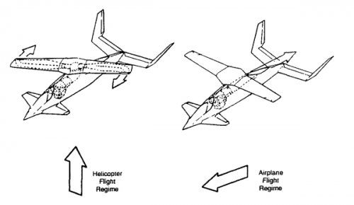

OK, we must always remember that CRW stuff started ca. 1993 in McDonnell Douglas shiny Phantom Works think tank. Here are two concepts, one of it - manned ground attack convertible - is a predecessor of cool artist's rendering shown several posts above, already under Boeing auspices. 1/5 WT model was intensively tested in NASA Ames
FIXED-WING PERFORMANCE PREDICTIONS OF THE CANARD ROTORWING CONCEPT BASED ON WIND TUNNEL TEST RESULTS
Steven M. Bass*, Thomas L. Thompson**, John W. Rutherford***
McDonnell Douglas Helicopter Systems
AIM-95-1887-CP

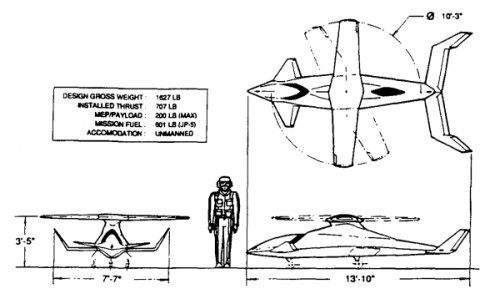

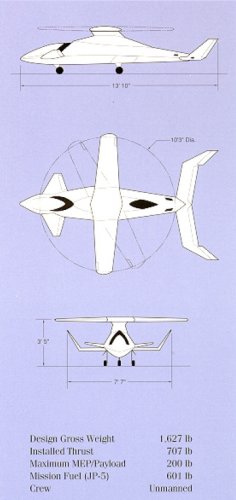

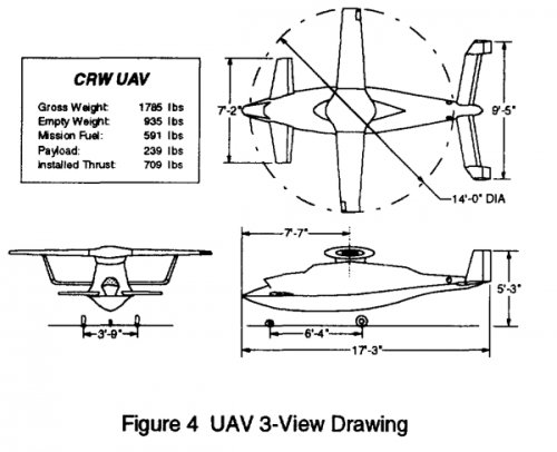

Another UAV CRW concept from Phantom Works (1993)
Canard Rotor/Wing: A Revolutionary High-speed Rotorcraft Concept
J. W. Rutherford, S. M. Bass, and S. D. Larsen
McDonnell Douglas Helicopter Company
AIAA 93-1175

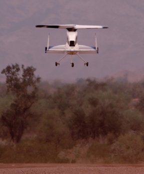

Nice X-50 photo
July 14, 2003 – unmanned aerial vehicle flight demonstration - Webster Field annex to Naval Air Station, Patuxent River.

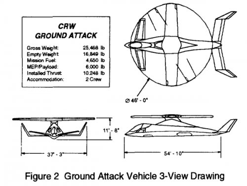

official Boeing's NAVY CRW 3-view

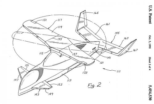

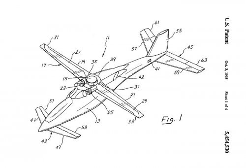

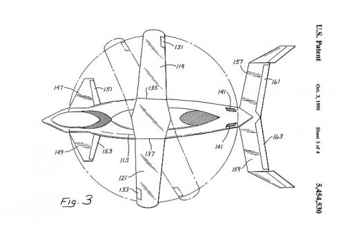

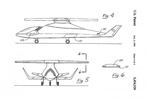

McDonnell Douglas - original patent of two CRW configurations from 1995
Interesting to compare to official 3-view in previous post

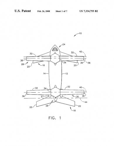

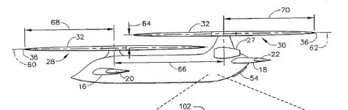

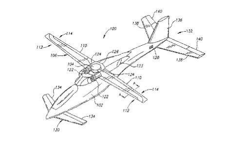

and now for something bigger...Boeing 2005 transport CRW patent
