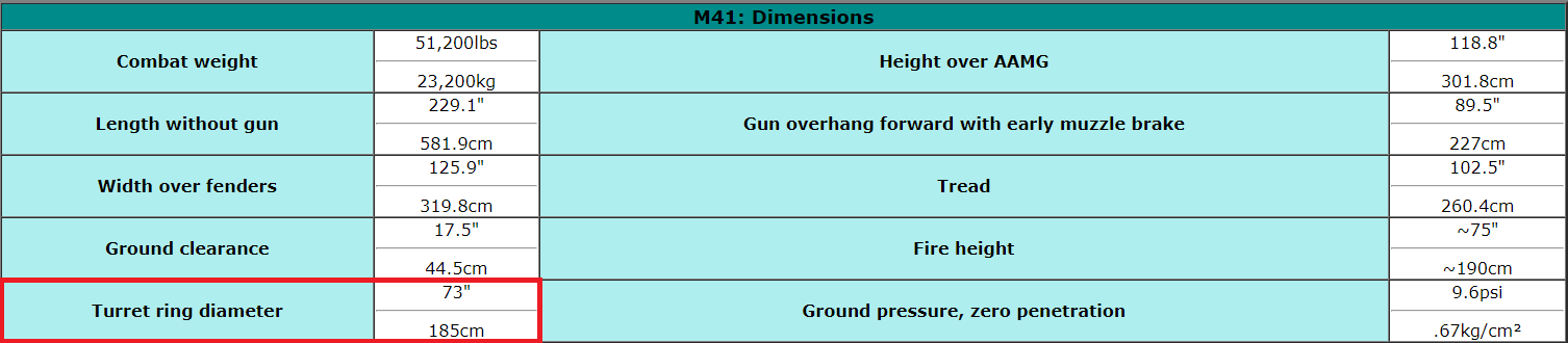

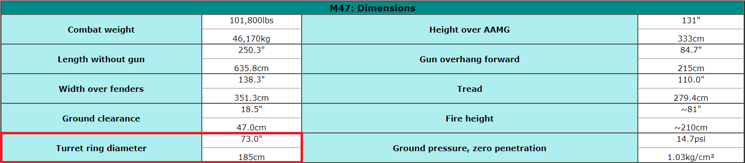

According to the American Fighting Vehicle Database (http://afvdb.50megs.com/), both the M41 Walker Bulldog and the M47 Patton shared the same turret ring diameter of 73.0 inches / 185.42 centimeters.
That got me thinking: Has there ever been any real-life proposals to retrofit the turret of the M47 Patton onto the M41 Walker Bulldog?

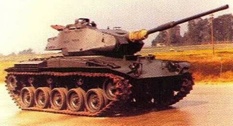

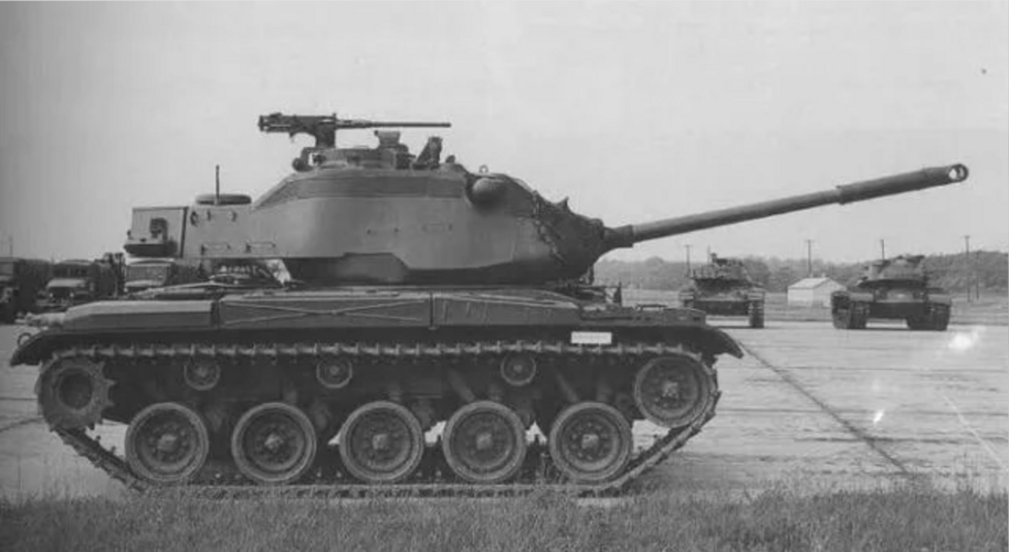

The M41 Walker Bulldog’s hull does seem capable of carrying turrets with larger guns such as the T49 light tank with the 90-mm T132E3 semi-smoothbore gun (TOP) and Cadillac Gage’s proposal to mount the Stingray light tank turret with the 105-mm L7 Low Recoil Force rifled gun (BOTTOM).
T49 Light Tank with 90-mm T132E3 Semi-Smoothbore Gun
M41 Walker Bulldog with 105-mm L7 Low Recoil Force Rifled Gun

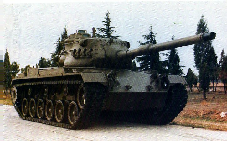

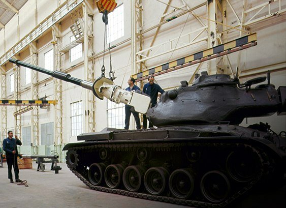

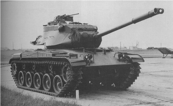

For the M47 Patton, its turret is also capable of being upgraded to house a 105-mm L/52 rifled tank gun. Italy’s OTO Melara had proposed and successfully tested fitting a Royal Ordnance L7 gun onto the M47 Patton’s turret (TOP). Spain had also done a similar conversion with its M47E2 armed with the Rheinmetall Rh-105-30 gun, which was essentially a German copy of the British L7 (BOTTOM).
OTO Melara M47 Patton with 105-mm L/52 Royal Ordnance L7 Rifled Gun
M47E2 with 105-mm L/52 Rheinmetall RH-105-30 Rifled Gun

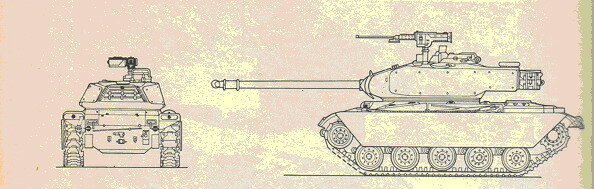

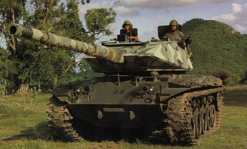

If balance and weight issues are too much to mount the M47 Patton's turret onto the M41 Walker Bulldog's hull, then perhaps the only practical firepower upgrade options would be to mount the Stingray light tank turret with the 105-mm L7 Low Recoil Force gun as was done in Thailand (top) or to retrofit the existing Walker Bulldog turret with the 60-mm High Velocity Medium Support gun as was experimented in Chile (bottom).

Another possibility is to mount the turret of the T49 (below) and swap out the 90-mm T132E3 for the 105-mm L7 / M68. This could require fitting a larger counterweight at the turret rear. The final turret design could resemble the M47's but with the M41's thinner armor (0.5" to 1.25") and thus lighter weight.
