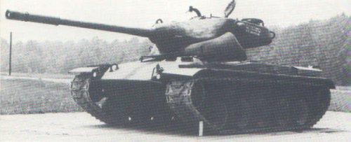

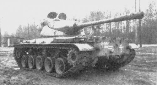

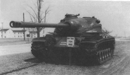

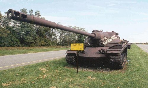

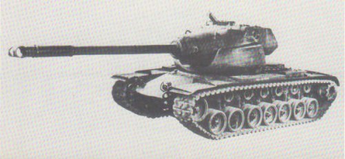

First in the T54E1 (frist image): used the M-48 chassis with an oscillating turret and a 105 mm gun. Turret was designed and built by United Shoes Manufacturing. This project was considered quite high priority, because a parrallel design without oscillating turret, the T54E2, was pursued: it had a 105 mm gun with a semi-automatic reloading system designed by Detroit Arsenal. Neither were series built.

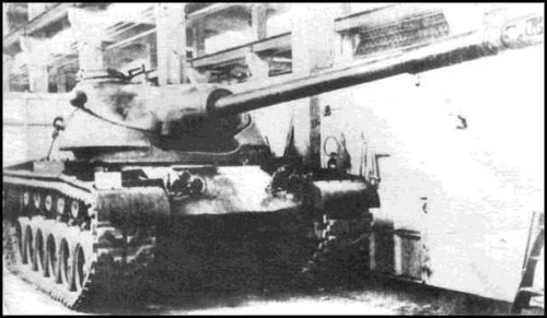

Second is the T57, based on the chassis of the T30 heavy tank with an oscillating turret and a 120 mm gun. I have only chasssi photo.

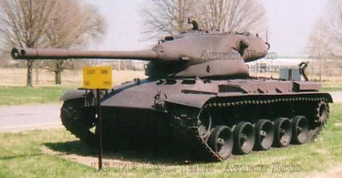

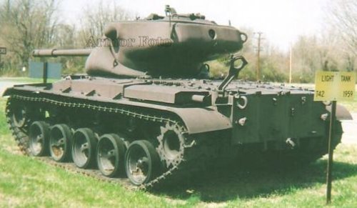

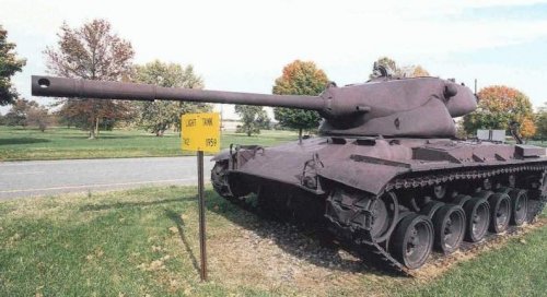

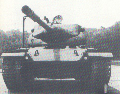

Third was a medium-to-light tank, based on the chassis of the T-42 (same as the M-42 one) and a 90 mm gun in an oscillating turret.

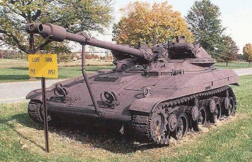

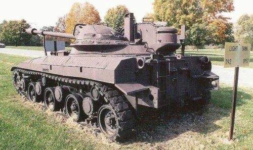

IIRC the T92 was a light tank for Airborn Forces. It did not have a oscillating turret but a cleft turret and also feature two sub turrets with 12.7mm HMG.
I'll agree JohnR about it being a light tank. According to the Presidio Press book on light tanks, it was successful but lost out when a change in concept/tactics required a tank that could float without any assistance, like a comparable Soviet light tank, and the basic Sheridan was adopted instead. Low=profile cleft turret, semi-automatic loader, and such worked well. I've got a few ideas for what could've been done with this concept for a medium tank, but those are for another forum.

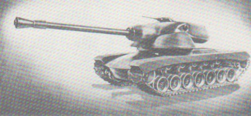

Some other photos
... and something about the T92 (correctly, this isn't a oscillating turret tank)

There is the T54E1 on the chassis from the M48 with a 105mm gun, there is also a mock-up on the same chassis called T77 with a 120mm gun.
There is also the T69 on the chassis from the T42 tank
These two tanks are described in the book Patton from hunnicutt.
The T57 you mentioned is not based on the chassis from the T30 tank but on those from the T43 the basis for the M103 heavy tank. That should correctly be armed with a 120mm gun.

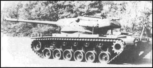

In the book firepower they speak also from the T58 tank on the chassis off the T43 tank armed with a 155 mm gun

here are my photos
first T69 and then T58

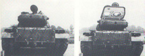

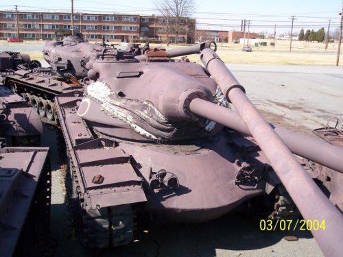

one more picture off the T54e1, dont know the whereabout of it but it gives you a good idea off the turret. Right behind it is the T30 heavy tank.
Could be, Aberdeen proving ground is big.
Maybe hidden treasures as in bovington museum. A location were they keep unrestored prototypes.

But i have two more off the T69 for you
