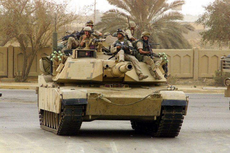

The mobility and logistics requirements of a 40 ton medium tank are essentially no different than a 55-ton main battle tank. What's an extra M978 when you already have tank transporters and Hercules recovery vehicles? The IBCTs would lose nothing and gain everything by simply having M1A1SAs organized into a separate tank company instead.
M1 last was a 55-ton tank 30 years ago.
Right now it's a 70t tank base.
