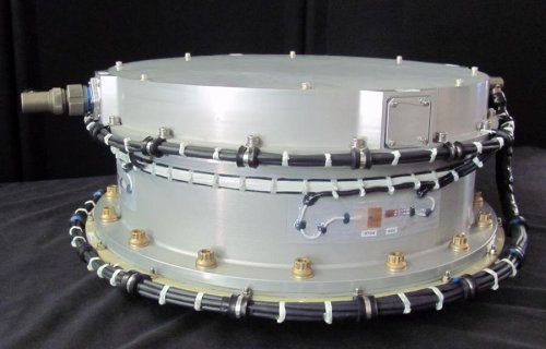

Developed by Lord and Sikorsky, under the Army Aviation Applied Technology Directorate’s (AATD) Active Rotor Component Demonstration program, the HMVS was flight-tested on a UH-60A Black Hawk. The HMVS comprises four brushless electric ring motors, each with an eccentric tungsten mass, in a housing atop the main rotor hub. One pair turns in the same direction as the rotor and the other pair in the opposite direction, but at four times the speed of the rotor.

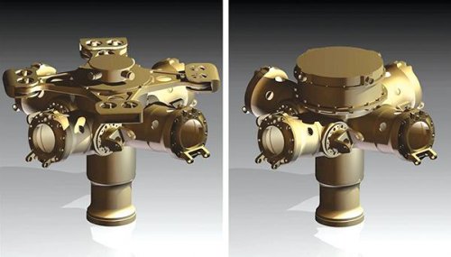

Flight test results were “as expected . . . we put the device on a UH-60A and got significantly lower vibration than the current bifilar [vibration absorber],” Welsh explains. Mounted atop the hub, the bifilar (left in photo) comprises dynamic masses on the ends of four arms that are tuned to absorb rotor vibrations. The HMVS (right) is 50 lb. lighter than the Black Hawk bifilar, and electrical power is supplied via the slip ring already used to power the rotor anti-icing system.

Lord HMVS. Photo courtesy of Sikorsky Aircraft
