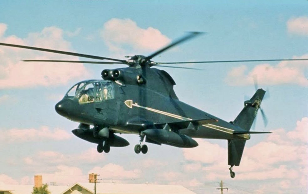

As some of you will know I inhabit a version of the 1970s where all my favourite stuff entered service.
One of these is the AH56 Cheyenne helicopter.
This machine looks futuristic even half a century later.
The AH64 and later versions of Army and Marine AH1 look tough. The Army has those flat, bullet-proof windows and the Marine AH1s look like they've been on the 'roids. This tough look is where they derive their coolness.
The Cheyanne looks fragile, particularly with its huge glasshouse canopy, not as if it would hang around to duke it out with the opposition.
Leaving aside my flippant remarks about the AH56s lack of coolness, IIUC it was badly specc'd for the roles it would be expected to undertake by the early 70s when it was expected to enter service. There was a perception, rightly or wrongly, that considered the AH56 akin to the USAF A10 and the USMC Harrier, meanwhile the emerging role of attack helicopters was that of anti-tank. The British undertook exercise Hell Tank in 1966 and 1967, and the US undertook a similar exercise in 1972. These showed low level tank hunting was effective whereas IIUC the AH56 flew fast (for a helicopter) at medium altitude and dived onto its targets, perfect for the SA-6/ZSU-23 combo to chop to pieces.

Leaving that aside, IIUC the AH56 was a bit of a dead end by the time it was ready for production. The attack helicopter version of the XB70 or XF108, in the respect that its requirements had been overtaken by events.

Cheyenne was IMO a real ground-breaker, with pusher prop to help out with speed and with sizable payload.
If it was developed further, indeed it would not been a long shot to update it with better armor, make it 2-engined, have it carry Hellfires etc.
The speed and sizable payload pushed the Cheyanne into the realm of fixed wing attack aircraft, which is why it got embroiled in arguments with the USAF over the role and with USAF and USMC over procurement budgets. This by itself isn't necessarily the end, but as early as 1966 it was being shown that helicopters flying Nap Of the Earth and firing ATGMs from behind trees at tanks was the future for attack helicopters, rather than flying at 200 knots higher up.
