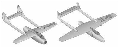

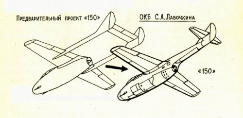

At http://www.aviastar.org/air/russia/la-150.php I read "The Lavochkin bureau's response to Yosif Stalin's order of February 1945 to design and build a single-seat jet fighter around a Junkers Jumo 004B turbojet, the La-150 was…". So, do you think the picture with both twin-boom "Predvarityelnii Proyekt La 150" (preliminary project La 150) and single-boom La 150 may be dated 1945?
Tophe,
By 1 Nov. 1944 prototype designstudies had been completed but
because of reasons beyound designers control neither Gu-VRD nor La-VRD
were built.
Krylya Rodiny March 1996.
Maybe the initial design "150" on the drawing stemms from the same period.
The small addition.
To beginning 1945 , Lavochkin's OKB/design-bureau already has completely moved in Moscow (plant 81)
Preliminary project La-150 (twn-booms) is dated February-March 1945,
"150"(single-boom) and "160" - an April 1945.
sources:"Planes of the world" 5.1997.
I have added on my web site
http://cmeunier.chez-alice.fr/update_FG.htm
the preliminary La 150 of 1945, completing the VRD of 1944. Thanks again.

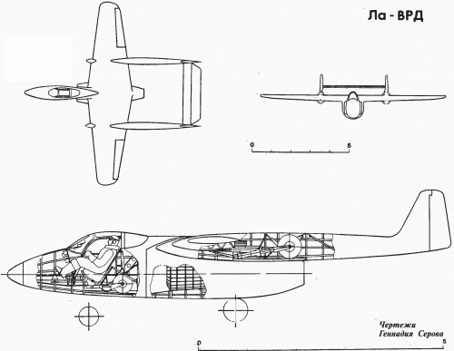

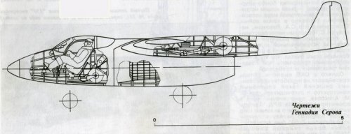

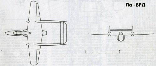

As was mentioned by Borovik. good article about La-VRD was published by G. Serov in the Russian magazine "Samolety Mira" #5-6 1997 (Airplanes of the World).
Here is a scheme from this article (the same as in Borovik's post but bigger)
