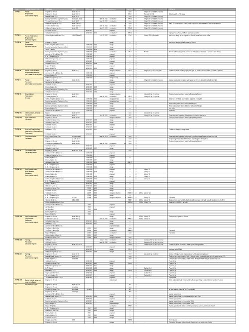

The Army Air Service/Army Air Corps/Army Air Force went through a rather long series of designation changes during its history.
The first of these was a "Type" designation based on the type and usage of each aircraft. I don't remember - nor do I have the time - to dig out the documents about when various changes took place although I do have them.
Attached is the first designation series by Type.
Enjoy.
Respectfully submitted,
AlanG
Wouldn't hurt much to mention that I'm the one who did that research and provided the file in the first place! Here is the PDF...
  • USAAS - Types I to XVI.pdf
Sorry, Stargazer!
I was actually sent that page by someone else with no attribution.
Nice work!!
AlanG

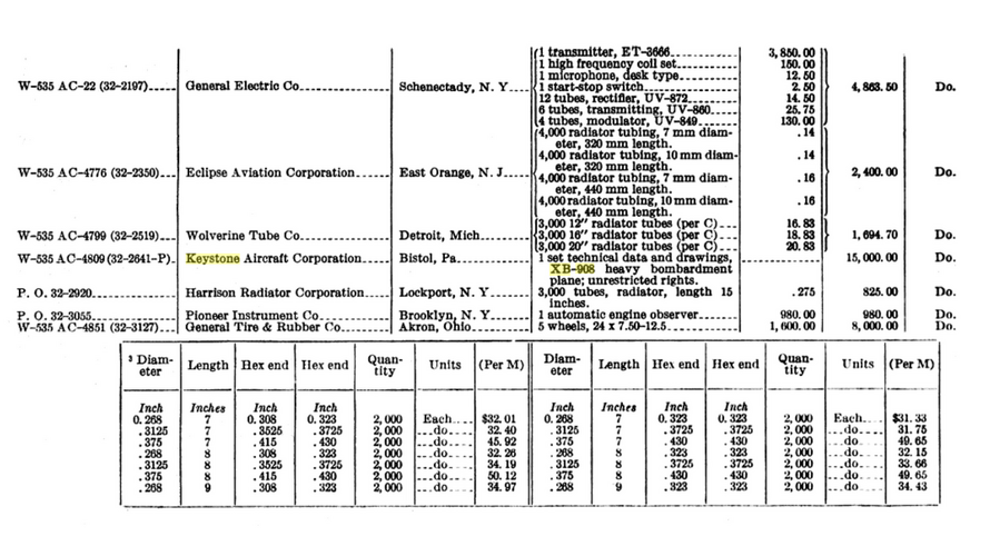

Mention of the USAAC contract for the Keystone XB-908 bomber design.
A mockup was later built, and the project also appears elsewhere as the "Curtiss-Keystone XB-908-A", suggesting some modification along the way.
