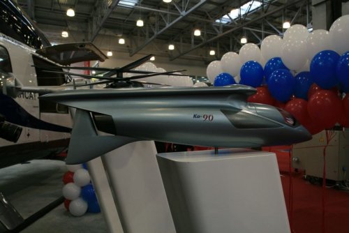

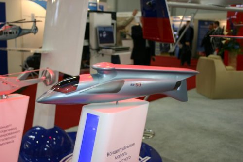

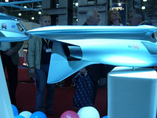

Top speed stated is up to 700 km/h, but it looks really as *concept*, just look at vertical tail right behind jet exaust.

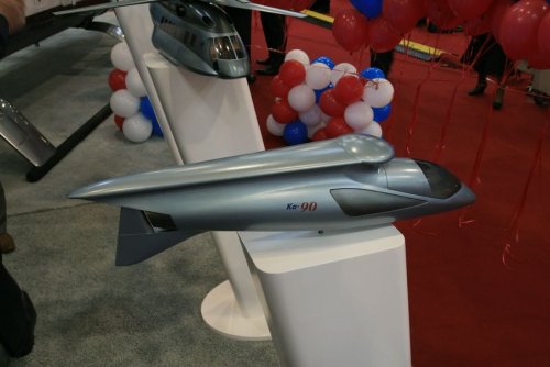

There were many extraordinary designs in the history of helicopter, but this is really breathtaking! Flateric, thanks for sharing this. :)
Thanks to Muxel actually. My pics much worse. Regarding design, I think it could be easily posted into CGI, What-If Art etc. section, not just because of futuristic look, but because this is real *concept*.
Just call me Ray said:
...but...how the heck does it fly with the rotors stowed? ???
It's already a submarine mode switched on :-X

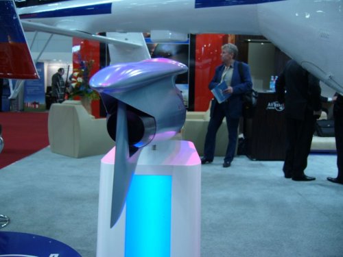

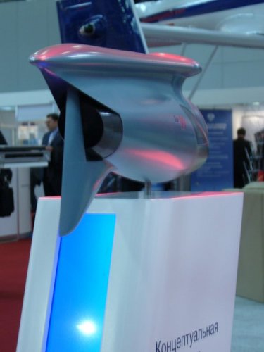

A good question. The stowed rotor is too narrow to call it 'wing area'. What's with the controls? Is the lower part of the tail going directly through the nozzle (-> Image_052.JPG)?
We have already been told, its really a submarine. The "stowed rotors" are in fact inside the... "hull" in order to propel the craft through the correct medium. ::)

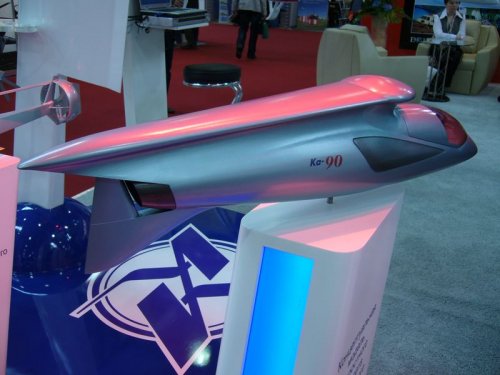

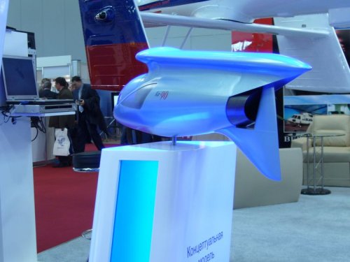

Can someone translate the Russian text on the exhibition pylon/stand?
Is it really a submarine? ???
It reminds very much of the Whispercraft from the movie "The 6th Day" with and the MASK toy I had as kid.
Guys, you need to be serious. *Concept* First of all, try to think of reasonable landing gear arrangement for the beauty.
'Conceptual model of helicopter-type high-speed vehicle Ka-90. Maximum speed over 700 km/h'

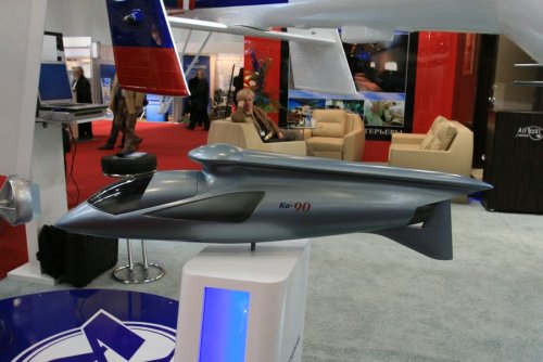

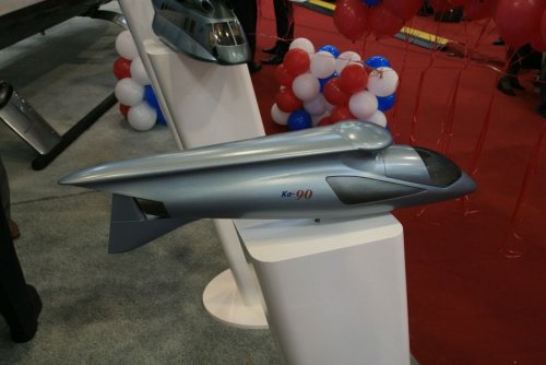

Would it be a safe assumption that the "swept rotors" become a two bladed thick chord rotor system for vertical flight? As to the landing gear I would assume the vertical stabilizer would grow a wheel or skid in time. Given the current size (assumed) I would have to postulate a retracting skid system for the forward landing gear.
The wing area could be similar to that, of the Bristol proposal for
a "VTOL fighter with very small wing", in this case it's just a very
low aspect ratio wing.

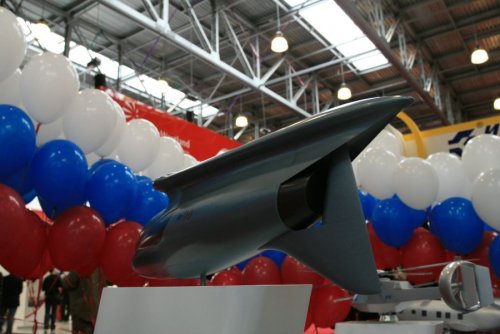

Strange, to my opinion is the fin directly behind the jet nozzle, a
position, that would give very high heat and accoustic loads and
I can see no benefit.
It's a *good* idea if you want to vector the exhaust to counter the torque of the rotor.
"It's a *good* idea "
Well, maybe, I still think, there would be other ways ...

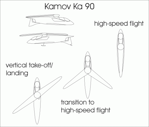

Just an attempt of a drawing. A broad chord twinbladed rotor stops during
transition (necessarily forming a straight wing ?) and sweeps back until
forming a wing with an indeed VERY small area.
Maybe we can hear the Kamov designer laughing, when he sees, what we
are making of his thoughts after some glasses of vodka ... ;D

Maybe. But note that it's got a big ol' turbojet exhaust, presumably to get to Ludicrous Speed. Sticking a vane in that exhaust would be easier than vectoring the exhaust, like on the F-35. It would also make the thing very responsive at high speeds. Sure, there's performance losses, and the materials issues are non-trivial, but hey. It looks cool.

Another good idea is a single wide-hord blade with a weight balance put at the other side.
Another publication says that on the 'back' it's just an container for folding blades that probably don't have such wide hord.
I'm just thinking of how can you secure yaw stability without empennage...may be some multi-axis NOTAR-like system?

I thought about the single bladed rotor idea, but here I really have no idea, how a transition could
be performed. With a two bladed rotor it would be "just" a VG aircraft with the slewed wing in an
extreme position, but as was said before "that has not yet been satisfactorily achieved or demonstrated"
