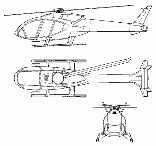

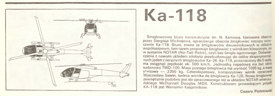

Provisional three-view drawing of Kamov Ka-118 five-seat helicopter.
Source: http://www.aviastar.org/helicopters_eng/ka-118.php

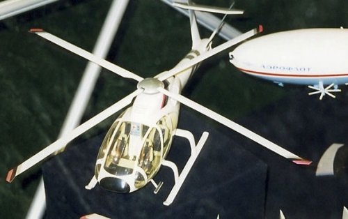

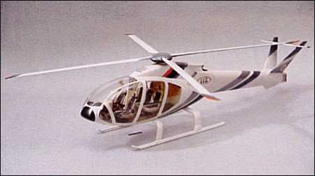

Model of Kamov Ka-118 helicopter.
Source: http://www.military.cz/russia/air/helicopters/Ka-118/ka118.htm

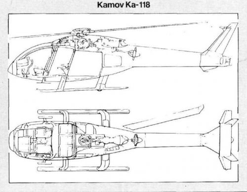

So, the Russians did build a Little Bird-type helicopter. Or at least they proposed one.

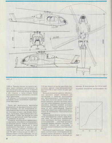

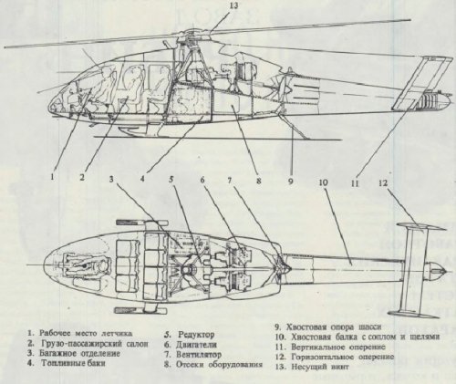

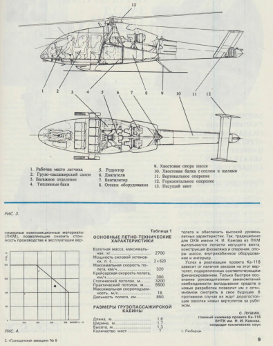

But it looks like the lack of appropriate domestic engines was still an issue (if I'm reading it correctly those are a pair of Pratt & Whitney Canada engines)?
https://soldat.pro/en/2018/07/04/ka-118/
