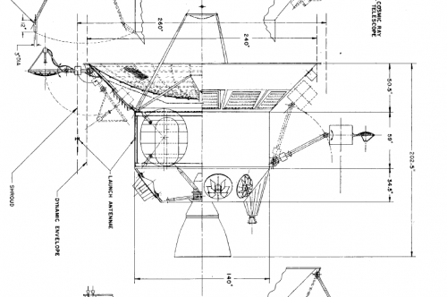

One of the more interesting results of the various NASA space engineering projects.
Designed by a team from the University of Auburn, this Saturn V launched probe, which would have been launched sometime between 1975 -1980 had it been built.

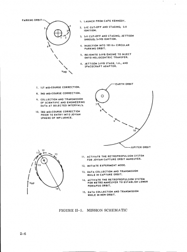

Upon arrival at Jupiter (After an 800-900 day trip, see the attached mission profile.) the 3.6 metric tonne orbiter would have entered an initial eliptical polar orbit with a perijove of no less than 7 Jupiter radii that following checkout would have been lowered to one with a perijove of around 4 Jupiter radii.
Keeping with the view at the time that the Jovian moons would be uninteresting 'dead' worlds the instrumentation fit (See below) was biased towards particle and fields detection. While cameras were fitted they were intended primarily to photograph Jupiter itself. Power was to be supplied by eight RTGs supplying a total of 640w.

The full two volume report can be downloaded below:
https://app.box.com/s/7wd95p24t97ru6dvwdw0

Concept wise yes. For a bit more context around the same period NASA was talking about the exploration of Jupiter along much the same lines as Mars, with pairs of spacecraft launched at every favorable launch opportunity. This design is one of a number of 'systems engineering' projects that NASA carried out in conjunction with various universities during the late 60s/early 70s. I've seen a Mars orbiter design from another such project which looks to be ancestral to the Mars Observer (Failed) & Mars Global Surveyor (Successful) missions in the 1990s.
