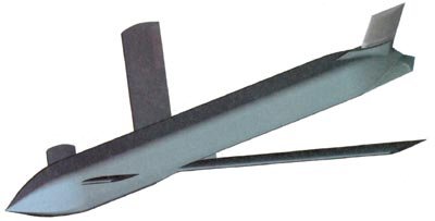

JASSM-XR (Extra Extended Range)
flateric
1 April 2006
10,730
6,773
JASSM-XR
The JASSM-XR is certainly a strange design compared to the standard JASSM especially with the Canards.

Anybody know any details about it's physical characteristics?
Just this one page. It doesn't give sources for this, though, so take with a grain of salt.
http://www.airvectors.net/avcruz_3.html
Lockheed Martin is now working on an improved wing design for the JASSM-ER that will "significantly" extend its range, though no details have been announced yet. The company has considered a "JASSM-XR (Extra Extended Range)" variant that would double the range again to over 1,600 kilometers (1,000 miles), but would only be carried on bombers and heavy strike aircraft. The JASSM-XR design would be stretched to 6.3 meters (20 feet 8 inches) and feature a fixed canard to ensure flight trim. At the other end of the scale, the company has considered a shortened variant, the "JASSM-SR", that could be carried in the internal weapons bays of stealthy strike aircraft.
Wait, here's the source, originally in Flight International. But it's from 2005, so that version of JASSM-XR might be quite different from the current one.
https://www.secretprojects.co.uk/forum/index.php/topic,6727.msg56825.html#msg56825
Development of the more than 1,850km-range XR cruise missile is continuing apace, with Lockheed revealing it began windtunnel testing last February with a 5% scale model of the JASSM derivative. With an overall length of 6.3m (20.8ft), compared with the JASSM-ER’s 4.2m, the XR features a fixed canard foreplane and folding main wing. The canard is required to ensure the single turbofan-powered missile maintains a stable flight profile and to compensate for the weight of the Lockheed-designed 540kg warhead. Bigum says the design “preserves the low observable characteristics that we have brought in from the JASSM, even with the canards”.
Detailed concept work began in early 2004 with the aim of providing an alternative means of engaging and destroying hardened and deeply buried targets, with the company-funded development now being pitched as a potential new-start USAF ACTD for fiscal year 2007. About 80% of the JASSM design’s electronics would be reapplied in the basic XR missile, although Pappafotis says the project provides an opportunity to explore alternative warheads, datalinks, non-co-operative target identification technology and precision guidance systems with reduced reliance on GPS. The missile would not use a terminal seeker under current concepts, instead receiving target updates from USAF Northrop E-8 JSTARS aircraft via datalink or satellite.
The weapon’s rocket-boosted penetrator warhead will have a velocity of about 2,300ft/s (700m/s), says Pappafotis, who adds that the charge will be “going in [at] better than Mach 2”. If fielded, the XR cruise missile would be carried by the USAF’s Northrop B-2 and Boeing B-52 bombers, which, respectively, could carry up to eight and four weapons internally and two and eight weapons externally. Boeing’s F-15 fighter is another possible candidate host platform, says Pappafotis, with the type viewed as a potential trials aircraft if the proposed ACTD gains approval.
If they ditched the fixed canard it would be a perfect Tomahawk replacement/complement in the Mk41 VLS. (Swap out the VL-ASROC Mk114 booster for the Tomahawk booster.)
It might be too long for Mk 41 -- 6.3 meters without booster is already as long as Tomahawk with its booster (~6.28 meters). The booster adds a bit over 0.7 meters, which would make JASSM-XR "Naval" close to 7 meters total. That's longer than SM-6 (6.6 meters) or any other inventory weapon. It's slightly shorter than the Mk 41's max canister length (7.18 meters) but there may be issues with internal clearances there.
