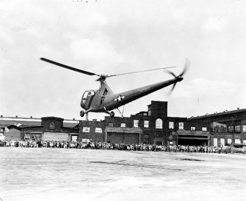

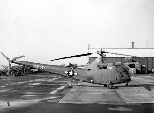

Attached photos are from SDASM archives;
Sikorsky XR-6A number 1 (43-28240) which might be the one originally ordered as XR-7.
Sikorsky XR-6 (43-47955) the only one with Lycoming O-435-7 engine.

Thanks to EEP1A for this information but I would be cautious to link the XR-7 to 43-28240.
I can see another scenario in which the XR-6A was originally intended to be fitted with the Lycoming engine and that 4 were ordered, along with a fifth with the Franklin engine ordered as XR-7. It was then found that the Lycoming engine somehow did not suit the XR-6 and -6A design and that the Franklin engine was chosen. That the Lycoming was not appropriate is probably the reason why the R-6B production version with Lycoming engines and to be built by Nash Kelvinator, was cancelled.
So, with the XR-6A to be completed with the Franklin engine there was no need foor the XR-7 designation and on 12 February 1943 the XR-7 was redesignated as XR-6A (that is fact, thanks to EEP1A).
Taking into account that, for instance 43-47953/47955 were - in a neat order YR-4B, XR-5, XR-6, it is possible that 43-28240/28244 were also in a neat order, ie 44-28240/28243 as XR-6A and 43-28244 as XR-7.
I have no foundation whatsoever for the above scenario and I could be totally wrong, but I present it as an alternative. The solution can only come (hopefully) when somebody inspects the formal records for aircraft with serials 43-28240/28244 and let us see on which record the XR-7 designation is crossed out.

Anyhow I believe that the external appearance of the XR-7 was identical to XR-6A (43-28240 to 244) because XR-7 was just redesignated to XR-6A.
