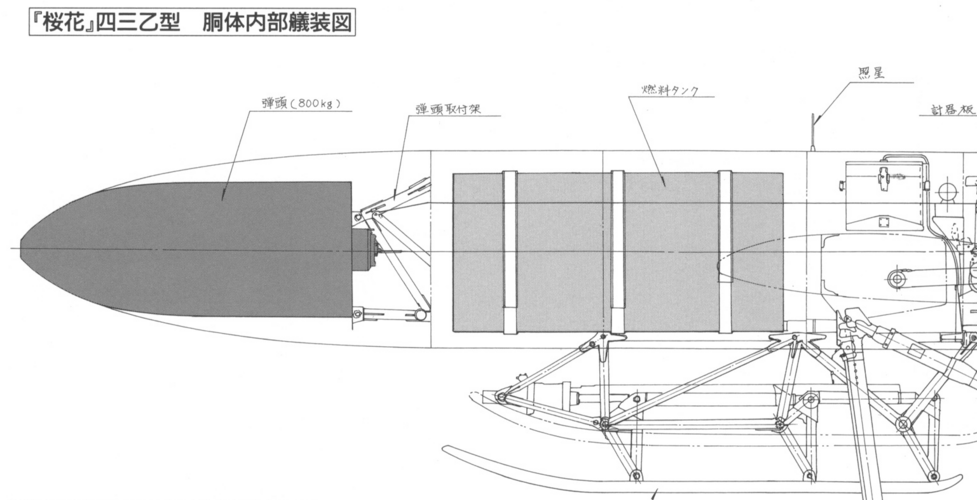

"The land version used the same warhead than the naval one but it was armed with two Type 3 machine guns of 13 mm with a rate of fire of 800 rpm located between the warhead and the fuel tank, which capacity had been reduced to 300 lt, and a combat range to 200 km. The guns configuration was inspired by the German air to air rocket bomber Sombold So 344 project and its objective was that the Ohka could break its way towards the Allies Task Forces fighting against the defensive fighters to which it was equal in speed. The ‘Otsu’ kept the mechanism to detach the wingtips of the naval version but was not considered a requirement to equip it with accelerator rockets for the terminal dive. It was expected that it would be able to surpass the 900 kph in a 50º dive with the Ne-20 at full throttle."
from https://www.secretprojects.co.uk/threads/japanese-jet-engines-of-wwii.34595/page-2
Describes a Model 43 version
"Ouka Model 43 Otsu" is purely a special attacker without any firearms. Despite being jet-powered, it's also very unlikely that it would have been similar in speed to contemporary Allied prop fighters. The suggestion that such a configuration was inspired by a German vehicle is baseless speculation...
