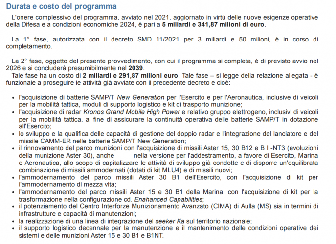

Minor update on the program now that the DPP 2025-27 is out.
Nothing new about about the arrangement of the ship, but compared to the last two years that have been slight decelerations of spending plans over time (though the program was fully funded in the last DPP), outlays ended up accelerating in the new DPP. Outlays in 2025 (we are supposed to get a contract by the end of the year) was upped to €53.3M (vs €40.4M in the last DPP) and outlays in 2026 are now pegged at €164.4M vs the previously projected €62.6M, and €305.8M in 2027. This strongly indicates they expect construction on the lead ship to begin in 2026.
Simultaneously, the expected timeline for spending across the entire €2.7bn program is now projected to stretch to 2036 rather than 2035 (which was the end date in every DPP since 2021), likely reflecting a general year long delay in the program - if they start production on the first ship in 2026 there is no way they will deliver it in 2029 as previously planned. I would expect the lead ship to be delivered in 2030 or 2031, though if the second starts production soon after (rather than with a two year gap) it may still enter service in 2031, or otherwise 2032?

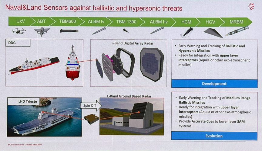

Looks like we have some additional news coming from Seafuture 2025 relating to DDX, specifically the air defense system.
The information repeated below was originally reported by Luca Peruzzi in European Defence Review.
In their presentation on Integrated Air & Missile Defense (IAMD), Leonardo reported that they had moved from feasibility and de-risking studies into active development of the new S-band radar system, which is to be an evolution of the Kronos Quad C-band system.
The development of the S-band radar system is associated with the need to counter longer-ranged, more complex threats including air-launched higher velocity ALBMs, Hypersonic missiles (both cruise missiles and glide vehicles) and MRBMs beyond those that can be effectively engaged with the existing systems (which, with the Aster 30 B1NT effector, is designed to deal with TBMs of a velocity that corresponds to ranges of ~1,300 km). The S-band array must handle early warning and tracking of such ballistic and hypersonic targets and integrate with upper layer interceptors such as Aquila or exo-atmospheric interceptors.

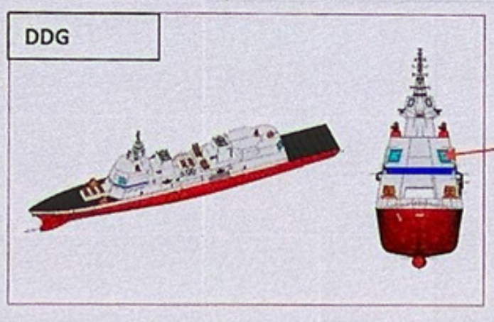

Attached is this graphic: 1761854283169.png
I will highlight the destroyer pictured here:
While not explicitly stated to be DDX, I think the inclusion is not exactly coincidental, and it does seem close enough to DDX to be worth commenting on. Notably, the former combination of a rotating L-band radar and Kronos Dual Band radar has been replaced by the four large S-band panels and the 'legacy' Kronos Starfire X-band system. It appears that we are still looking at 80x VLS (I assume each rectangle is still two modules across) and 8x canister-launched AShMs, but the 127/64LW seems to have been dropped while design retains 3x 76/62 Super Rapido, though now in the Strales mount rather than the Sovraponte previously featured on renders.

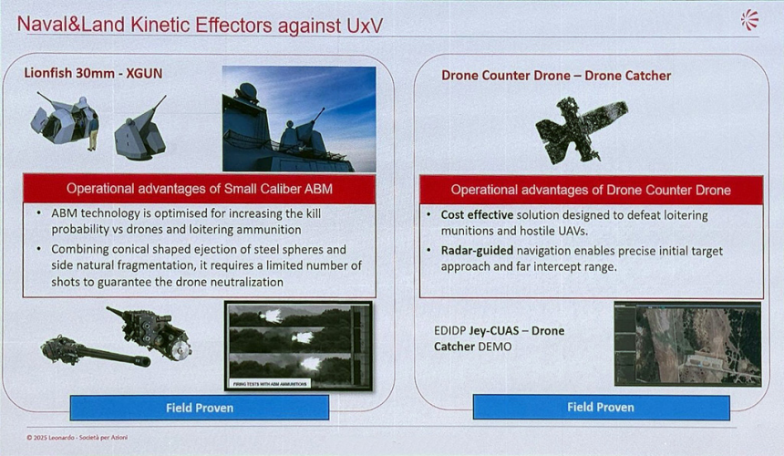

The article then goes on to address developments in C-UAS systems, both with the new 30mm gun system (the 'X-gun' in the Lionfish 30 RWS) as well as new DEW systems - both a laser weapon system (joint with MBDA) and an HPM system.
Leonardo and MBDA have apparently already conducted test fires with a 5 kW laser system for model validation, and are moving for a 100 kW laser for the initial test unit. DDX is intended to be the first unit to receive these systems (I'm not sure if that means the 100 kW type or a future system).
The HPM system (which they call an RF-DEW) is less mature, but identified as a more promising solution than the laser weapon system against drone 'swarms'. They make no comment on when/where it might appear.

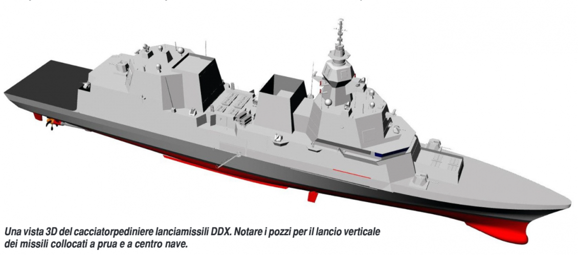

RID 02/2026 is out now and has a special 16-page article on Italian Navy programs by Michele Cosentino ('Marina Militare, programmi e futuro'), with some notable updates and new renders for the DDX.
The article reports DDX is presently just over 179 meters in length. Somewhat confusingly, the article reports full load displacement at 13,500 tonnes, but then also includes an editor's note that it could reach nearly 15,000 tonnes.
Edit: Correction on propulsion type:
I originally wrote that the propulsion system seems to have been simplified, but that is incorrect. It should still reflect the CODOGAL arrangement (as seen on the PPA), albeit now operating with more powerful diesel-alternators and electric motors than were described back in 2024.
In the quote box is a description of the propulsion system as of January 2024:
The propulsion system is a described as “CODOGAL” or ‘Combined Diesel Or Gas And eLectric.”
The two shafts can be driven either by electric motor (1.6 MW each), direct diesel drive (10 MW each), or gas turbine (32 MW each). The specific models to be used have not yet been chosen, but the basic principle is that electric motors will be used when there is a need to run quiet or at very low speeds, diesels for cruising (with a range of about 6,000 nmi at their maximum speed of 18 knots), and gas turbines for high speeds (30 knots). When the diesel or gas turbines are engaged, the electric motors act as generators to generate power, but there will also be four 2.7 MW diesels for a general base load (of 10.8 MW).
In the 2026 description, there are still two gas turbines mechanically connected to the propulsion shafts (though apparently a choice between the MT30 and LM2500+G4 is still to be made), along with two diesels (type is not described). The article reports an initial intend to use four 4 MW medium-speed diesel alternator groups (though apparently an alternative arrangement of six fast diesel alternator groups is also under consideration), which would provide a 'base' load of 16 MW. The design features two 3 MW electric motors on the shafts which, as on the FREMM-IT, are reversable and can be used to generate power when the gas turbines are in use. Overall, a 48% in power from the diesel-alternator groups and an 87.5% increase in the power of the electric motors. The DDX will use a direct current subgrid with the integration of a 'robust' Energy Storage System (ESS), in order to power equipment with high absorption peaks (radars, electronic attack systems, directed energy weapons).
RID confirms that the 127/64LW is no longer present on the design, and the three 76/62 mounts are now the 'normal' Davide/Strales mounts, rather than lightweight Sovraponte. The VLS count remains at 80 cells, though the allocations have flipped so there are now 32 cells forward and 48 cells amidships (for the first time since the 2022 renders, when the ships still had 64 VLS. It is interesting to note - and I may be reading too far into this - that RID no longer describes the type of VLS (whether A50 or A70) and instead only refers to '80 cells dedicated to air-missile defense and deep strike' (in totale di 80 celle dedicate all'IAMD e al deep strike). The deck-mounted missile armament remains at eight Teseo Mk.2/E.
Though the article does not address them in text, it is interesting to note that the render appears to show one 30mm Lionfish forward and two on the starboard side (one abreast the fore funnel, one on the edge of the helicopter hangar), which seems to indicate that there are four or possibly even five 30mm mounts in total.
The render also displays the new sensor suite, including the new large S-band member of the Kronos family. Though not discussed in this article, it is worth noting from other reporting that this radar (a GaN AESA) performs element-level beamforming, like the Kronos Power Shield (the L-band array previously featured on the design) - whereas the prior Kronos Quad (C-band) did sub-array beamforming. The Kronos Starfire arrays (X-band, GaAs) are positioned high up on the integrated foremast, along with the ESM arrays. I have not spotted the electronic attack arrays, but they are likely the new conformal models distributed around the ship (as on the FREMM-EVO).
Finally, RID reports that Leonardo is working on a new version of SADOC, possibly named SADOC 5, which will bring yet greater resiliency to cyber threats and making increasing use of AI.

I wonder how much Lionfish rcws adds to the role. It isn't primary goalkeeper asset(and not like it has RPM for certainties), but it has a declared AA/ciws capability.
Plus, as other similar guns, it should be highly accurate even at full RoF.
I mean, it's a 12.7mm MG on a remote mount. Any mount FCS adopted from ground forces would be as AA capable as a hand-swung .50cal.
That's because the Italians see the 76mm as the equivalent of the Phalanx CIWS.
I'm well aware. Though perhaps it is more accurate to say it succeeded the 40mm DARDO in the role of CIWS of choice for the Marina Militare. It actually replaced them 1:1 on the design of the Durand de la Penne-class DDGs, which in its original configuration would have mounted 3x2 40mm DARDO.
The Lionfish mounts (which are 30mm, not 12.7mm) are there as part of the C-UxV system, and replace the older 25mm KBA mounts (both manned and RWS) that existed on previous generations of Italian surface combatants. It is primarily there for defeating low-cost OWA (One-Way-Attack) UAS and loitering munitions in combination with the electronic warfare system, which is expected to be the most common threat - but also kamikaze USV's.
Which is not a rejection of the 76mm or 127mm as an anti-air weapon, so much as it frees them up to focus on other types of targets (particularly a concern in complex attacks) or range bands at further distances, while these systems can deal with these comparatively simple targets with extremely low costs. They do not serve an anti-missile function, as their rate of fire is far too low for that (200 rpm).

The Senate dossier for the multiyear program for procurement & realization for national missile & air defense (i.e. the grand umbrella under which all Aster related things are currently being organized in Italian defense programs) came out recently, and there are some interesting things popping up here beyond the already known acquisition programs for SAMP/T NG and integration of CAMM-ER into the system.
Aster 30 Block 0 it seems is a purely past-tense item, as the dossier now solely refers to MLU activities and procurement of new missiles for Aster 15, Aster 30 Block 1, and Aster 30 Block 1NT for the armed services.
It also refers to the modernization of the Navy Aster 15 and Aster 30 Block 1's, in addition to acquiring conversion kits for the "Enhanced Capabilities" versions of these missiles - a clear reference to Aster 15 EC at the very least, though I am also curious if this indicates some of the same modifications will be added to an updated version of the Aster 30 Block 1.
It also includes another ten years of logistics support, maintenance and upkeep for Aster missiles - Aster 15, Aster 30 Block 1, and Aster 30 Block 1NT.
Bearing that in mind, this seems to indicate that the Marina Militare is upgrading its Aster 30 Block 0 stockpiles to the Aster 30 Block 1 standard as part of their MLU activity, similar to what is presently being executed by the British under a contract modification to their Aster 30 MLU program. So this interceptor would be fielded across all Aster 30 capable ships (i.e. all FREMM, PPA, and DDGs).
This also seems to confirm a second future user of the Aster 15 EC beyond the Marine Nationale, which planned to introduce it into service around 2030 - first integrated onto Horizon-class destroyers Forbin and Chevalier Paul in their MLU (2028-2030), and Charles de Gaulle during her MLU. Presumably the first Italian ships that might have Aster 15 EC integrated might be their own Horizon-class destroyers Andrea Doria and Caio Duilio, during their own MLU program (2026-28) - though these come slightly earlier than their French siblings, and as such this might depend on whether Aster 15 EC is ready in time.
Either way, interesting implications. I don't know if we should expect the Marine Nationale to actually go through a similar process with Aster 30 Block 0 -> Block 1, if only because picture evidence suggests that they already switched to procuring Aster 30 Block 1 over Block 0's when they bought a second batch of 48 missiles for Alsace and Lorraine, and as such may have only ever had the 80x Aster 30 originally ordered for Forbin and Chevalier Paul back the 2000s. And who knows how much of that stockpile is left between exercises and operational expeditures?
