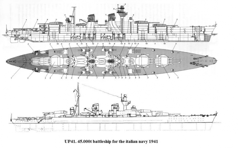

Returning back to the land of known facts - Stephen McLaughlin's article on UP.41 featured in Warship 2023 does include some information on the 406mm gun the Italians 'equipped' the design with.
This 406mm/50 was to fire a 950 kg shell at a muzzle velocity of 900 m/s, using a 342 kg propellant charge (in six bags). Maximum range was to be 41,000 meters, with a rate of fire of 2 rpm.
I personally don't think this should be taken as indicative of the intended performance of the Italian 406/50, as the shell is much too light to correspond to any Italian APC shell designs - even the lighter SAPC used as a secondary shells on the battleship guns. Like many things on UP.41, I suspect this is the Italians developing a design that they believed would better suit Soviet preferences - or at least what they thought the Soviets would prefer (ex, they included a 180mm secondary battery on UP.41, which is something the Soviets never seriously explored on their own battleship designs).
I would expect a heavier shell with a lower MV - more likely in the 1,050 to 1,100 kg range and a MV closer to 820-830 m/s.
