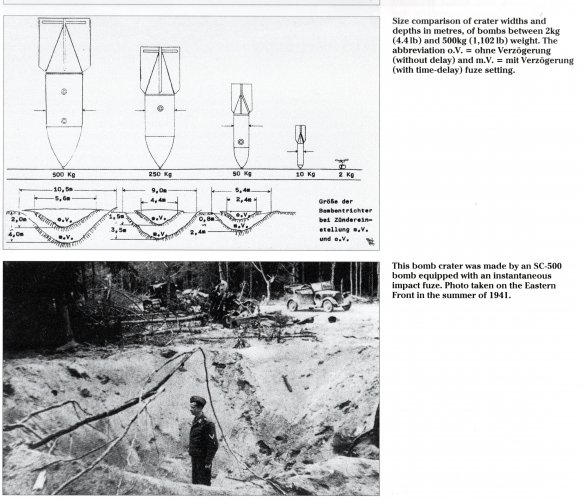

How deep is the crater? Looks like 4-5 meters deep.
That depth corresponds approximately to a free fall 500 kg standard bomb, but if the crater has been caused by a missile with high kinetic energy, the results of the impact are quite mediocre. Possibly the warhead used is quite small or was larger did not explode.

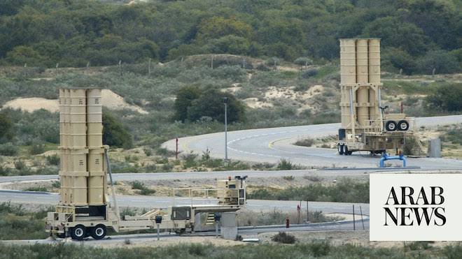

I see it can launch 8 and have some spare.

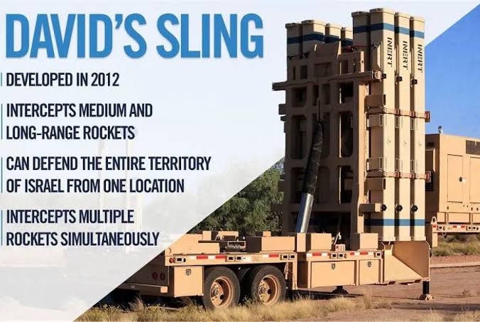

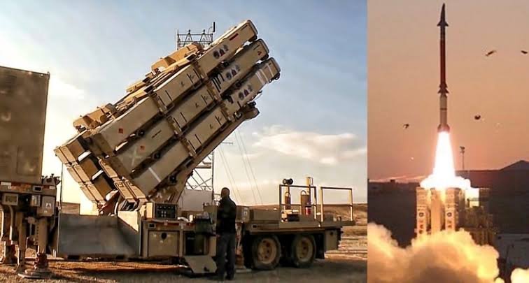

My bad, that's David's Sling. It's TELs are set up to carry 6-packs of the stunner missiles.
The Transporter Erector Launcher (TEL) is a mobile launcher unit mounted on a heavy-duty truck chassis. It carries multiple missile canisters, typically housing 6 to 12 Stunner interceptor missiles, which are launched vertically from their individual canisters.
But we were talking about Arrow which does deploy in 6 cannister TELs.
I think you went a little off track there. OP said it's THAAD because it's 8 missiles. I simply noted that THAAD isn't the only one capable of firing 8, and that David's Sling can do it too.

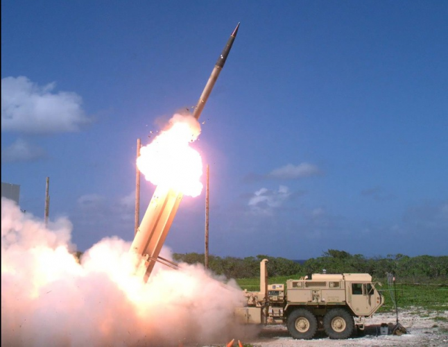

But then I also said that it IS a THAAD, because all Israeli ABM launchers are vertical, whereas the video shows an angled launch which matches THAAD.
On second thought it could also be a Patriot. I don't know if these were sent though.
Yes, you're right. The dangers of late night posting I'm afraid. The video does indeed appear to show 7 interceptors being launched, all at an angle consistent with the THAAD launcher.
Not sure about Israeli Patriots. The last I'd heard was that Israel had warehoused them after Iran's response back in October 2024, then donated them to Ukraine.
It seems unlikely THAAD missed 7 times on the same shot (or that it would even try to shoot the same missile 7 times).
Those weren't THAAD. Way too late in the game for THAAD. Not even obvious that those missiles are aimed at the one that came in (there were other visible targets going a different direction). Maybe PAC-2s.
