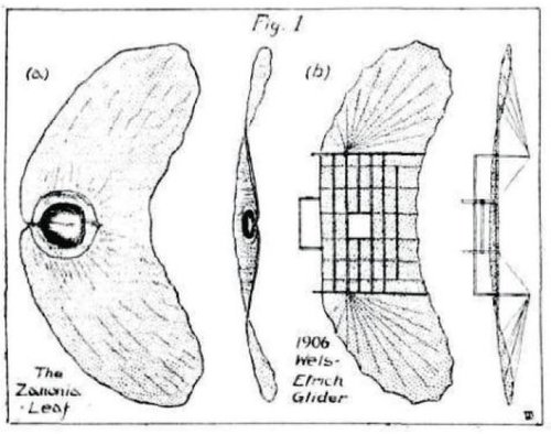

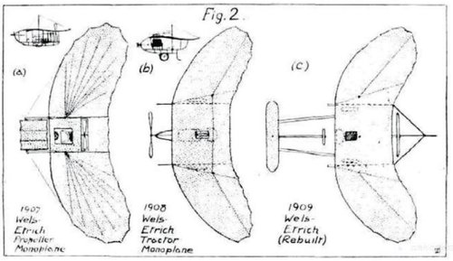

The Alsomitra Macrocarpa (aka the Zanonia Macrocarpa) seeds natural flying wings were the inspiration for Alexander Lippisch's and other German designers flying wings as well as the wing of the Taube.

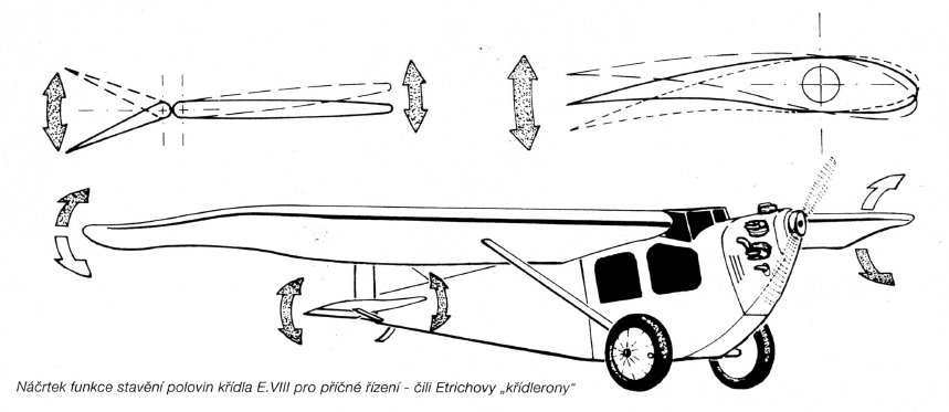

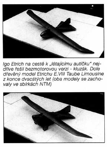

From L+K 5/17/1994;
On the way to the "flying toy car", Igo Etrich first solved a non-motorized version - a glider. Down
wooden model Etrich E.VIII Taube Limousine from the end of the twenties (both models have been
preserved in the NTM collections)

More in detail some interesting aspects: Heinrich Hertel-Structure Form and Movement.
