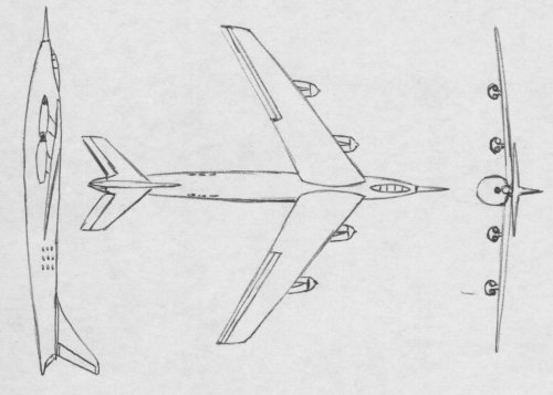

Hi Skybolt.
Yes, it not XB-52, but this drawing has been shown together with good figure XB-52
(Science et Vie).
There can be it there was one of projects of firm Boeing (on the basis of B-47 ?) or it was the project of other firm?
In what magazine this is shown "Fairchild giant flying wing taking off from rail"? (If it is possible, the name of magazine, year of release, number of magazine and pages ).
And if it is possible show us this Fairchild.
Orionblamblam
ACCESS: Above Top Secret
Apr 5, 2006
9,710
5,012
Both are *very* unlikely:
1: I have dozens of design iterations leading from the B-29 up to the XB-52, and while there are some very odd outliers (flying wings, for example), this design is not among them, nor does it resemble any of them.
2: The design shown is very amateurishly drawn, and appears to be nothing more than someone sketching the XB-52 from memory.
I could be wrong, but that's the way it looks.
Antonio
Moderator
Jan 22, 2006
3,695
613
I agree with Orion...to tell the truth it seems drawn by a child. I think this a fake. Devi can you the name of the source where you get this drawing?

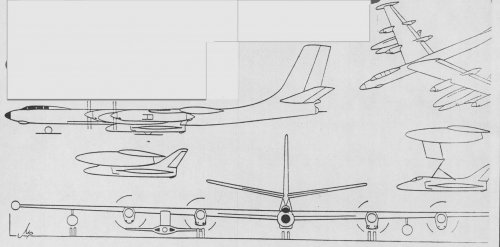

devi
ACCESS: Confidential
Jul 17, 2006
118
6
This is a Douglas Model D-1211J, one of competitor.
Skybolt
Jun 14, 2006
2,295
246
Devi, in case you didn't notice, you're making history! :eek:
Now: source??? ???
Skybolt
Jun 14, 2006
2,295
246
And I suppose the Skyrays under the wings are for some FICON project...

lark
Feb 17, 2006
1,813
132
The "XB-52" was shown in an article-Lettre d'Amerique- by L'Echo Des Ailes of 10 October 1950.
This article gave an overview of the American military aviation of that time and the drawing was based on rumours and the "bits" of information available....
Orionblamblam
Apr 5, 2006
9,710
5,012
OK, that explains it. Given that it's based on second-hand verbal descriptions, it's not far off. The fuselage *screams* "B-47," when in fact no serious Boeing study for the B-52 used a B-47-like fuselage (although at least one B-47 study used a truncated B-52 fuselage... goofy looking sucker). However, someone outside might well have assumed that Boeing's follow-on to the B-47 would use B-47 design elements in the fuselage.

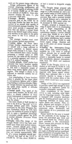

Quote from: devi on September 13, 2006, 09:56:57 am
This is driving me buggo. I *know* I've seen that before
Scott, what do you think of the Douglas design? Expecially the -J suffix, could mean there was a very definite lineage of designs of the same type, but to which purpose?

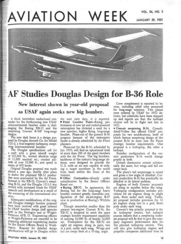

A two page article about the Douglas 1211-J was published in
Air Pictorial of February 1979.(page 60-61) under the title
"Little known U.S. bomber project may have influenced Russia's bear"
Peter J. Marson - Air Britain.
There should also be reference to this project in
Aviation Week for 29th January 1951.
Maybe Orionblam' have's something on this info...
Skybolt
Jun 14, 2006
2,295
246
I'll look in Aviation Week, hoping that ussue is not missing from the library :mad:

Skybolt
Jun 14, 2006
2,295
246
Gentlemen and gentlemen (no ladies here? Sigh :( )
TAAAA DAAAAA ;D
elmayerle
Jan 8, 2006
1,488
401
That Douglas design sure resembles a bomber derivative of the wings, engines, and tail surfaces of the XC-132 - though the evolution may have been the other way.
Skybolt
Jun 14, 2006
2,295
246
Probably. The 1211-J had been officially presented a year before it appeared in the AV article, during the Jan 1950 Conference already mentioned. It must have been concieved during 1949, if not earlier. I don't know when the XC-132 project cycle began, but Ithink later than that. What is intriguing in the Douglas design is the suffix. I mean, the -J must be there for some purpose. I initially thought it stands for "Jet", to indicate an evolution from an earlier reciprocating engine version. But a "T" for turboprop would have been more suited. ??? Douglas was nonetheless serious about the proposal, they even devised a scheme to to a "all-Douglas-made" FICON, with Skyrays instead of F-84s...
