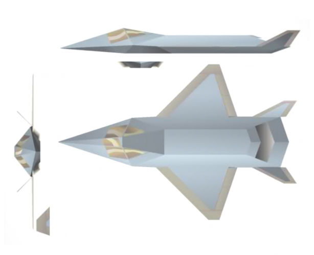

There was a user named "Planeman" in the original Key Publishing thread that had some drawings of his small "pocket stealth" designs.
The images disappeared when the image host collapsed, does anyone have them saved? Attached is all I have of his.
