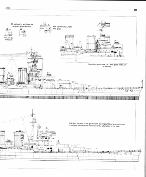

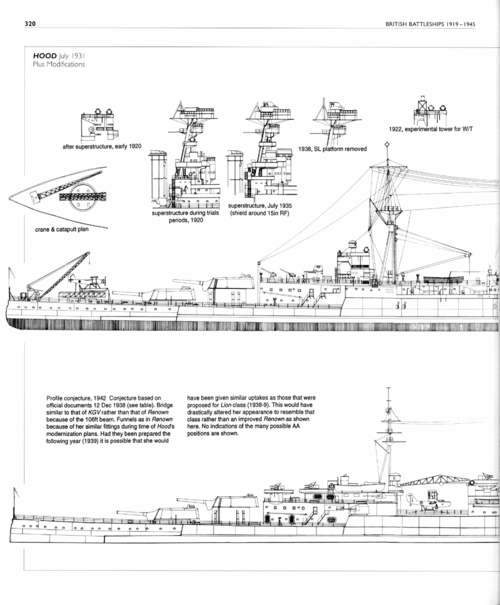

Does anyone know what the displacement of this modernized HMS Hood would have been at full load?

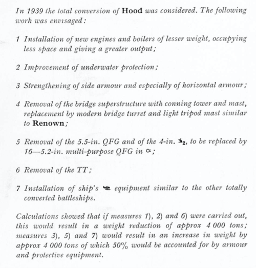

I think any reconstruction would have been a tricky job to plan well given the constraints offered by the hull.
The quarterdeck wetness and topweight issues were certainly two big problems, but so was the provision of adequate DP armament. Fitting 5.25in mounts seems almost impossible without re-arranging some internal spaces and the trunks would need to puncture the strength deck and that could have caused other hull strength problems (shades of HMS London's reconstruction). Ship's generally gained weight during the war and none of the 1938-39 weight estimates cover later war additions (splinter protection, extensive wiring, extra generators, degaussing gear, radars, light AA, additional crew accomodation etc.) that would have been likely in practice.
Even the 1939 plans are a wish list and in truth they probably had another 12-18 months to do more detailed studies to have the plans ready for the dockyard before she was docked in 1942. That was fine in peacetime but there probably wasn't the time to seriously consider her rebuilding carefully enough and with the serious attrition and shortage of ships in 1941-42 (as I point out in more depth here) its doubtful that she would have been given more than a refit to keep her going. The reconstruction programme effectively stopped in 1939 and all effort thereafter was completing those jobs in hand, new construction and repair & refit work.
Even if Hood had emerged from a modest reboilering and refit after 18 months (i.e. mid-1944) there might not have been much for her to do except sail up and down the Norwegian Sea in case Tirpitz came out or serve as a floating AA battery for the Pacific Fleet in 1945.

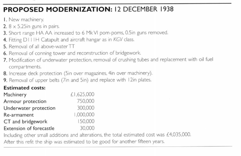

The RN wasn't afraid of full scale ship reconstructions before WW2. First in 1936 then in 38 plans were made to modernize the Nelson class battleships. Some plans included the replacement of the entire interior inclined belt with an external one, replacement of all secondary and AA guns with 5,25" ones (one plan proposed 4,5" ones) and another plan intended to rebuilt the entire tower bridge similar that was installed on HMS Warspite which then was used as a prototype for the KGV and Lion bridge structures.
Usual boiler refurbishment and electrical overhaul but the 1938 plans even provided with new engines increasing the shp to 70.000shp
These plans later re-risen during the war in 1943 when these ships needed serious overhaul, this time even US DP-AA guns considered (5"/38 Mark 12 or 5"/54 Mark 16 guns)

Echoing EwenS's post and notwithstanding the necessity of all of the things you've mentioned, I would have thought new propulsion machinery would have been the outstanding item at the top of that list. Think about it; despite several short periods in dock (including a 6-month stint in Portsmouth in the first half of '39) by '41 she hadn't had a major refit/reconstruction in the better part of a decade and had been in near constant service throughout the interbellum. Her boilers and turbines were tired and badly in need of replacement. By the time she was sunk she'd weathered further hard service, participating in several significant operations including Mers el Kibir, during which she stripped a turbine chasing down the Strasbourg.
My read on refit priorities/outcomes:
1. New propulsion machinery (reboilering - at a minimum - if not wholesale replacement with machinery intended for Vanguard or one of the Lion-Class)
2. Armour (reconfigured belt arrangements + up to 5" deck armour over vitals - in two layers if necessary). Alterations/additions to bulges/torpedo defence scheme as time/budget allows.
3/4. Armament: improved main battery aka Vanguard + new DP secondaries (like Hood i think 4.5" is more realistic) and close-range AA enabled by modern Main Battery Directors/rangefinders, HACS (MkVI) and radar
4. Rebuilt superstructure: (In an ideal world) new forward superstructure/bridge aka KGV-Class, reworked aft superstructure/foc'sle deck (mitigating issues with low freeboard around X-Turret) Aircraft carriage/launching of low priority, amidships arrangements/funnels/boat deck more akin to Vanguard.
OR...
Acknowledging that minimum work to get the ship back sooner is more likely once war is underway: rebuilt forward superstructure/foremast to minimum level necessary to enable armour changes and carriage of new directors/radars, new amidships superstructure/funnels over engine spaces + enabling structures for DP secondaries and AA, rear superstructure additions/alterations as necessary to fix wet quarter deck and accommodate old spotting tops Director/rangefinder as 'secondary'.

As R. A. Burt's book shows the most expensive stuff in proposed 1938 modernization was the Machinery: 1.625.000 pounds

I have a feeling that there is some fairly detailed information regarding Hoods proposed 'modernisation' in British Battleships of World War Two by Alan Raven and John Roberts, unfortunately LONG out of print now. I used to have a copy, but now no-more.
There is also some information in there regarding the proposed refits for Nelson and Rodney, but I think these are much less detailed as the proposals for them were still being discussed.
The attached is from Siegfied Breyers Battleships and Battlecruisers 1905-1970....Again I used to have a copy but it fell apart due to excessive use!
I did thankfully, manage to scan the whole book to PDF before it finally met its demise.
I have a copy so when I get time I'll look. I also have several monographs on the Hood that include proposed refits in them.

Raven and Robert's British Battleships of World War Two has the following to say about the modernisation of Hood.
In December 1938, it was proposed to reconstruct Hood on the following lines:
1. Provide new main and auxiliary machinery.
2. Replace the 5.5-inch and 4-inch gun armament by eight 5.25-inch gun mountings.
3. Increase the close-range armament to six pom-pom mountings, and remove all 0.5-inch machine-gun mountings.
4. Fit a cross-deck catapult DIIIH, aircraft and hangars arranged similar to that of the King George V class.
5. Remove the above-water torpedo tubes.
6. Remove the conning tower and reconstruct the bridges.
7. Remove the crushing tubes from the bulge protection and fit out buoyancy spaces as oil-fuel tanks
8. Rearrange the protection by removing the upper 5-inch belt, and improving the 2-inch splinter protection on the lower deck and either (a) extend the 12-inch armour belt to the upper-deck, increasing the thickness of the upper-deck to 2.5-inches over the machinery and 4-inches over the magazines, or; (b) leave the 12-inch and 7-inch belts as they were, and increase the thickness of the main-deck to 4-inches over the machinery and 5-inches over the magazines.
9. Modifying the shape of the upper bulge to improve stability.
In 1939, Hood's machinery was twenty years old and showing signs of wear. She needed reboilering and her turbines needed reblading. The likelihood of her being able to steam at high speed for any length of time - as would be required in war - was considered remote. Her displacement was too high, her stability too low and her horizontal protection needed strengthening. At a meeting of Sea Lords in March 1939, the First Sea Lord said: "If this ship is to last another fifteen years, which is probable, it is evident that the vessel will have to be laid up for large machinery repairs and it will be a matter of eternal regret afterwards that the big thing [complete reconstruction] was not done". The First Sea Lord then said that he would initiate action to have Hood taken in hand after Queen Elizabeth, for complete reconstruction including new machinery.
