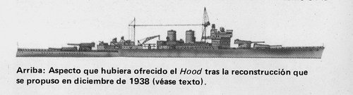

HMS Hood 1942 Large Repair
Grey Havoc
The path not taken.
Oct 9, 2009
11,134
1,421
http://www.hmshood.com/history/construct/repair42.htm
Some very interesting potential outcomes. The one based along the lines of the KGV class would have likely been very effective indeed.
CNH
CLEARANCE: Secret
Dec 5, 2010
424
358
Would it have been worth it?

DK Brown's Nelson to Vanguard offers a little more info on the Hood refit. Hood was scheduled to follow Queen Elizabeth in the rebuild programme.
Much as the article linked above, he states the features agreed in December 1938 were; new machinery, conning tower and torpedoes removed, eight twin 5.25in mounts and six 8-barrelled pom-poms added and a cross-deck catapult.
Brown notes that the rebuild would have been difficult due to the overloaded structure and high stresses. He argues trying to put the 5.25in trunks through the strength deck would have been a problem. Perhaps eventually a 4.5in battery would have been fitted?
The other major refit programme would have been Nelson and Rodney around 1940. Although the final scheme was not agreed before the war, in October 1938 the DNC was looking at new machinery, armour changes and a cross-deck catapult. It was planned to deepen the belt and armour the lower deck forward during their 1937-38 refits (£330,000 cost) but resources were not available. Nelson did later get 2.75-3in armour forward.
The three main schemes were:
Eight twin 5.25in, two eight-barrelled pom-poms and catapult on X turret
Ten twin 4.5in, two eight-barrelled pom-poms and catapult and hangars on the shelter deck
Six twin 5.25in, two eight-barrelled pom-poms and catapult on X turret

I get this image in the spanish language book "Guia Ilustrada de los Acorazados y Cruceros de Batalla" by John Jordan Editorial San Martin, Madrid 1986. The text talks about a reconstruction like Renown but with sixteen 133 mm guns and a urgent change of machines for a lighter one (Excuse me my bad english).
