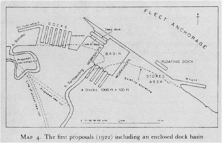

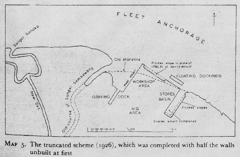

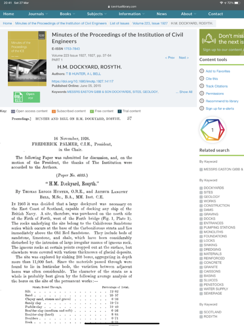

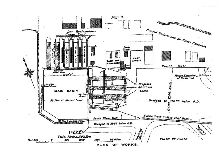

As regards Admiralty home dockyard ‘extension’ plans prior to WW2, I found this in one of my MANY miscellaneous folders which I have compiled over the years. The document this came from is a discussion about the planning and construction of Rosyth in 1926. I do not know the provenance of the discussion, but it looks as if it may have been some sort of architectural group. I have attached a reduced-size copy (the original is over 13Mb - apologies for its resulting poor quality) The document itself I have to confess, I find it somewhat odd if there were real proposals to extend Rosyth as at that time there were disagreements in Parliament regarding the plans for the construction of the Singapore base. I think it more likely that it was part of a version of the original ideas for Rosyth.
I also have a copy of the original Singapore plan, and the end result, from the Rise and Fall of the Singapore Naval Base 1919-1942 by W. David McIntyre.
