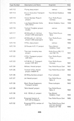

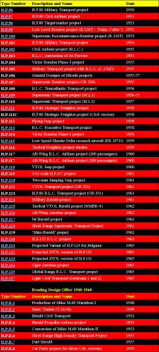

Just in case, here are the project lists (annoyingly, they are images).

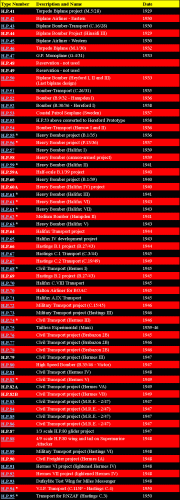

Thanks Paul! I came to the same realization after downloading the pages... Quite annoying, indeed!
I have now a complete list of Handley Page designations starting at the H.P.1 Bluebirdand going up to the H.P.137 Jetstream (plus the HPR.1 to HPR.8 series), except for the following:
  • H.P.48 (said to have been reserved and not used... but reserved for what?)
  • H.P.49 (said to have been reserved and not used... but reserved for what?)
  • H.P.121
  • H.P.136
Any help would be appreciated if you have even the slightest amount of information!

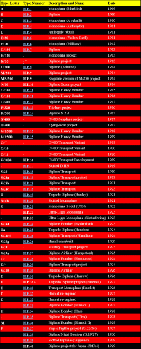

I've had my own go at the Handley Page designation systems. First up, the original letter system
___________________________________________________
Handley Page Letter Type Designations - 1910 Series
Frederick Handley Page's first original aircraft design was named 'Bluebird' but it was also assigned a type - Type A. This type letter system remained in place until 1924 (with its common use continuing for some time after Handley Page adopted a new H.P. numbered type system). In 1912, horsepower was added to distinguish between potential variants. The first in this style was the Type E which, with its 50 hp Gnome rotary, was also described as the Handley Page E/50.
All very logical ... but it didn't last. Handley Page's 1915 Type O 'bloody paralyser' bomber was designated O/100 for its 100-foot wingspan. The developed Type O became the O/400 - returning once again to horsepower for the model number. But, in the case of the O/400, this referred to the nominal power of only one of its two engines. [1] Perversely, the next Handley Page bomber - the V/1500 of 1918 - had a designation based upon the total combined power of all four of its engines.
After WWI, Handley Page began shortening designations. For example, a one-off transport derivative of the O/400 was the W/400, a designation soon contracted to W/4. The pattern was followed by the Type O airliner derivatives. A contemporary of the W/400 was the O/700 was later contracted to O/7. The O/10 and O/11 developments of 1920 seem to be original designation - ie: no 'O/1000' or 'O/1100'. But confusion had begun to set it.
Perhaps the '700' in O/700 referred to total horsepower? [2] However, there's no such 'wiggle room' for the O/10 or O/11 models ... which, initially at least, had the same engine power as the O/7. Developed versions of the W/4 were the W.8 series, in keeping with total engine power. But the reason for a change in designation style from slashes to periods for the W.8 series is unknown.
Perhaps weary of running out of sensible designation numbers, Handley Page began applied sub-type suffix letters. Each major sub-types - including unbuilt projects - were assigned a small letter suffice. [3] So, in the case of the W.8, the prototype was simply a W.8, followed by the unbuilt W.8a of 1919, the W.8b of 1921, and so on.
One trails aircraft - an Airco DH.9A rebuilt as a monoplane to test Handley Page slots - was given the designation X.4B. It is not clear if this refers to a 'Type X'. If it does, that '4' matches the power of the DH.9A's 400 hp Liberty 12-N engine. But what does that 'B' refer to? There was an earlier DH.9 biplane fitted with fixed Handley Page slots. Was that DH.9 given an 'X' designation with an 'A' suffix? [4] Even if it was, why the Capital letter suffixes? Perhaps a foreshadowing of what was to come?
I can find even less evidence of any 'Type Y' or 'Type Z'. Still, the problem for the Handley Page designation system was obvious. Even when using sub-type suffixes, Handley Page was running out of alphabet for Type letters.
The short-term result was the re-use of earlier letters in the early 1920s (next post). The longer-term result was a complete rationalizing of Handley Page designations using a new 'H.P.' numbering system (third post).
[1] Two planned 1917 derivatives - the Type S seaplane and the Type T flying boat - followed the new pattern as the S/400 and T/100.
[2] This would have been consistent with the designation style of the 1918 V/1500 bomber.
[3] Over time, popular rendering of those sub-types letters with Capitals became more common.

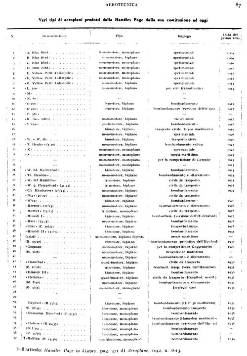

From, Rivista_aeronautica 1943.
