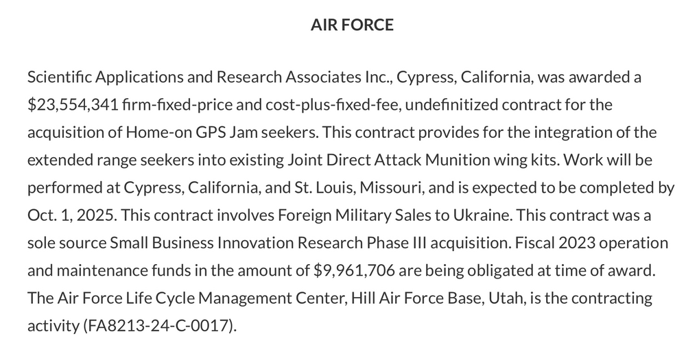

This is a very small contract that falls under “small business innovation.” Call me when there is $10 billion in funding and prime contractors involved.
Under normal circumstances, $10 million might buy the Pentagon a proof of concept. I suspect that this project might be a way of trying to generate something fieldable without compromising truly sensitive tech.
Best case scenario, $10 million might buy the Pentagon a proof of concept.
