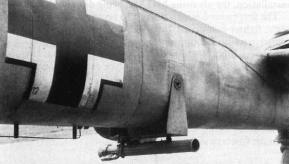

bf 110 with 1 EG RZ 65
Do you have more information about that installation, or maybe the source (please, always mention the source !) ?
It looks, as if the single RZ 65 rocket was fired laterally. What was the intention ?

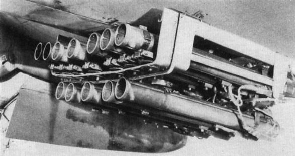

another picture:
Bf 110 V19 trial:
