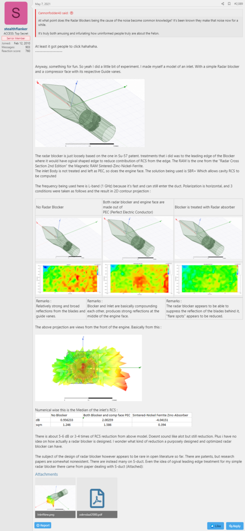

I think this great post by Stealthflanker should also be shared here
(no repost I hope, couldn't find it anywhere on this thread)

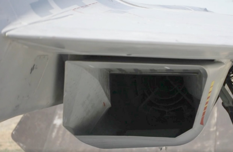

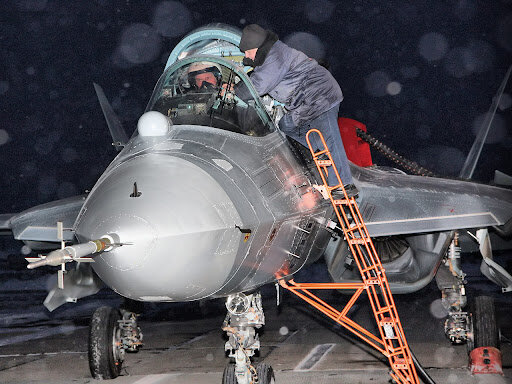

Su-57 intake 1 (without the patented blocker?): imgur.com/c72O4ir
Su-57 intake 2 (without the patented blocker?): s3.amazonaws.com/the-drive-staging/message-editor%2F1524527778030-su-57-fan.jpg
Su-57 radar blocker

Not sure if this was shared before but someone in cooperation with out fellow forum member StealthFlanker has created some nice articles regarding radar scattering simulations on some fighters. Most notably the F-35A, Su-57 and J-20.
As always we can debate the accuracy and utility of such simulations and measurements but I see them as fairly informative. Especially given that the measurement criteria and analysis is clear and consistent with what I know and have read. Certainly the best around thus far.
