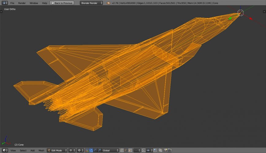

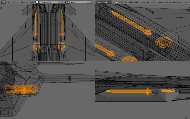

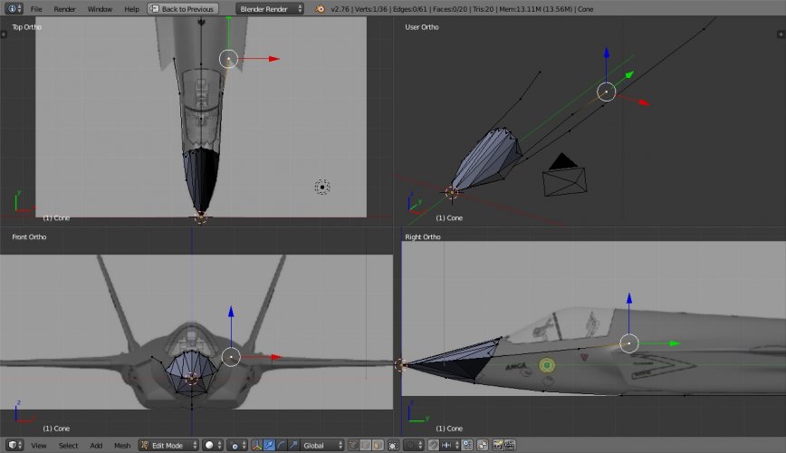

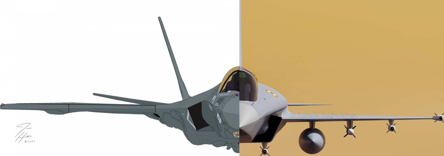

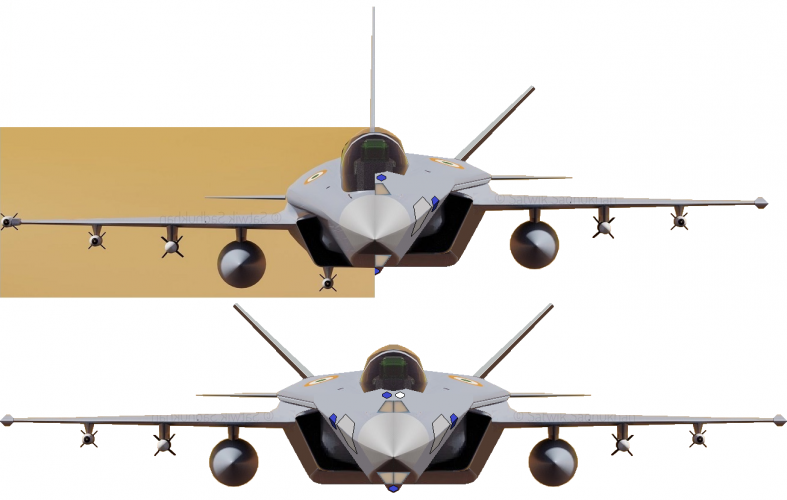

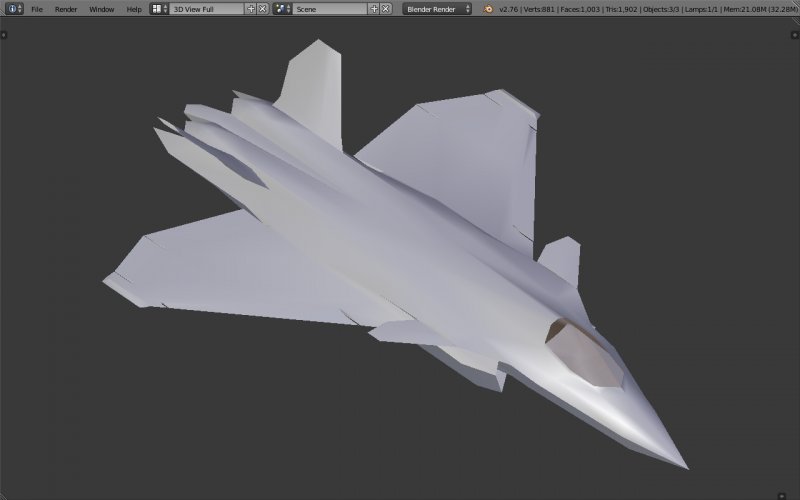

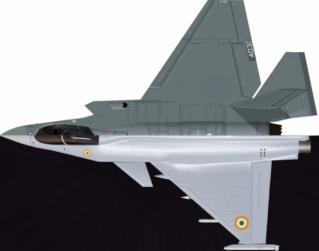

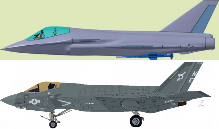

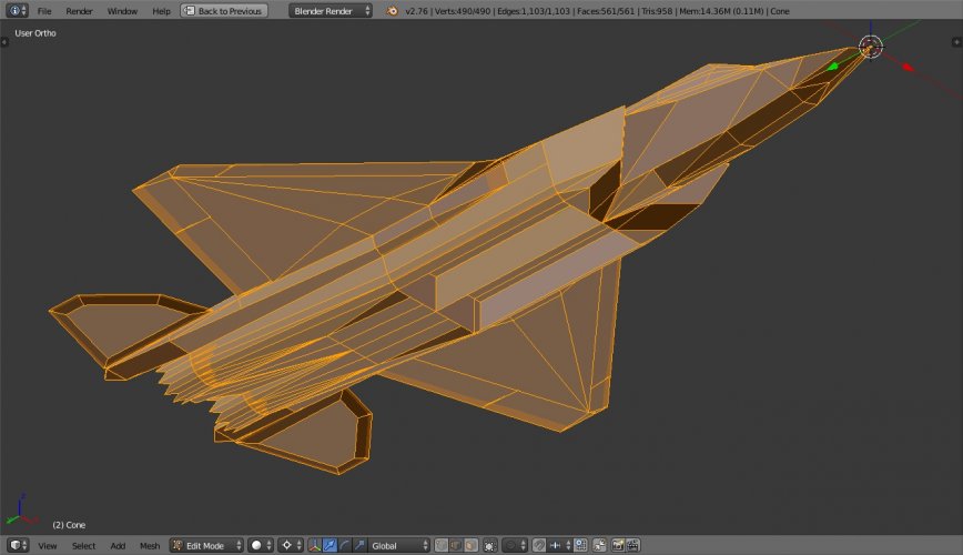

After adjusting pixels of available diagrams of TEDBF & AMCA to their dimensions & comparing, we found that their fuselage height is almost same; span & cross section area values are nearby, AMCA's belly spans more for IWB.
The overlay of AMCA's IWB outline shows that TEDBF can be tweaked towards 5gen (which i made last year but couldn’t show yet) or a cleansheet delta-canard jet.
But as AMCA is not made yet, let's see comparison with existing similar tandem bi-plane medium category naval jet design - F-35-C, matching the pixels with dimensions. This can help in understanding transitioning from STOBAR jet design to CATOBAR & explore a STOBAR stealth design.

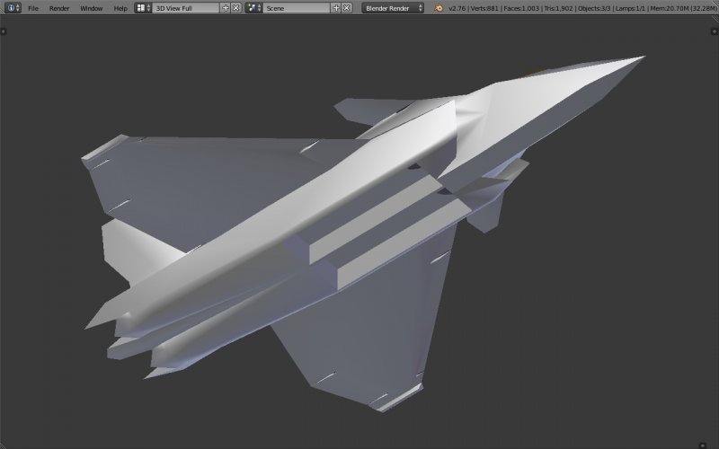

NOTE - This TEDBF 3D CAD is slightly different from official greyscale images not good resolution.
> From diagrams we can notice that -
- Like "Fat Amy", TEDBF looks chubby & voluminous too, but with smaller engines.
- height of both fuselages are near equal,
- From nose to exhaust, TEDBF seems to be longer,
- F-35's fuselage width & wingspan is more due to IWB,
- TEDBF nose is more tapered & drooped,
- F-35's canopy is already big. TEDBF's canopy is way too big.
- Rear half of F-35 packs cool stuff like cooling system, antennas, decoys, APU, counter-measures, etc. A 4gen jet may not have some of these things or not internally.

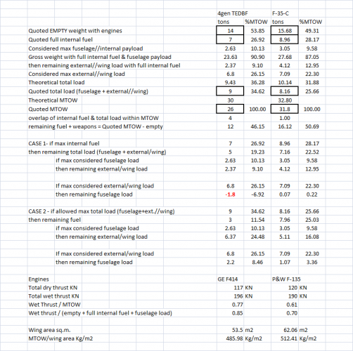

> Looking at numerical data -
- Total thrusts values look nearby,
- but empty, gross, max weights, IWB load, fuel of TEDBF less than F-35's, perhaps bcoz CATOBAR has the catapult assist not on STOBAR,
- hence the ATWR (A/c Thrust to Weight Ratio) of TEDBF is also more.
- Wing area of F-35-C is more, but its weights increase in bigger ratio, so wing loading is more.
More observations can be made.
> Take-off, gross weight, MTOW -
- Gross weight could be standard CAP config with certain fuel amount & minimum weapons. For my calculations i consider it as empty weight + full internal fuel + max fuselage load, analogous to a stealth jet.
- In peace time light AA, AG, mixed loads are taken, just enough for CAP, to deter aggressors. MTOW is a war time capability which pushes A/c structural limits.
- Common pattern in all fighter jets is observed that MTOW is roughly around or +/- of 2x empty weight.
- MiG-29-K empty weight is 12 tons, quoted MTOW is 24.5 tons. With 2x RD-33MK engine's 88.3 KN thrust, wet T/MTOW = 0.74
- Su-33 empty weight 18.4 tons, quoted MTOW 33 tons, < 2x empty weight. With 2x Al-31F3 engine's 125.5 KN thrust, wet T/MTOW = 0.78
- F-35-C empty weight 15.68 tons, quoted MTOW 31.8 tons. With 1x F135 engine's 190 KN thrust, wet T/MTOW = 0.61
- F-18-E empty weight 14.55 tons, quoted MTOW 29.93 tons, >2x empty weight. With 2x F414 engine's 117 KN thrust, wet T/MTOW = 0.67
- TEDBF empty weight 14 tons, quoted MTOW 26 tons, <2x empty weight, due to STOBAR perhaps. With 2x 414 engine's 117 KN thrust, wet T/MTOW = 0.77
- If aerial refuelling is available then T/o can be done with lesser fuel & more weapons.
- Rear/longer T/o position is suitable for heavier load configs.

> Pattern noticed is that -
- While CATOBAR jets with catapult assist have ATWR range in 0.6X, or relatively more weight, less thrust.
- STOBAR jets need more ATWR in range of 0.7X, or more thrust, less weight.
- To tweak TEDBF into 5+G design this ATWR range & CLW range will have to be maintained.
