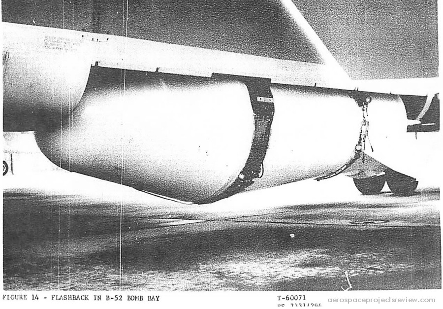

Well, I'll be dipped. Looky here what we done built:
More images and data and blathering here:
http://www.aerospaceprojectsreview.com/blog/?p=3266
I wonder what warhead package that was supposed to use. Given that we already had the 25 Mt B41 available I wonder what the yield of this thing would have been.
If it is what it certainly looks like, it's probably the end result of the desire for a 50 to 100 megaton lay-down weapon.Prior to this, though, that concept only seemed to be some hand waving in some memos, so... who knows.

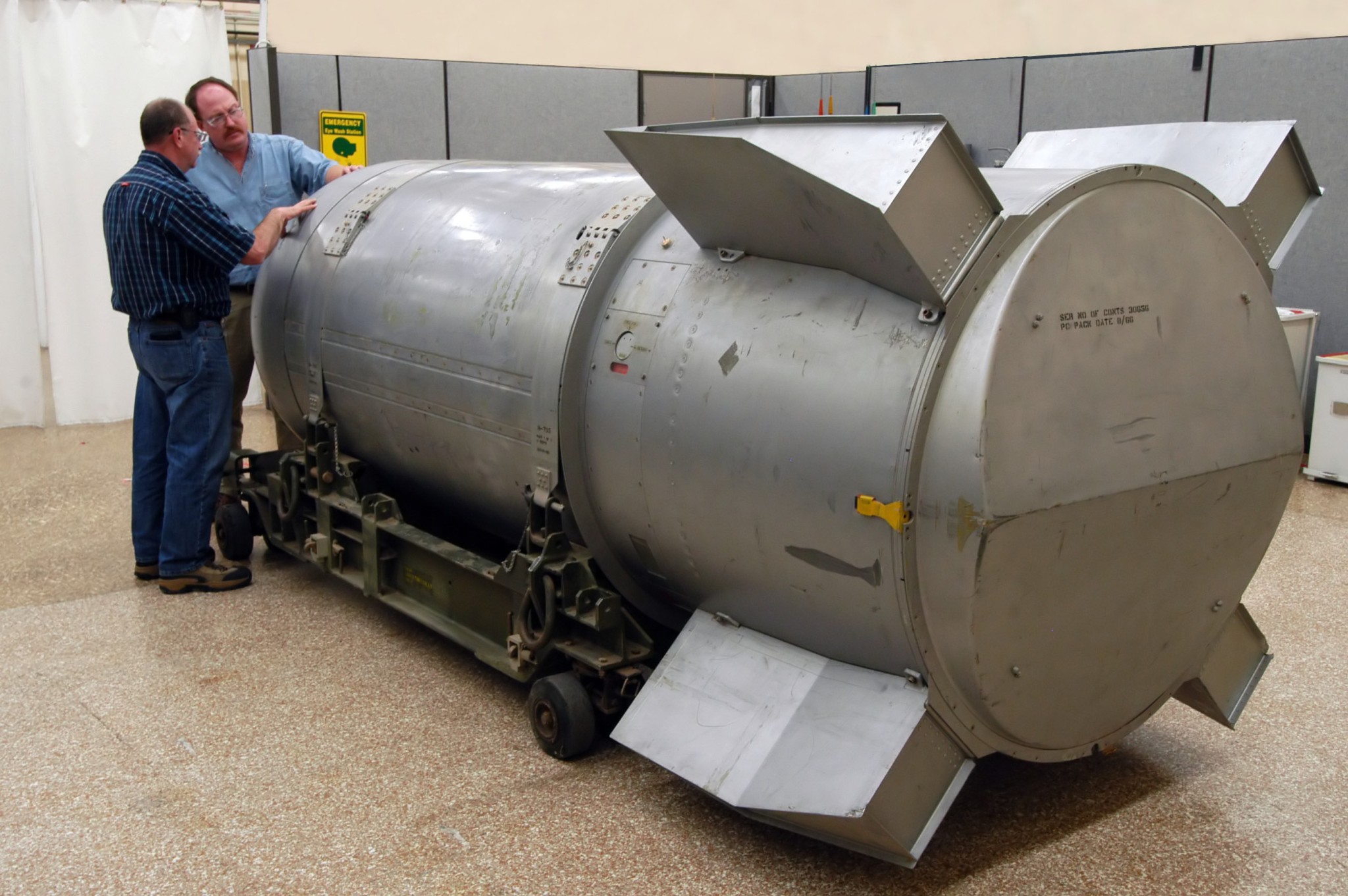

Unlikely. Just about *all* the fat, tubby H-bombs used wedge fins, such as thr B53 (the freefall, aircraft-dropped bomb that used the same "physics package" as the W53 warhead within the Titan II RV):
Such fins were common on the "fat" H-bombs that were exceedingly draggy, meant to be carried withing the bomb bay of a giant aircraft like the B-36 or B-52. When smaller aircraft started externally carrying smaller, sleeker H-bombs like the B61, those bombs were given low drag thin fins.

I've received confirmation: Flashback was indeed a test article for a 50 to 100 megaton can of nukular whoopass.

This is just an observation of the photo above. I can see the main toggle strap around the middle, but I can also see a 'come-along' holding the rear end up. The brackets the come-along is attached to look temporary which would suggest to me the front end of the bomb is empty --- would what's shown just be a trial fit-up of the bomb shape to the aircraft.
